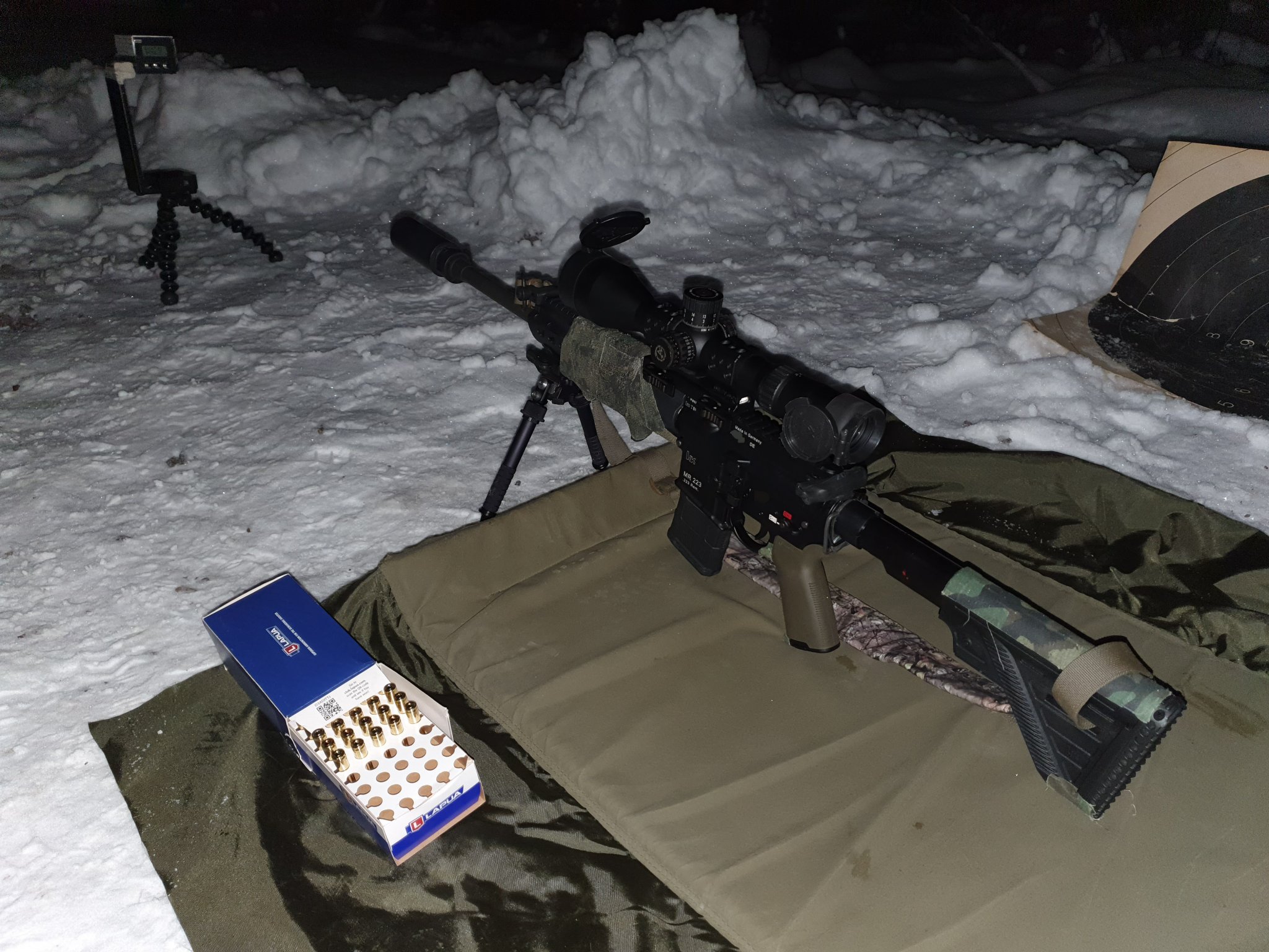

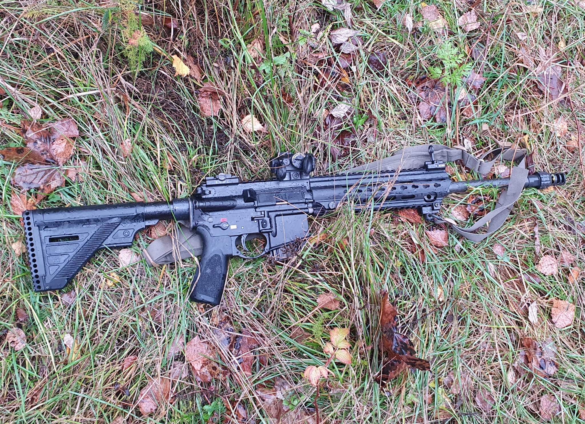

    My final MR223 layout is:
    -Ferro concepts slingster
    -Aimpoint T2 - I am considering NXS or Kahles LPVO for it also, maybe covering expenses by selling the T2.
    -Ase Utra muzzle break
    -Ase Utra SL5i suppressor - is attached onto the muzzle break
    -HK adjustable gas port - the older version. I enlarged one hole on the hand guard with a diamond file to adjust it with the hex key without any disassembly of the handguard. The hex key is stored in the receiver extension by few small magnets.
    -Magpul MOE+ grip - HK grip was good but I wanted more friction, it got a bit slippery in the rain at least with bare hands
    -Magpul XTM and some camo self grip band on it to soften the gripping surface on the handguard and help keep frostbites off.
    For ammo testing I loaned an Atlas PSR bipod and an Athlon Cronus scope from my rimfire.

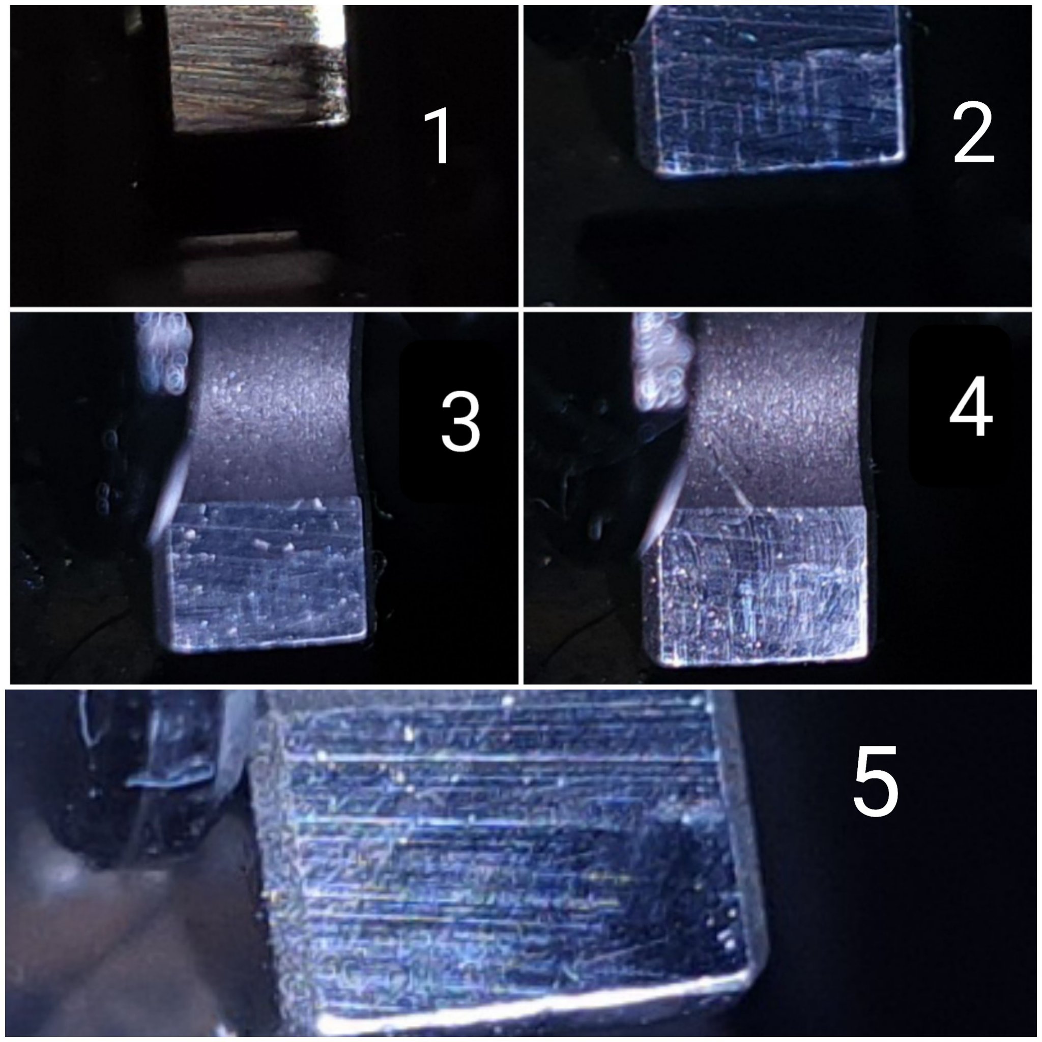

    Main grasp was the trigger. I have mainly used BnA, Sako and Anschutz triggers on rifles.. as new it was not up to spec for me. It however got tremendously better with use compared to when I first got the rifle.
    I can explain how it first felt like:
    You start pulling. The slack is easily removed, with just a hair of it. Then comes the pull itself. You keep on pulling, and can feel the sear working it's way. You continue to pull it, but it does not break until too late to the pull.
    This caused the trigger break to be VERY hard to estimate, although the break was crisp. I even thought of buying a german UHL match trigger but I decided to not change it before trying few tricks.
    I did get the trigger improved to a start with the paracord trick:
    You can see that the right side of the sear wore out to a shiny state. I had to make few attempts to get an image of it, it is very close to mirror polish now. I expect the rest of the sear will follow it with time..
    3/2/2021 Trigger is very smooth now, still breaks clean and is very nice to use. Hammering good groups is even easier now.

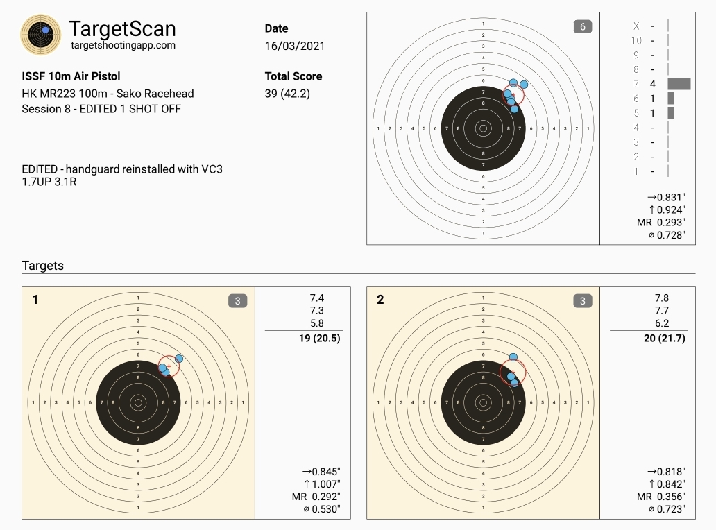

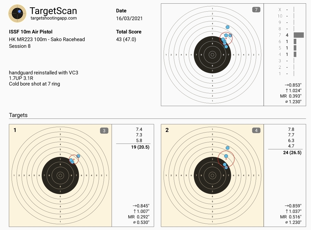

    I did 2 groups at 100m on dirt.
    3 shots including cold bore and another 3 shots on the second target.
    But I pulled one shot on the 2nd group and shot 1 more to correct it. I was talking to my buddy while shooting and just went oblivious.
    1st group 0.48moa
    2nd group 0.62moa (with the pulled shot group was 1.07moa)
    Both clean and pulled groups combined below. I know the concept of calling shots but I prefer to keep all data, as I want to see the full history. In this case I show both for transparency.
    Pulled shot (12 o'clock, 4 ring), 7 shots 1.07moa
    Clean shots, 6 shots 0.64moa

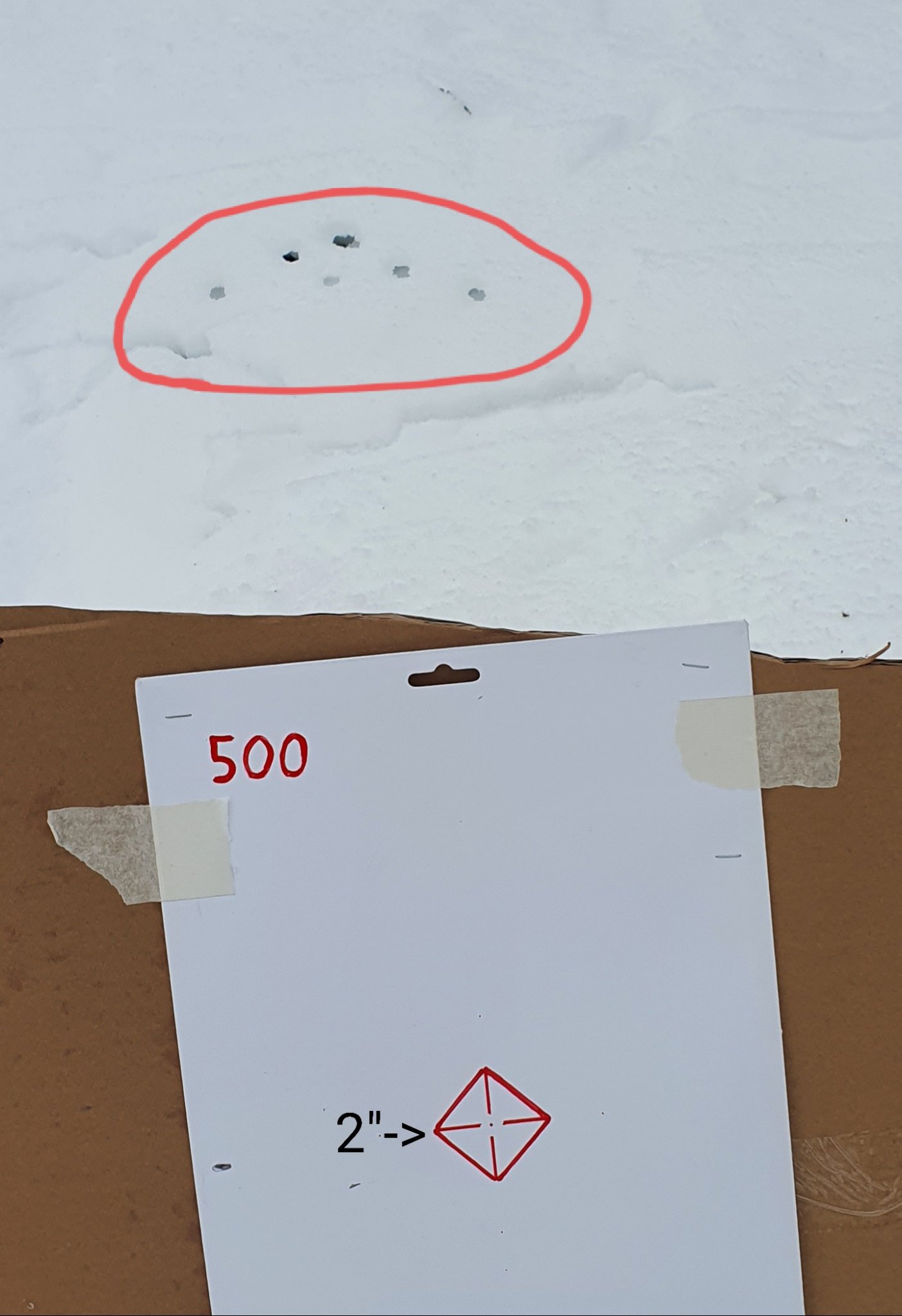

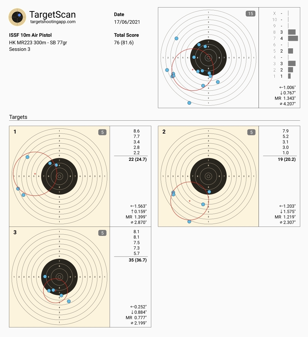

    I have gotten even better at shooting this rifle. Last 200 to 300 match rounds at mainly 300m have gotten me a lot of improvement.
    Using SB 77gr I shot this rifle at over 500m in difficult wind conditions (10-11 clock 2-7mph near shooting position and 3-4 o'clock 0-6+mph wind at downrange) and gotten first round hits to 600 or so at 18" targets.
    I could not hit the 1.1km target, the wind was changing too rapidly. The elevation was very steady though. At 800-900 meters getting hits became very hard.
    At the 1.1km target I had to hold 5.5 to 7mil wind.
    Here are the latest paper targets from getting zeroed in for the longer range shooting:
    This was shot on concrete, with a bipod and without a rear bag.
    Between the second and third group I even ran out of ammo and ran to car and back to shoot 5 more. It seems this rifle is probably more accurate than I am.
    Whole group, 15 shots: 1.2moa
    10 last shots (grp 2 and 3): 0.85moa
    1 group: 0.84moa
    2 grp: 0.68moa
    3 grp: 0.64moa

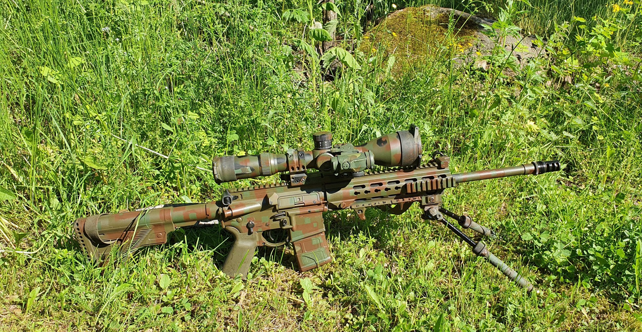

    It could also be that the improved accuracy came from the paint job I did on it:
