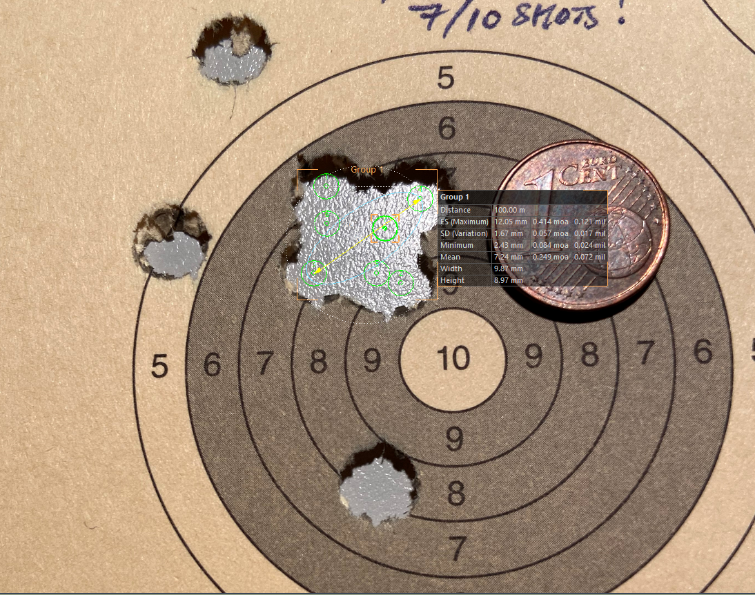

Shooting the EU version MR308 with 16,5" barrel for some time now. H&K guarantees 1,5 moa results for a 10 shot group with decent factory ammo. With handloads so far I reached 0.62 moa results at 100m ranges, but I think I am a terrible shot. It does seem to like 167/168 grain hpbt bullets a lot like the Sierra Matchking and Lapua Scenar. For chuckles; I miscalculated the bullet seating depth of the Scenar 167 grain and ended up with a COAL of 2,736" (quite short), but for some reasons it resulted in one of my best 10 shot group so far.
This is my more recent group with my friends MR308. 43gr of N150 with Scenar 167.
Shot in the dark using flashlight, was just supposed to check his MV and also zero.
9 shots, I first shot only 7 rounds but then shot 2 more.
I really think that in daylight and better conditions (was 10F) I could do 2/3 of that.

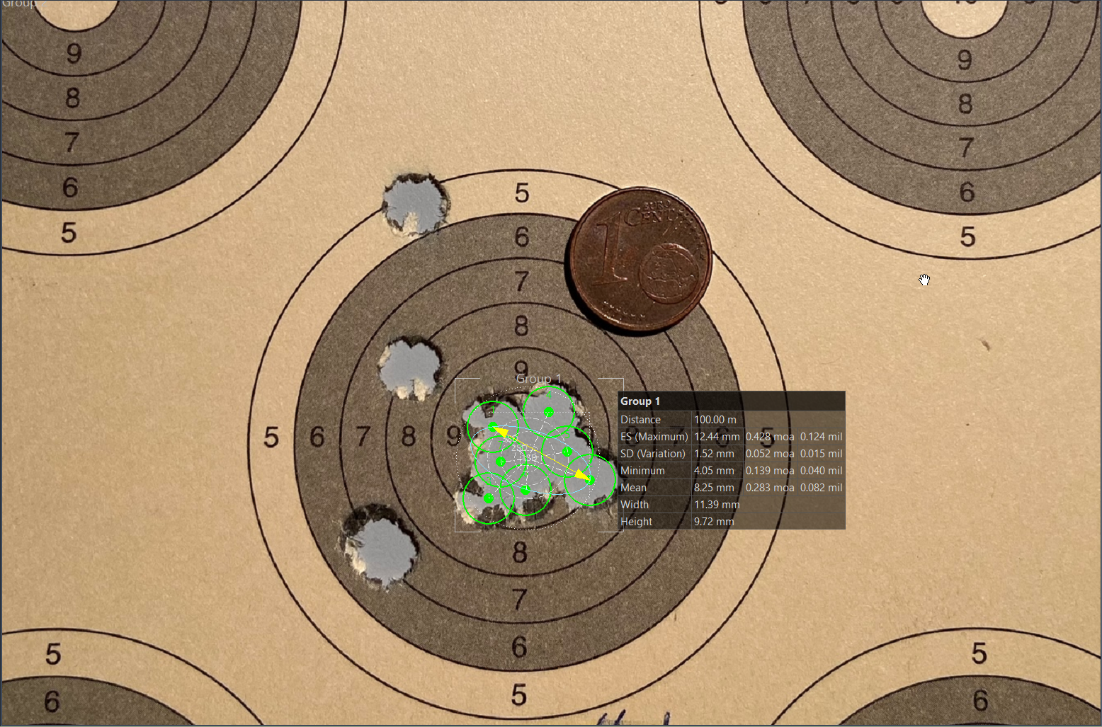

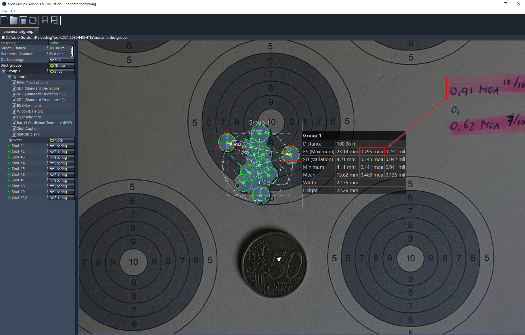

Discovered this Gordon's Reloading Tool yesterday and found an interesting MOA calculating function. What would be considered the MOA value for this 10 shot group ? The Extreme Spread ? The Mean ?
  • 2022-03-23 20_08_18-Shot Groups, Analysis & Evaluation - [noname.shotgroup].png

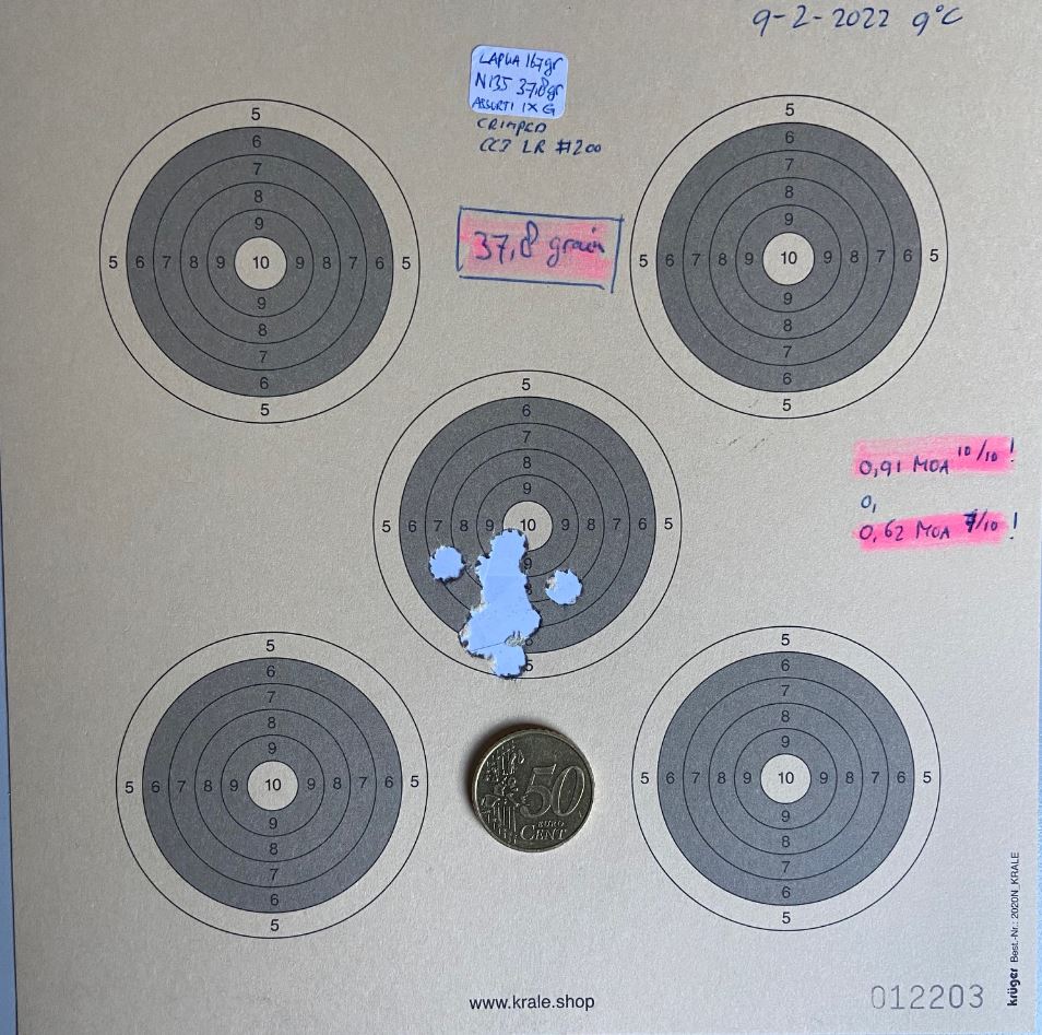

Found a new handload recipe for which I will use as my default load. I was frustrated for a long time to see quite some vertical stringing with various other powder loads, but this one seems stable. I doubt I can improve any further on my H&K MR308 16,5" semi auto.
Usually I fumble up 3... 4 shots out of 10. The ones I don't mess up group really tight. I am pretty happy with the potential of this new load.
Lapua Scenar 167 grain (GB422).
Vihta Vuori N135 38,60 grain.
CCI LR #200 primers.
RWS or Lapua .308 Win brass.
COAL approx 71,8 mm (jump +0,024" of lands).
Muzzle velocity around 700 m/s for my 16,5" barrel.

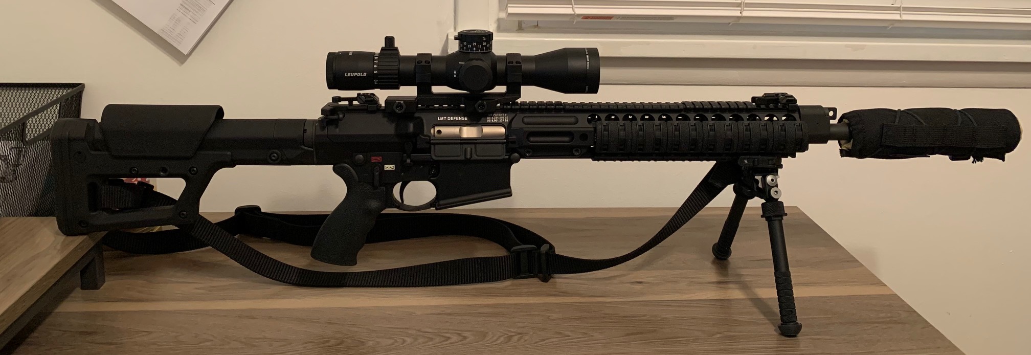

I picked up this MR762-A1 earlier this year. It's been cut down to 14.5". I use it for Ariel pig shooting hence the Aimpoint CompM5s.
My only complaint is it's heavy (compared to a similar sized 308 gasser) and the trigger sucks.

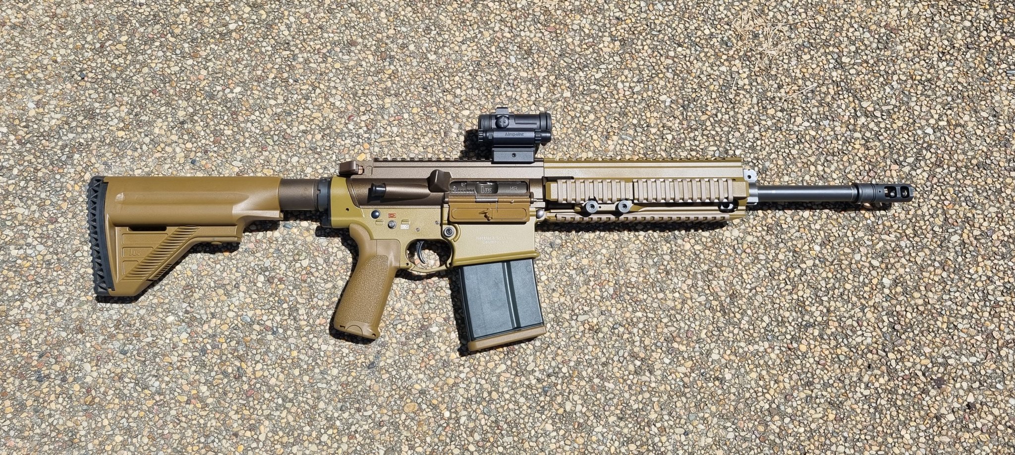

When it comes to loving my MR762 I'm going WHOLE HOG.
Here's the rail sections at the rear of the M-Lok forend w/an additional QD point, and some M-Lok grip liners I've got @3-6-9 o'clock which give me a more comfortable grip.
Still have to get the Gamma muzzle brake and Hex key bolts for the forend from HK parts.
