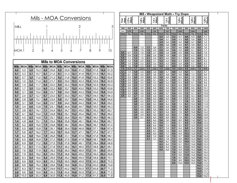

Not sure what you're asking??? MRAD and MOA are both angular measurements, try to stay away from linear measurement comparisons, for example it is a misnomer to think that MRAD = cm and MOA = inches, you're just asking for a world of hurt in doing so. That being said, 1 MRAD translates to 36" at 1000 yards, 18" at 500 yards, 3.6" at 100 yards, because MRAD reticles and turrets are typically divided by 10, so you have .1, .2, .3 etc. which means .1 (point one) mrad at 1000 yards = 3.6", 500 y = 1.8" and 100 y = .36". MOA has similar divisions, at 1000 yards 1 MOA translates to 10.47", at 100 yards it is 1.047" which many round to say 1" at 100 yards, but this is wrong and can lead to misses in long range shooting if you go by "inches" instead of actual MOA values. Both MRAD and MOA are just as accurate, they are just different units of measure but don't confuse them with linear units of measure. Personally, you should stick with MRAD and learn the system.

Use the chart on the left... or just embrace mil and go with it

Have a Vortex Viper 4X16X44 calibrated in mrads. Is there a SIMPLE rule for inch conversion? Can this scope be converted to moa?
Many, thanks
Question 1, forget inches. There is no need for inches.
Question 2, no it's in mils. Run data in mils and dial on or hold it. Done.
