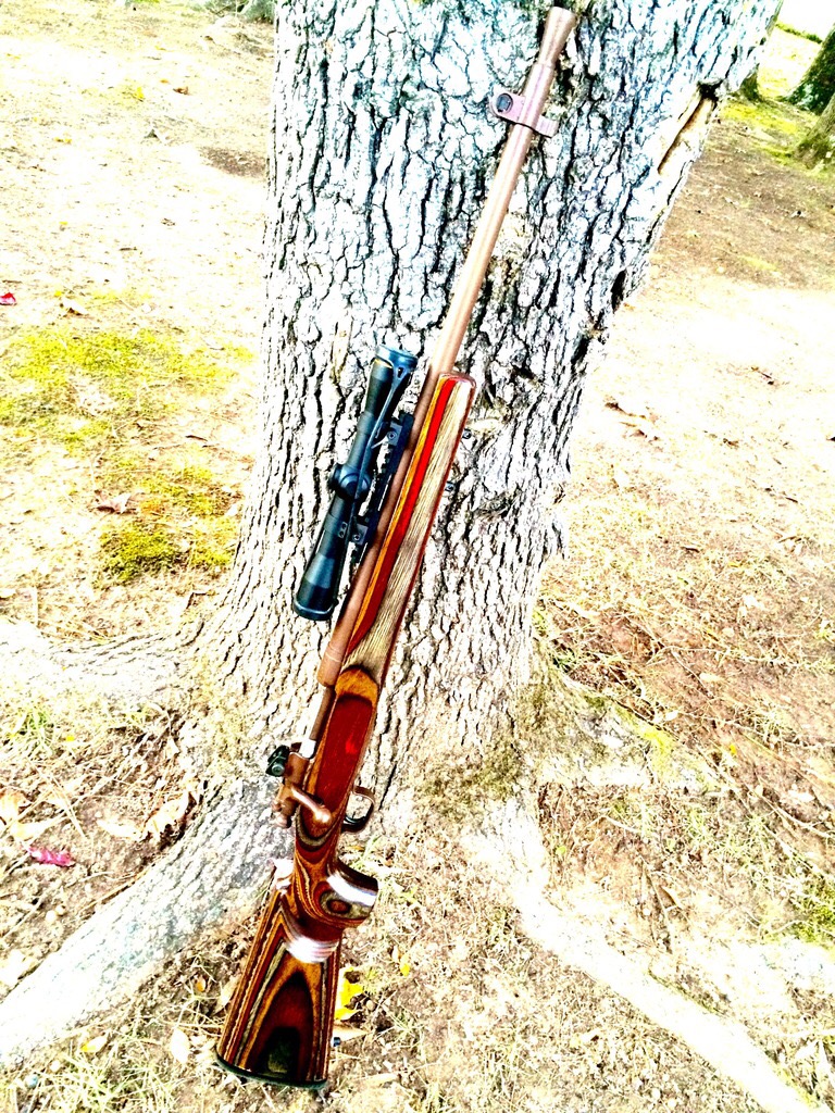

For what its worth, I did build said rifle off an 03a3 action. Rifle build was a fail. Didn’t do anything well, the smith I used was not the most proficient either. Would have been better with more careful consideration to weight, probably would have been a solid rifle, but I failed to pay attention to the weight of the selected components.
For what its worth, if I had to do it over again I’d just get a T3x/Bighorn Origin, prefit light to medium 16.5” barrel, simple 1-4/6 optic. .308., CTR or MCS EH1 stock. Live and learn I suppose.
