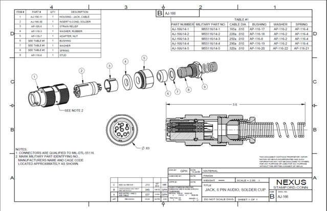

Okay, lets see...MilSpec for the plug is: M55116/14-X ("X" being the size of the diameter of the cable of 5 or 6 wires).
BTW, your tech will have to figure out the pin out on the boom mike/PTT cord (manufacturer may offer a pin out, if you e-mail them your situation).

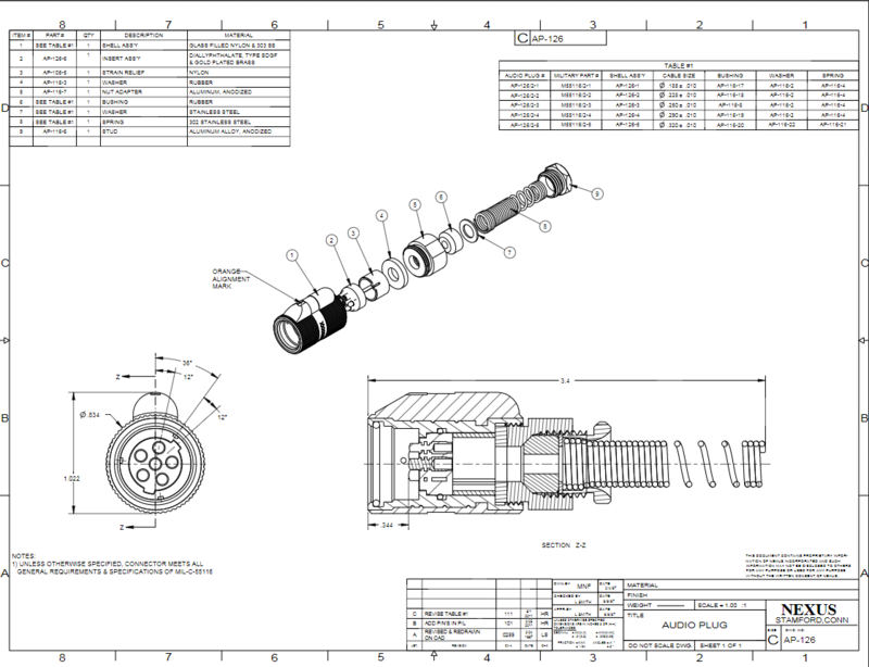

Let's see if I can upload/attach a pdf of the audio connector. These are water proof (but not submersible) and standard for military coms gear (except for some of the stuff the SOCOM teams use, who have their own submersible water proof connectors).
Hmmm...seems PDF's are verboten (not surprising). Let me screen capture it and attach it. M55166-14-x.PNG
NOTE: This schematic is for the female connector (you'll need the male connector)

scullti Yes, there are PTT assemblies made to go with the boom mikes for MSA Sordin headsets. This will allow a user to hear the radio broadcasts in the MSA/Sordin headphones and then, when the PTT assembly is keyed, speak through the boom mike into the radio. It's just a matter of mapping the pin out from the PTT assemby to the 6 pin audio connector that will then connect directly to the radio. This negates the need for the H-250 handset (or H-189 if they are even still around). It's by no means cheap, but yes, it can be done. Radios are radios, and they all have the same basic function, it's just a matter of getting the wires mapped correctly to the plug. Everything else is just a (normal) function of the radio. Remember, the Sordin isn't receiving the radio signals, just the output of the radio.
To be clear, the devices should connect in this order:
Sordin/MSA => MSA/Sordin Boom Mike => MSA/Sordin compatable PTT Assembly => M55116 connector => PRC-68 (or similar) radio.
