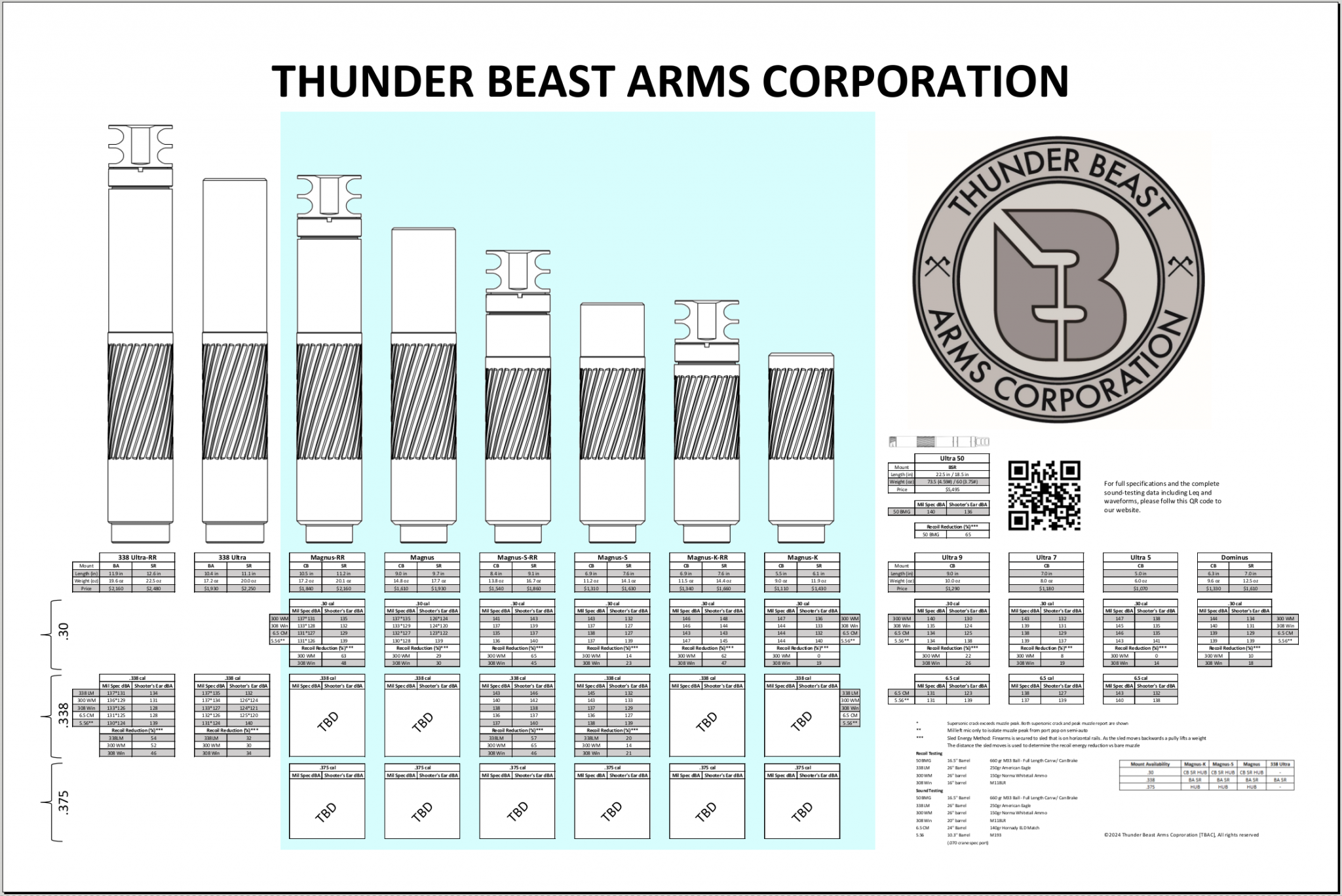

Thunderbeast is now taking pre-orders on the new expanded Magnus series... You can get a Magnus or Magnus-S .338 and that would be perfect for your needs. A TBAC .338 Ultra Gen2 is a bit of a monster to run on a .223 AR, and most of the bigger multi-caliber cans that will do like .46 caliber and smaller don't suppress worth a shit..."A jack of all trades, but master of none" type of deal. If I were in your shoes, I'd order a new Magnus .338 or a Magnus-S .338, if you want a shorter can for hunting and AR use.
