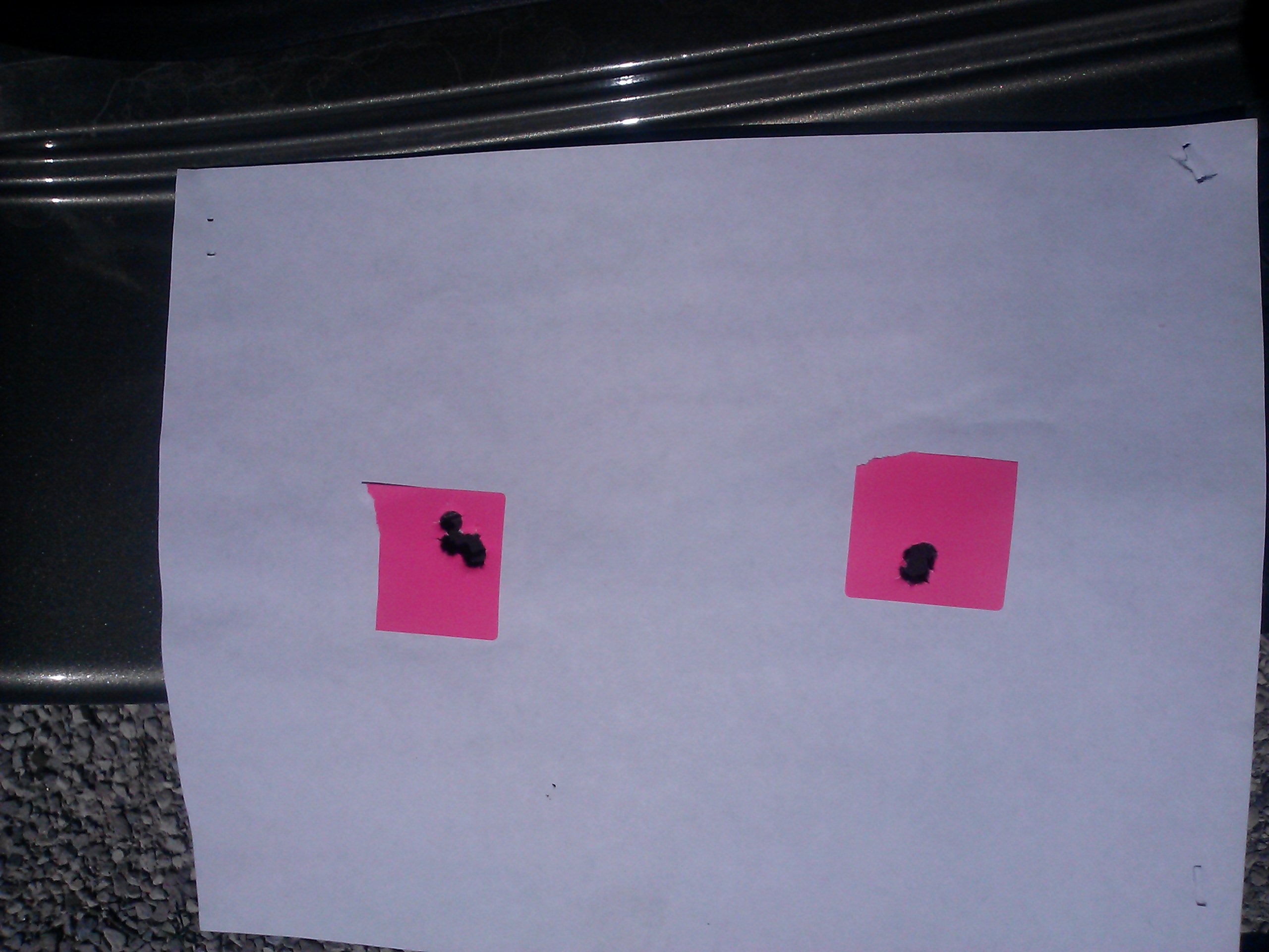

Can't give you any info on the Saker but I don't know how much more accurate you can get than the TBAC. Here are two 5 shot groups @ 100 yards. The one on the left was the first 5 after cleaning the bore. The right was the next 5. Rifle is a Rem 700 in an AICS 6.5X47L.
I have 3 Thunder beast cans, couldn't be better.
