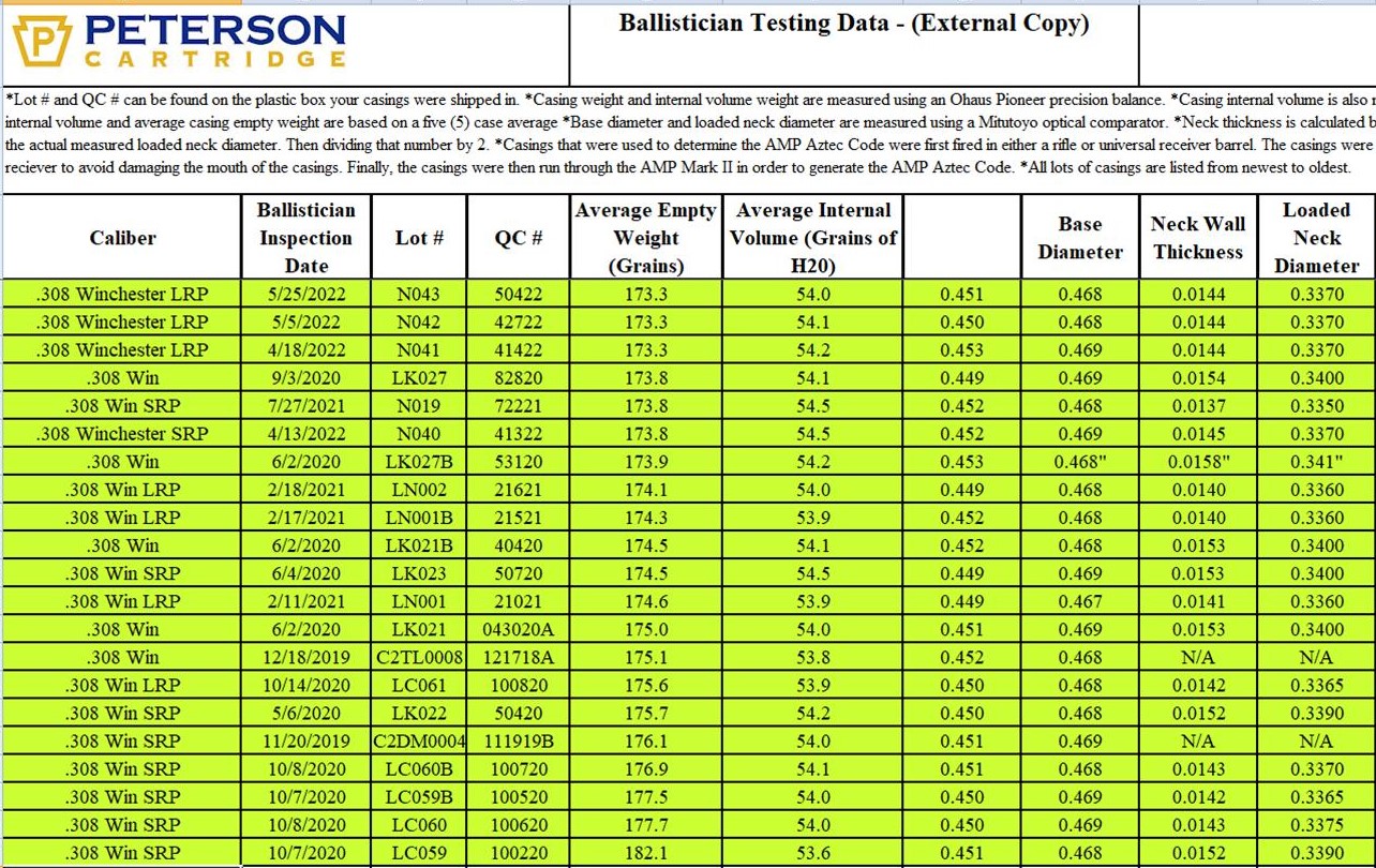

Sorry . . . to say that "there is no real correlation between brass weight and internal capacity" just isn't exactly true. Compare a batch of heavy brass and for the most part you'll find in general and most often find they'll have less volume than a batch of the lighter brass. BUT. . . it doesn't always hold true as you can see this in some data from Peterson Cartridge Company. The case weight for Winchester brass compared to the weight of ADG or Alpha brass, there's a definite correlation for their difference in internal volumes.
The best thing to do is to measure a sample of the particular lot of a head stamp to see just what volume you're really dealing with. :giggle:

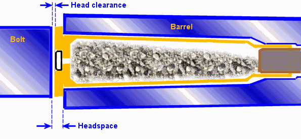

but I’m already seeing primers pretty flat at 38.5 of 4064 with 147 grn pills.
That may actually be a "false-flattened" primer due to excessive sizing of the case. The case is smaller than the chamber and as it's fired the primer gets squished as the case stretches.
Excessive sizing also promotes early case head failure/rupture as the brass thins.
