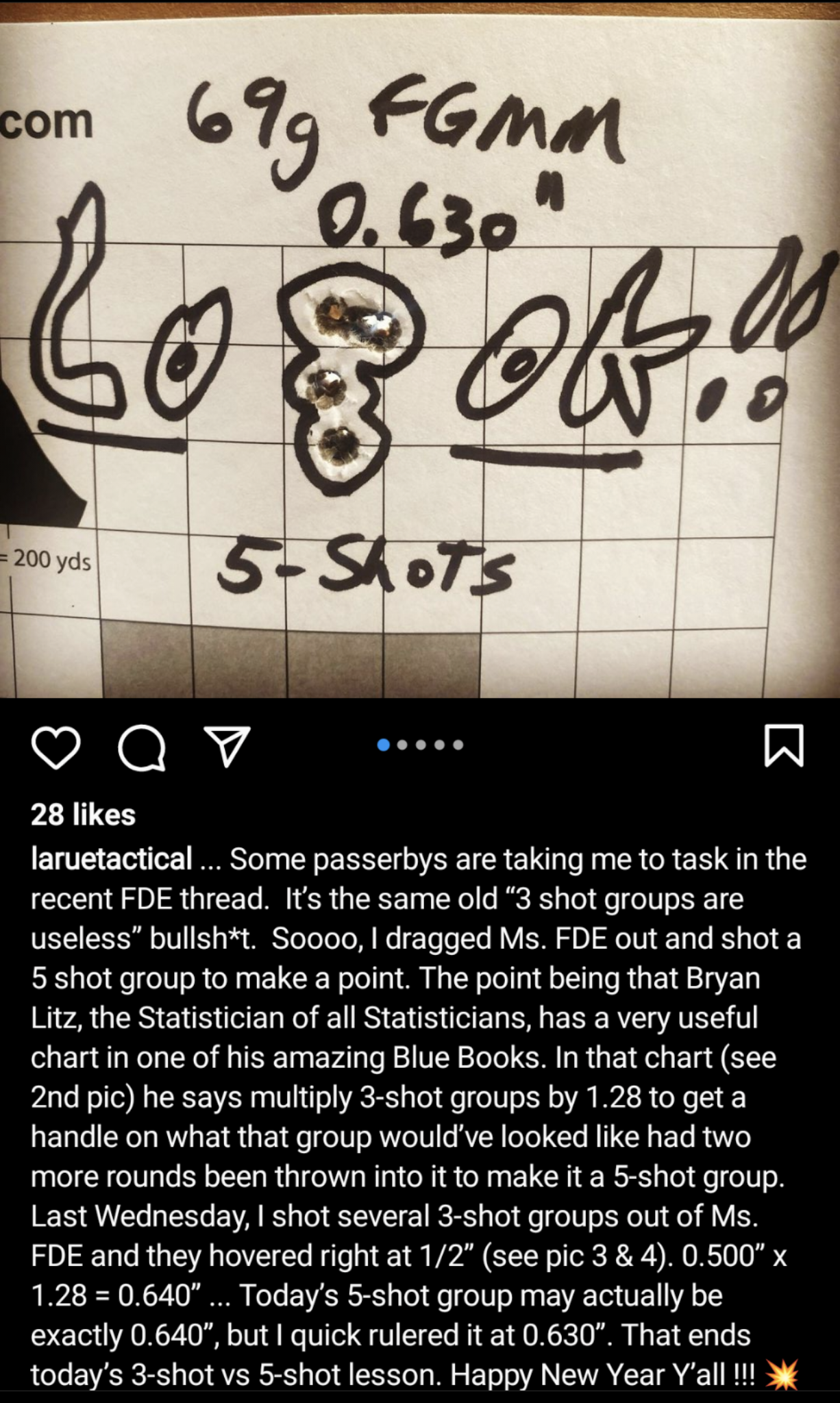

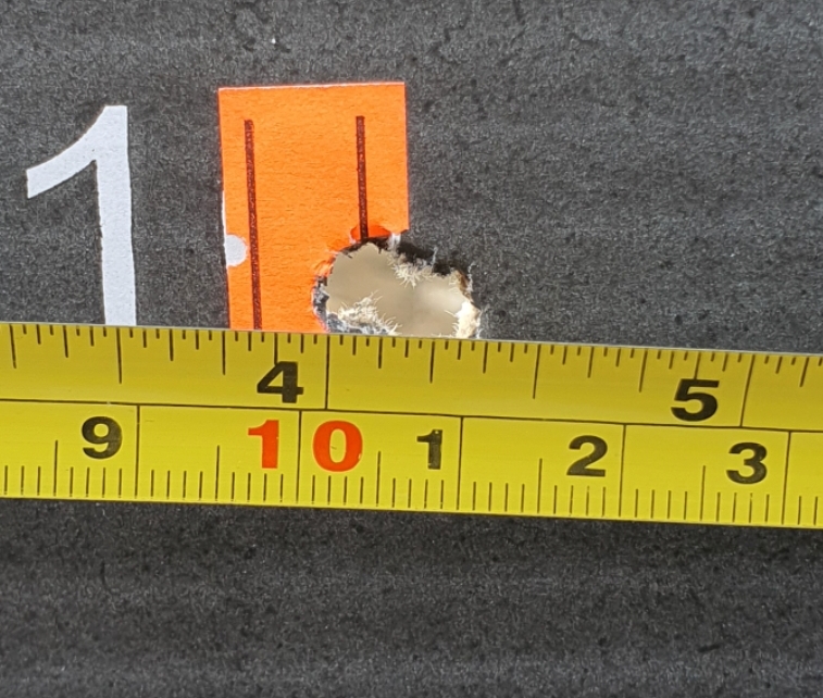

I saw this on LaRue's Instagram and thought it was interesting.
If this simple math equation worked, then 1.28 x any 3 shots from a 5 shot group should deliver the same result. It is obvious that is not the case, and the math falls apart on first principles.

From a statistical perspective, you are 100% correct. Turning a rule of thumb approximation into a statistical probability is ignoring mathematical norms.
If saving $1 per group is something one needs, they have chosen the wrong hobby. Shoot 5 shot groups, or 4, or 8 or 10 and use real data is a much better path than mental masturbation over group size relevancy.
What this "rule" really means if you took an infinite number of 3 shot groups from a perfect shooter (like a bench vise or something) measured them, and then added 2 more shots to each group the average difference between the 3-shot and 5-shot group would be a factor of 1.28.
However, if you looked at an individual group it could probably be anything from a factor of 1 (the second shots where within the first 3) to infinity (I'm shooting and I shot the wrong direction). Its the AVERAGE that 1.28.
So to be truly valid, this single example should be repeated (or in English Larue got lucky)
