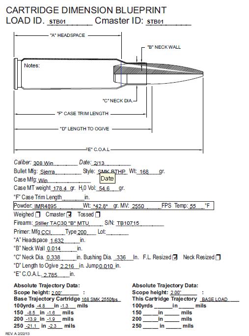

Here this will help you keep track of all the parameters that affect the accuracy of the load and the dimension that are critical to your rifle.
You can down load the zip file with PDF's and fill it in on the computer and save each under a diff name.
Chamber dimension map
Cartridge dimension map
Ammo Box lables.
  • Generic reload label.zip
