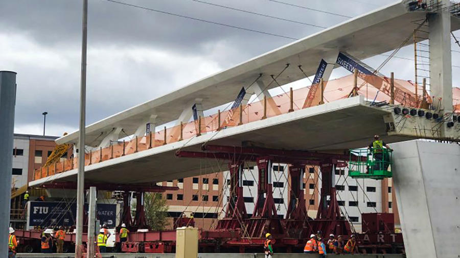

The funny thing on that job is that it was, in fact, set up like an assault bridge! Built on-site (campus land) near the road and pivoted onto concrete pylons over the weekend. All set up to be pre-fab and fast to put up! They should have just bought an old Bailey!

From the Article/Press Release on the opening of the bridge:
The 174-foot, 950-ton section of the bridge was built adjacent to Southwest Eight Street using Accelerated Bridge Construction (ABC) methods, which are being advanced at FIU’s Accelerated Bridge Construction University Transportation Center (ABC-UTC). This method of construction reduces potential risks to workers, commuters and pedestrians and minimizes traffic interruptions. The main span of the FIU-Sweetwater UniversityCity Bridge was installed in a few hours with limited disruption to traffic over this weekend.
“This project is an outstanding example of the ABC method,” said chair of FIU’s Civil & Environmental Engineering Department and director of FIU’s ABC-UTC Atorod Azizinamini, who is one of the world’s leading experts on Accelerated Bridge Construction. “Building the major element of the bridge – its main span superstructure – outside of the traveled way and away from busy Eighth Street is a milestone.”

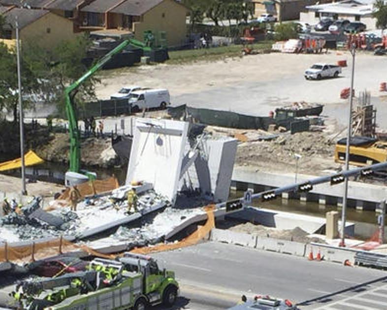

That bridge is not far from me. Traffic is going to be effed up big time. That is a major east west artery. Traffic sucks on that road when everything is good.
At first glance my thought was post-tensioning failed. That or shitty concrete like the afore mentioned.
Both things could be true. The shitty concrete could have failed at where the the tension cable stays are embedded in the concrete. The cables would be pre tensioned on the side of road and post or re-tensioned after placement. They said they were stress testing the bridge at failure so this seems logical. They were testing and tensioning as needed. Just a guess.
So it ain't wasn't no suspension-type bridge but then there ain't wasn't no spars underneath. What exactly then holds held up the middle?
The tension cables in the slab and overhead cover. They tighten and force the concrete into compression. Concrete is extremely strong in compression. The cables likely put the bridge in a slight upward arc causing weight applied to the bridge to force the concrete into even more compression. Concrete has little or no tensile strenght on its own. But the tension cables force it into compression.

So story now is the the bridge was undergoing a stress test and final cable tightening. Great i am all for that. Why the hell were the lanes open then.
