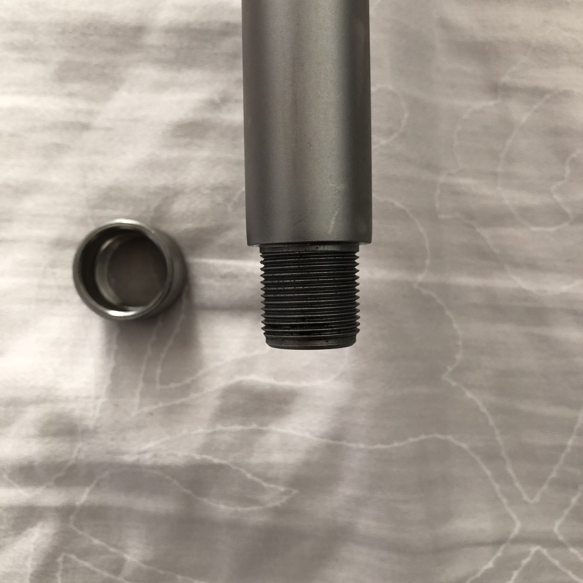

Tikka CTR.
Unthreaded the cap protector to install the TBAC break, and found this when I slid the crush washers over the threads:
Surely this small diameter of unthreaded barrel is an abnormality, yes? I can't imagine the crush washers will seat against this and do me any good.
Or maybe this is normal and I'm out of the loop on muzzle threading specs.
Thanks @Zak Smith .
And thanks a lot Tikka. Is this a "oops" on their part? Or normal, every CTR is like this?
Sounds like a good excuse to go get 2 inches chopped off and re-threaded by someone competent.
Thanks @Zak Smith. Happy to find this now, while I still have 4-6 months of wait time before the Ultra 7 is out of jail. I'll either get the root touched up, or just re-cut the barrel. Its a 6.5 at 20inches, and I wouldn't mind making this a shorty 6.5

You don't have to cut anything off that barrel, Just have a machinist trim the unthreaded portion down to the root diameter of the threads. Most lathes will take this and if needed use a 4 jaw chuck to center up the bbl to perfection with small leather strips to avoid marring the barrel. Worst comes to worst, you may have to remove the trigger and even the action to achieve some semblance of balance out of the thing.

You could time it by just cutting the relief and facing the shoulder. If you didn't want to lose length.
I’m just getting around to ordering some cans. So I haven’t looked into anything yet. I’ve been very tempted to replace the barrel after seeing Frank’s results with the tac a1. I opted for the 20” so I should gain a ton if I go that route.
I am a machinist, and it is impossible to thread all the way to a shoulder. You either cut a thread relief or pull out of the thread before you get to the shoulder. A thread relief makes things weaker, so if I was threading a barrel I wouldn't cut a relief. As long as a brake/suppressor contacts the shoulder, it is fulfilling its intended purpose.

Right now, I'm going to work on getting some measurements taken and, with the help of a gracious poster here, get a washer made that fits over the un-cut root and times the muzzle break to nearly the noon position so I can loctite and rock without have to use crush washers or get the gun chopped and re-threaded.
Bummer that Tikka didn't get this right from the jump, but to hell with attempting to use their customer service. The gun shoots, I like the rifle, and I'll handle this minor annoyance on the muzzle. Wouldn't be a problem if I was using a self timing break like Area 419 and their system, but I'm choosing to go with TBAC's thread over break since its their suppressor I'll be mounting.
bidet, the back of the brake is relieved like you suggest and would go over the unthreaded portion, but it probably won't time right without the washers. Looks like the unthreaded portion is over size, not allowing the washer to slide back to the shoulder.
Correct. This is the problem with my CTR. The crush washers won't go over the unthreaded portion. So I can't get the break to snug up with the shoulder. Extra crash washers won't help. I'm going to get the diam of the unthreaded root and get a washer made for it.

Shouldn't be a problem unless the unthreaded portion of the barrel is to long, or the diameter is to big to go into the relief. Our flash hider doesn't need timed and has a very similar relief cut, most brands do.

It is a valid option. And echoing what Shane said, most things that get an internal thread will have at least a 45° chamfer, and many muzzle brakes and suppressors have a counterbore which is even better.
It will probably all thread on there just fine, but if it needs to be timed, washers with a bigger ID will be required.

This is about side vented muzzle brakes that do not have an indexing locknut/ring and has to use an indexing washer to level the brake TDC.
Due to for example the CTR barrels, we made a larger relief on our 5/8"X24 UNEF thread pieces

I went forward with having the barrel cut back 2 inches, and new threads cut and timed for the TBAC break. Now the break threads on and times up perfectly, no washers needed. Just more piece of mind for me. Had a local guy do all the work for $125.
