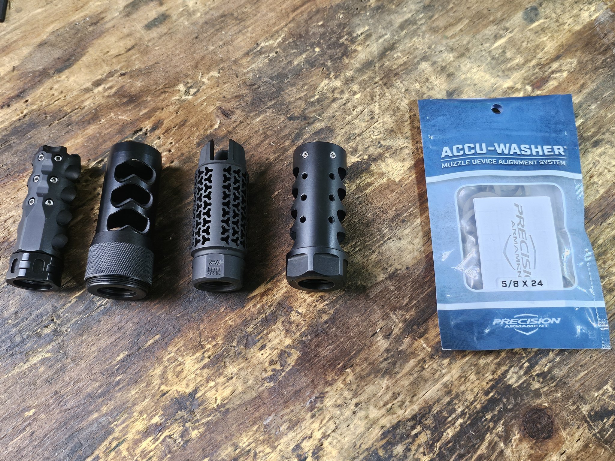

I've got a couple of both. Hypertap is absolutely more effective. The shooter won't notice, but bystanders would say the Seekins is nicer. The ATC is by no means ineffective but the Hypertap is among the very best.

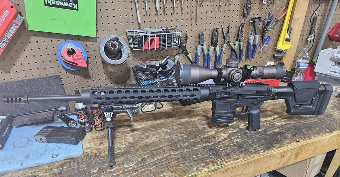

I run an APA Little Bastard on my 7RM. The diameter of my barrel at the muzzle end is .830
This brake is phenomenally effective with my magnum rifle, but absolutely obnoxious to others who are next to me. A few baseball caps have been knocked off, etc...

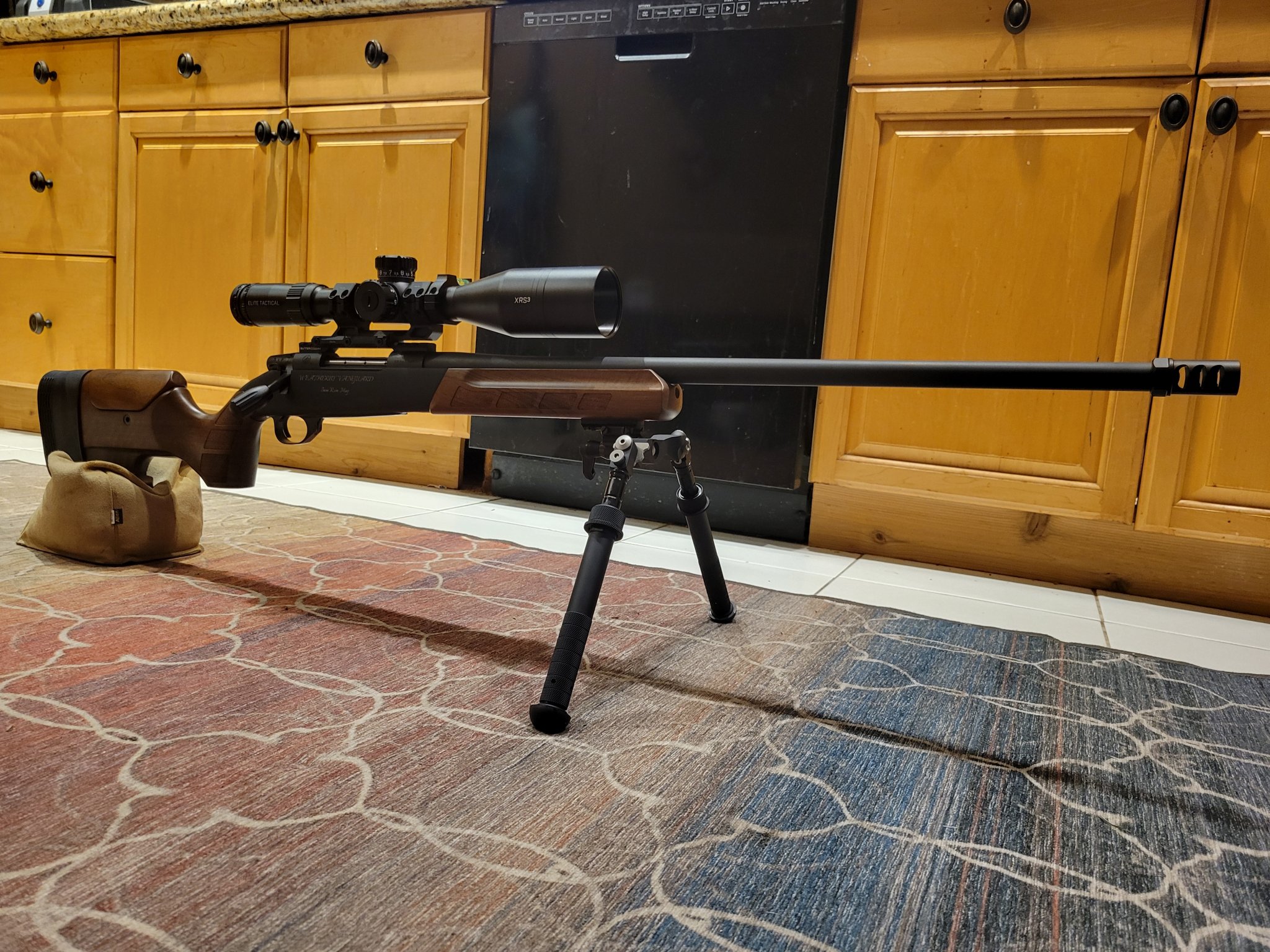

It fits the profile of my barrel quite nicely and since yours is slightly larger it would be even better I would think. Here's a picture of my rig with the APA Little Bastard. Again, this brake is highly effective and turned my 7RM beast into a toddler with recoil and barrel jump.

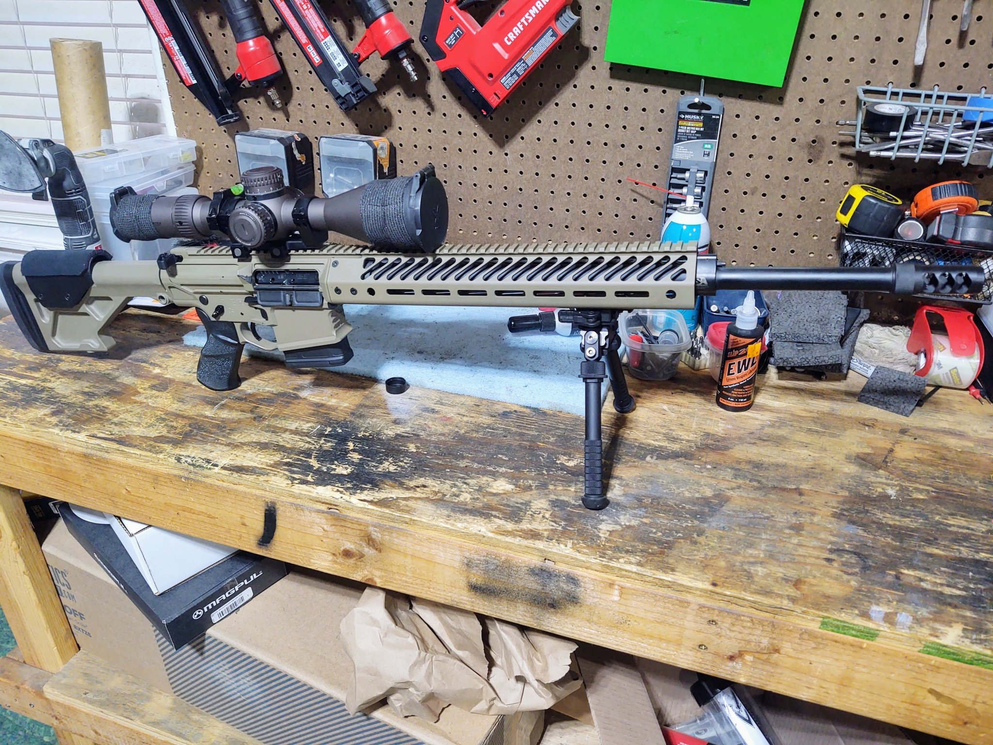

The Little Bastard is very shooter friendly as it directs the gas backward at 60 degrees and you are in the cone of solitude. Those next to you, however, are directly in the "I'm moving somewhere else" zone. Again, be forewarned that you're going to get some dirty looks and the occasional "WHAT IS THAT!!!!!".

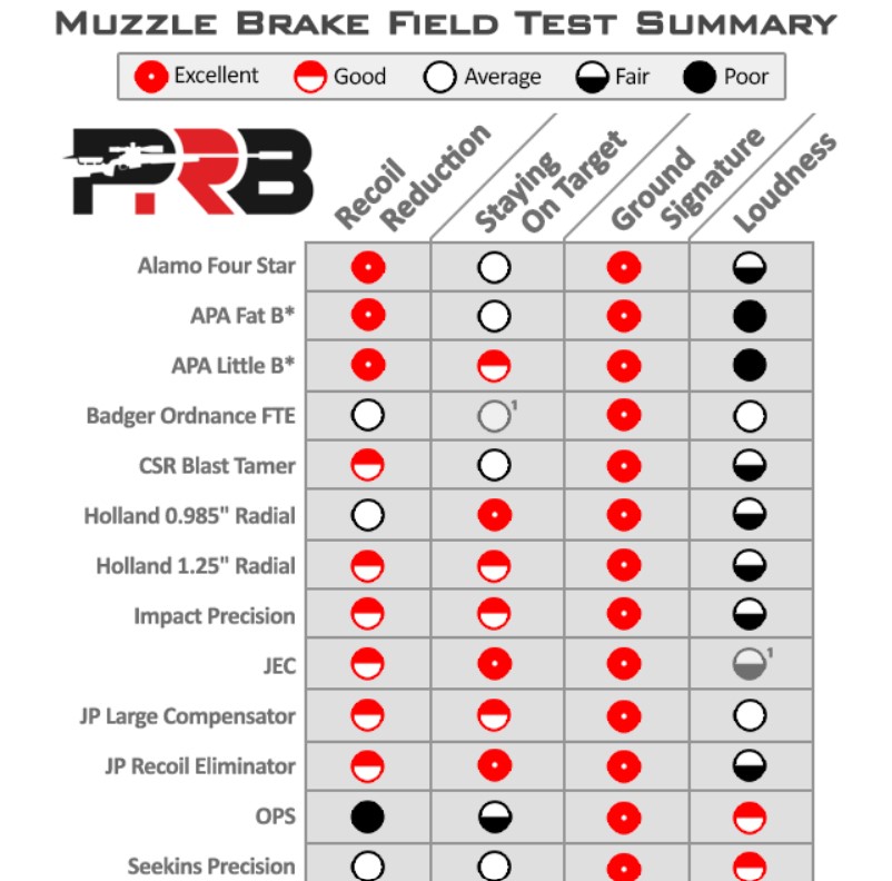

I took a screenshot of the Field Test Results and as I suspected, the Little Bastard ranks pretty much the best in all areas except for being obnoxiously loud to others, but not the shooter. The author of the article seemed to prefer the Little Bastard over the others as well

Are these still the PRB articles from almost ten years ago? A lot of brakes have come to market since, and some of those listed aren't made anymore.

Yes. The article referenced above was published in August of 2015.
I’m not sure what happened to the Precision Rifle Blog, but tests like the one above made it a great reference for shooters.
I wish they would bring it back.

I've got most of the the big name players in Muzzle Brakes and you really can't go wrong with either of them. My Precision Armament Hypertaps have all been drilled and tapped and to be honest I haven't really felt the need to fine-tune them yet. I'm running a Slim Body .30 cal Hypertap on a 14.5" LaRue LW50 Barrel that I've had for close to 10 years now and I'm extremely pleased with the recoil impulse/reduction, very little muzzle rise.
Yeah.. the reports are old, but still full of useful info to me.
Even showing how much a brake can alter POI, is good to know.
The one link showing the blast direction, helps show the brakes exhaust with the baffles ( ? ) being angled towards the shooter.
I would love to see a newer , up to date review.

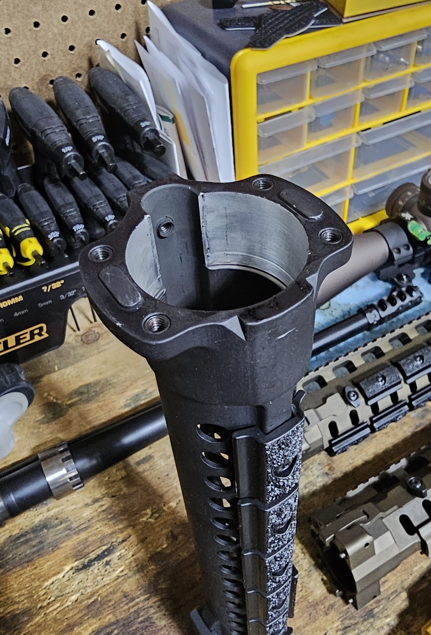

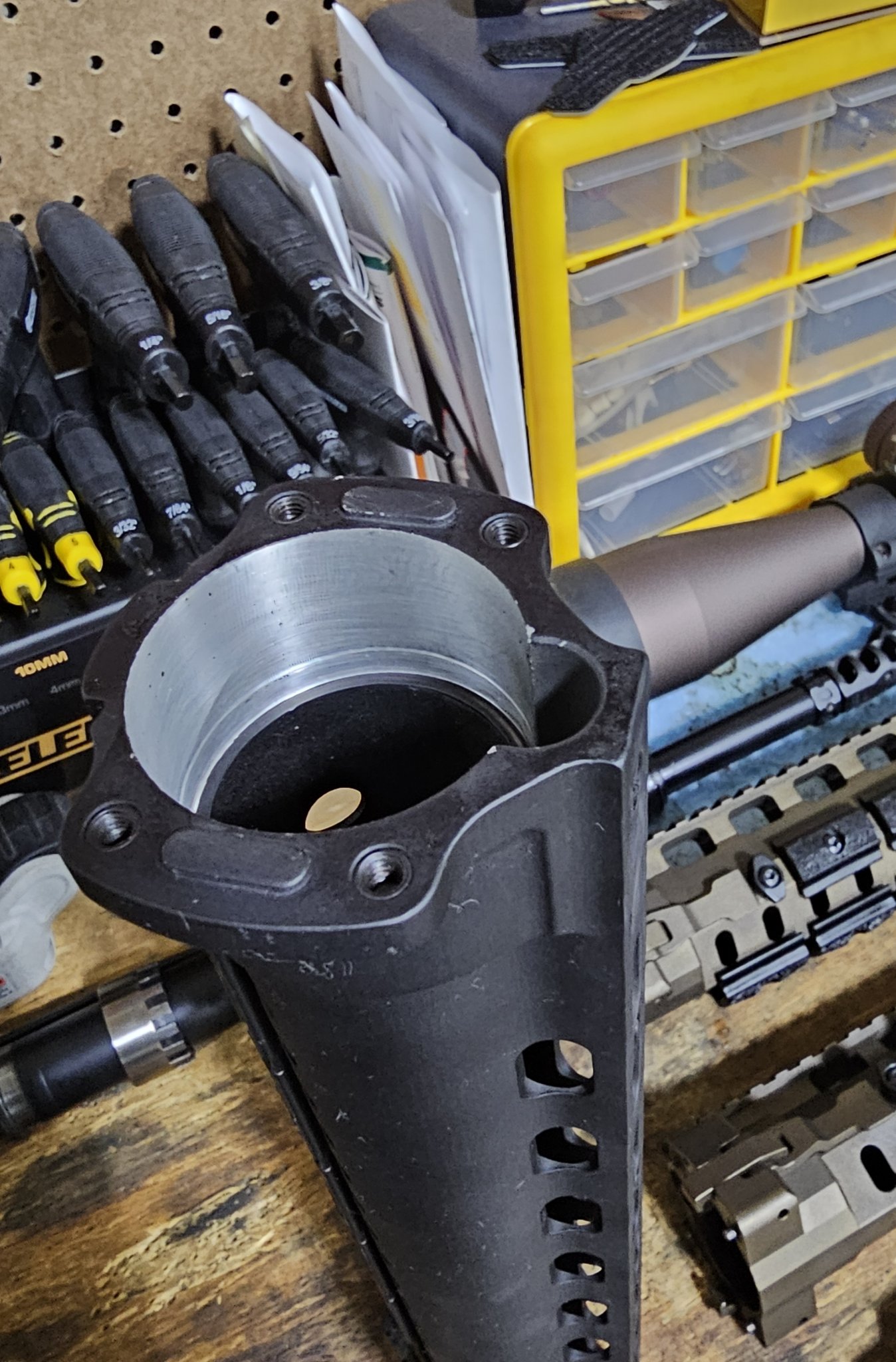

Now when working on the Seekins or Mega receiver sets I make sure to measure the inner diameter of the upper receiver where the barrel extension slides into, so that way when I order my Custom barrels I make sure to order the appropriate oversized Barrel extension for each individual receiver set so that I get the same Thermo fit with the barrel to upper receiver as I do with my JP's ultimately increasing the barrel rigidity.
