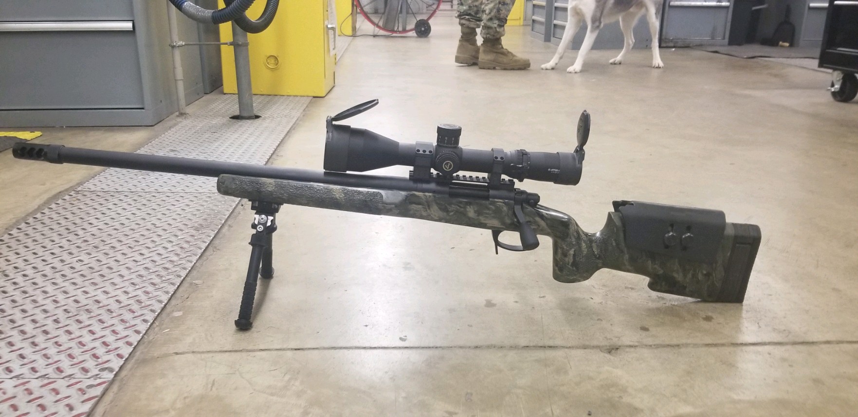

So last time at the range I took 2 new muzzle breaks to try. I tried the little bastard gen 3 and the area 419 hellfire. I tried to shoot a group with the LB and it was horrible. Last time with this load it was doing .25 to .5. It was around 1.5. I'm not going to freak out yet and I'm hoping I just had something loose and don't have to go to my old break or redo the load. But have any of you seen that happen?

Bad thing is I have to work all this weekend so I have to have this in the back of my mind till I get to try it again. I'm sure it will group fine and I had the break loose or something. But worse case I'll toss the old break back on and shoot this comp coming up and then tweak the load to get my groups back. I think I have decided to run the the hellfire, so as soon as I can post sell adds ill toss the little bastard up for sale.
