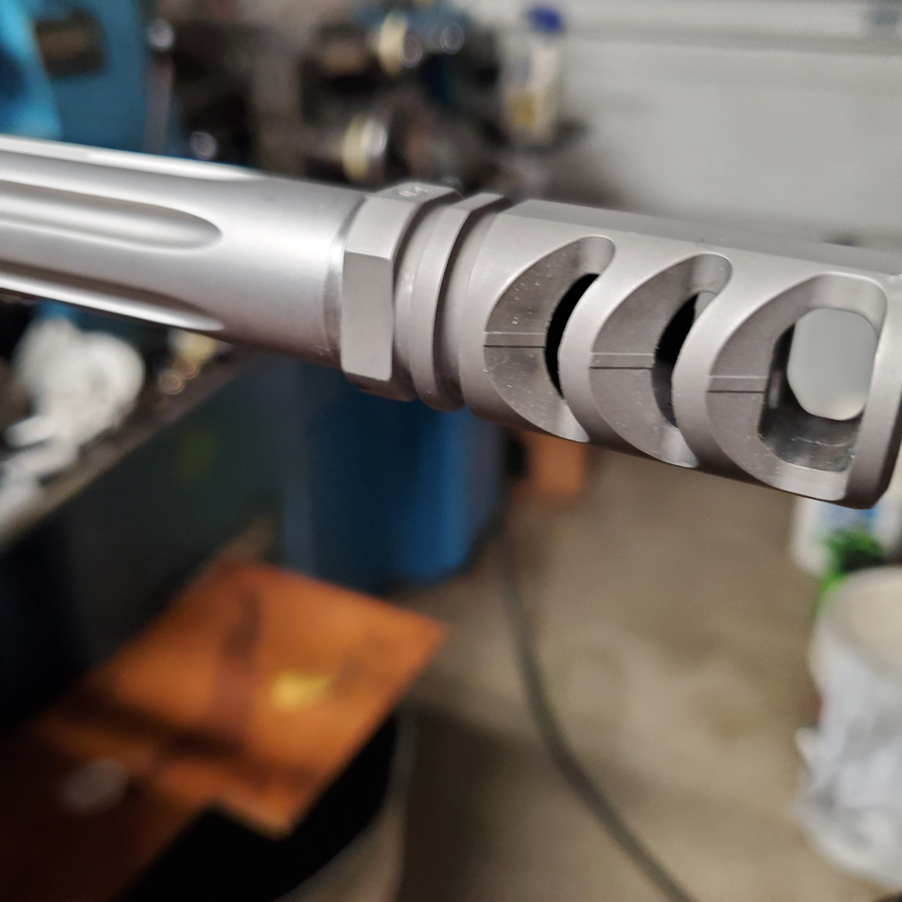

Muzzle brake is the answer to less recoil.
I use the PA M4-72 on most heavy recoil rifles.

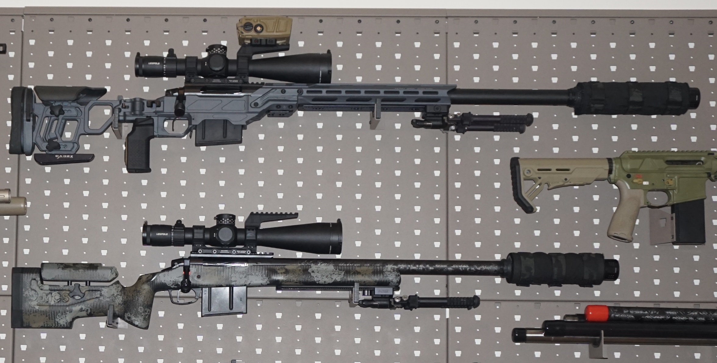

On the 308s with hybrid cases, the 300 WM, and... here pictured the 300 RUM altered to feed 4.20" cartridges shooting 250 gr Atips at 2985 fps in 26" barrel, with 101 grs of powder, 9.0 lbs rifle without scope ...and you can shoot it comfortably from the prone. But it's noisy so good hearing protection is a must, but very easy on the shoulder.

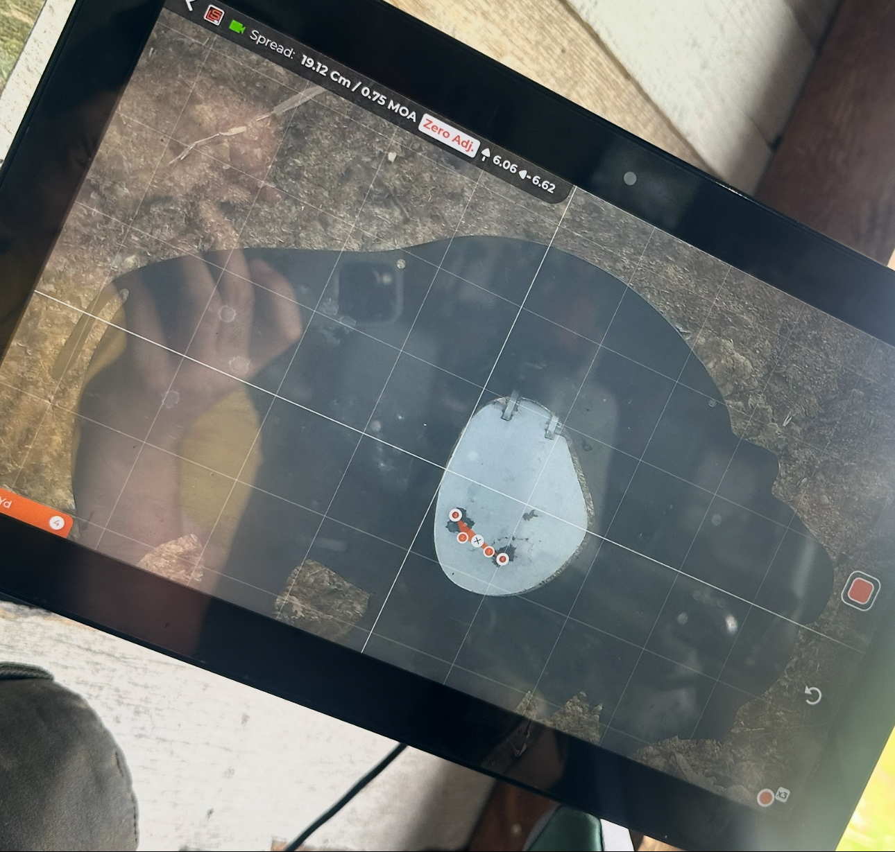

My 18” WM shoots 6” groups at 1000 yards at least twice a month every month. You guys are just making up stuff about the performance based on conjecture not experience. I’ve even had the rifle out to a mile at Arena, GA.
This is based on a super high level of shooting and reloading but it’s not remotely what you said.
With that said - no, 300 wm short barrel is not the best place to start this adventure. And I mentioned that earlier
Proof: my rifle and target from roaming shot LA at 1100 yards

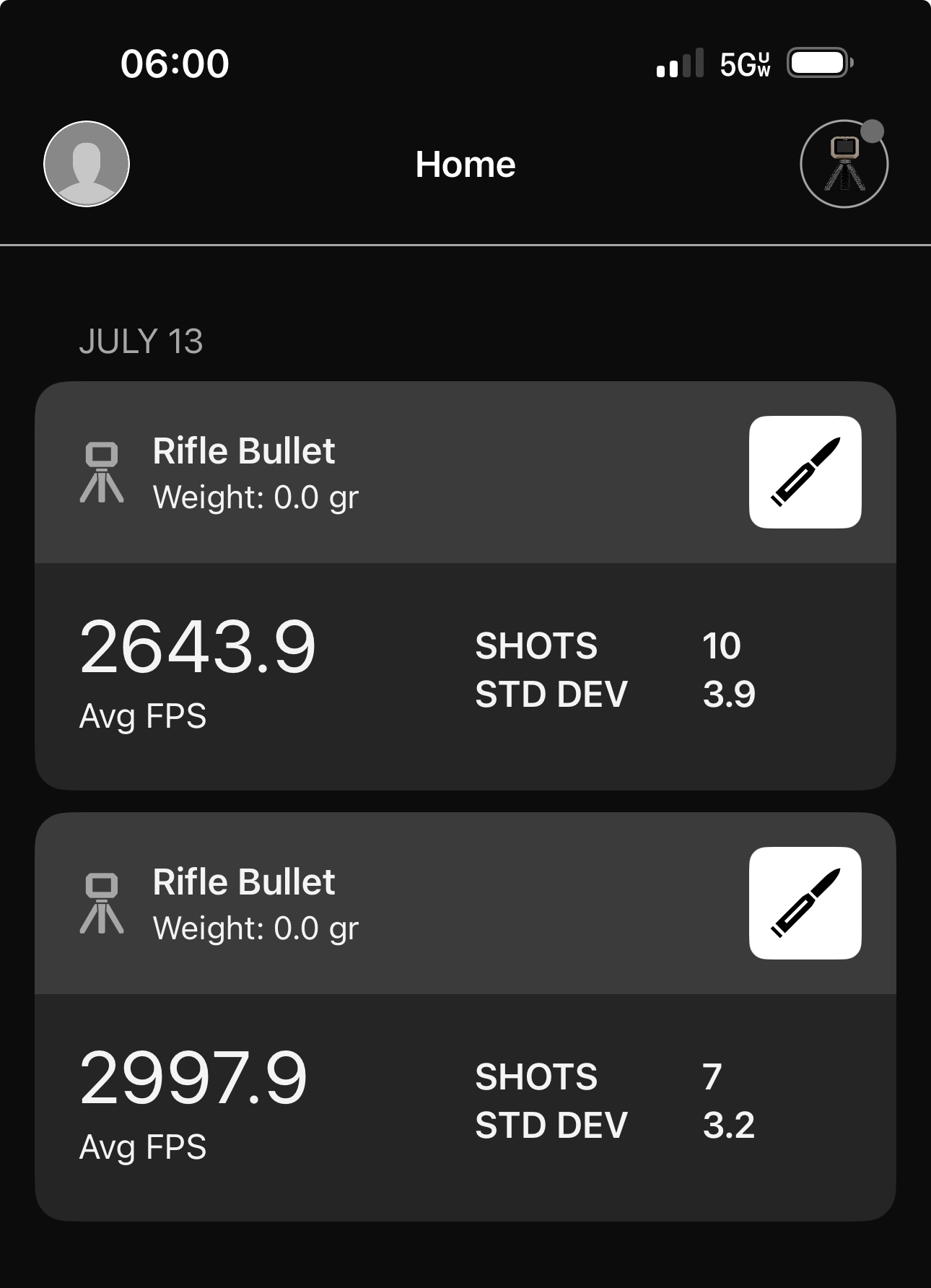

215 hybrid at 2650 from this weekend - 4sd
My 300wn pushes the same bullet as yous over 300 fps faster which is why the longer barrel is where the 300wm belongs in. I bet given the choice between your 2650 and my 3000 fps you would pick mine to make mile hits with in variable winds. I have made hits at a mile with6mm arc but not my first choice
