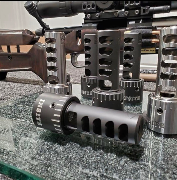

If it were me I'd be looking for something with minimal blast and concussion, especially on a 30 cal magnum. I really like the insight hethen brakes
Might be worth waiting on the new version with the built in barrel tuner.......
Should be ready soon from what I'm hearing......

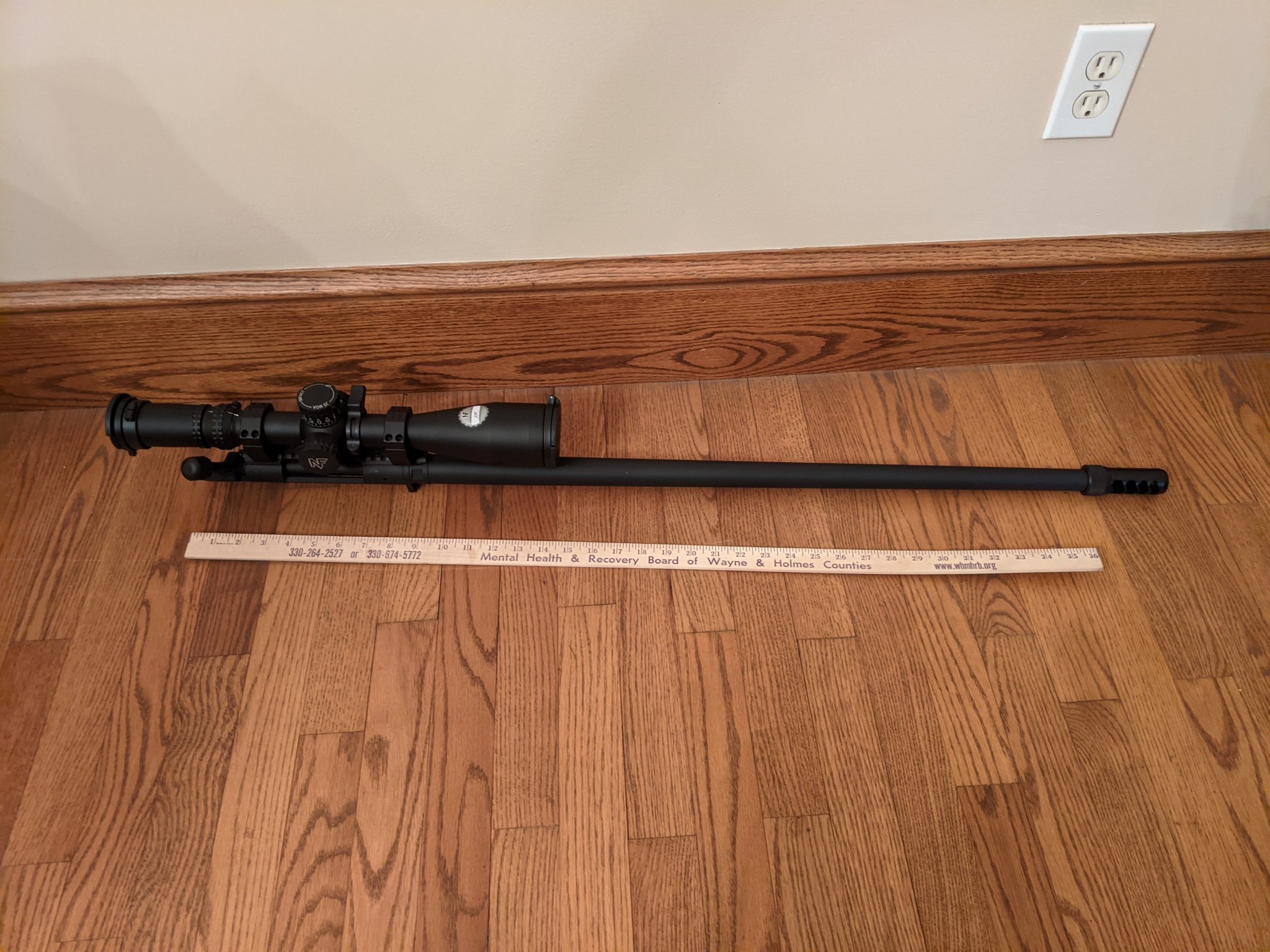

I have a sidewinder on a 300 prc build with a heavy varmit profile barrel. As you can see in the picture, it is big. The hellfire or little bastard would be my picks based on the size of those muzzle brakes vs the size of the barrel your rifle will have. I also have a little bastard, it will really cut your recoil down.

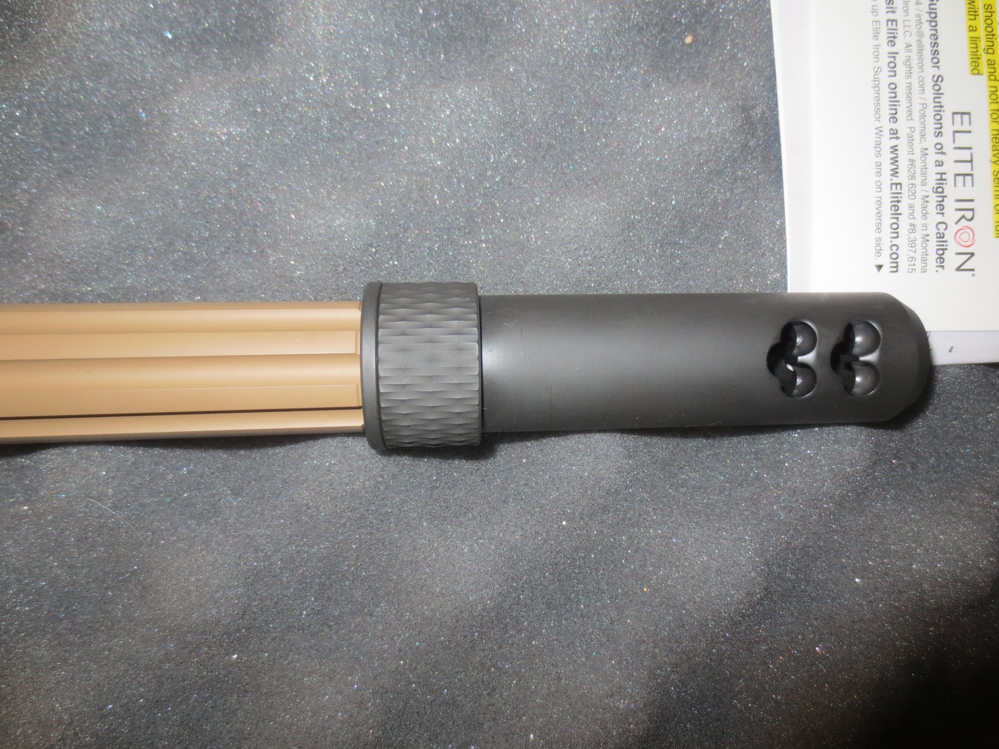

I use the brakes Elite Iron makes, same thing Harris uses on their rifles FWIW. Just sorta worked out that way, they make all my big bore cans. Definitely not as aggressive as these other brakes, but they for sure make a difference.
I have a Sierra SD suppressor so I'm married to those brakes for .338LM, .300NM, etc. on the MRAD. Basically a two chamber Harris type (or maybe it's the other way around and I should say Elite type?) but smaller, fits over the last two inches of barrel. They do amazing work, this one had to be fitted:

For a .30 cal hunting rig, I personally would primarily look towards a brake that doesn't direct the blast/concussion back to the shooter. The Insite Arms Heathen does a really good job of both being effective in reducing recoil, while not directing blast back to the shooter.
As someone else has pointed out, Insite is coming out with a tuner version of their brake. I'm assuming this rifle is for hunting, and I would keep things as simple as possible and avoid putting extra things like a tuner on the end of the barrel, but that's just me.

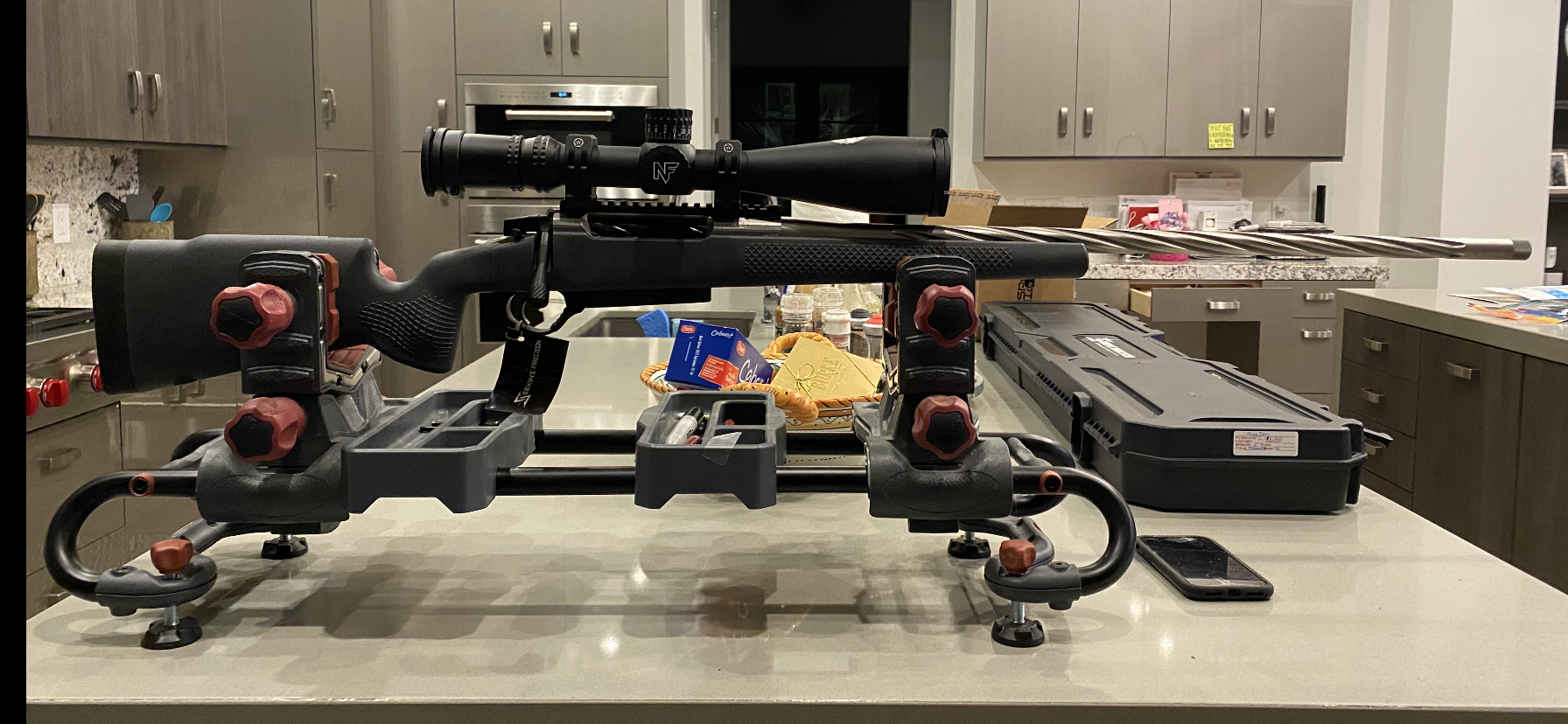

I am still on the fence about which MB to go with. Brought the rifle home today and the muzzle end of the barrel measures .700”, which means that a Sidewinder or similar brake is certainly going to look huge on the end of this barrel. I’m not too excited about putting something that large on the end of this rifle, and would like to know if there are any slimmer options that actually perform their function well.
Anyone have experience and feedback on Seekin’s ATC brake? I haven’t heard that one mentioned. The low price in comparison the others being discussed has me suspicious about it’s effectiveness.
