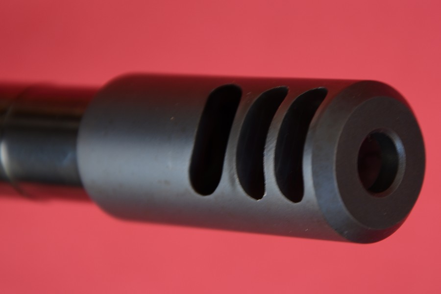

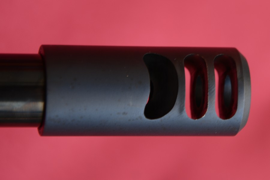

A good compromise between rear/side blast and recoil reduction is Steyr's brake model used on SSG 04 and 08.
The idea is the same as for the muscle brake mentioned above -- the first chamber is oriented forward to let most of the noise go where it belongs, the next two chambers actually brake.
Tested it on .308 and .338, bought it, love it (and spotters love it too).
