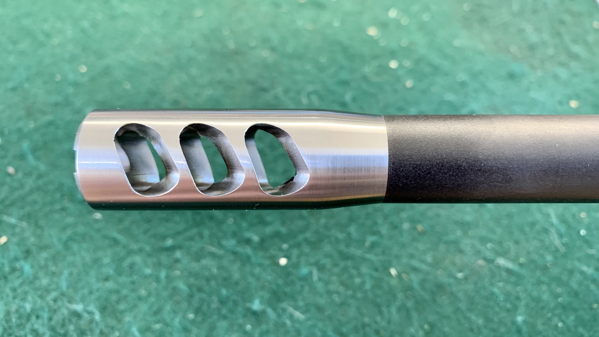

    I like the muzzle brakes and more brakes. Very nicely made, many sizes(ports, diameters, and threads) and he'll even turn them to specific diameters, even titanium versions. They have an angled port which creates a downward moment during firing which keeps the gun really flat.

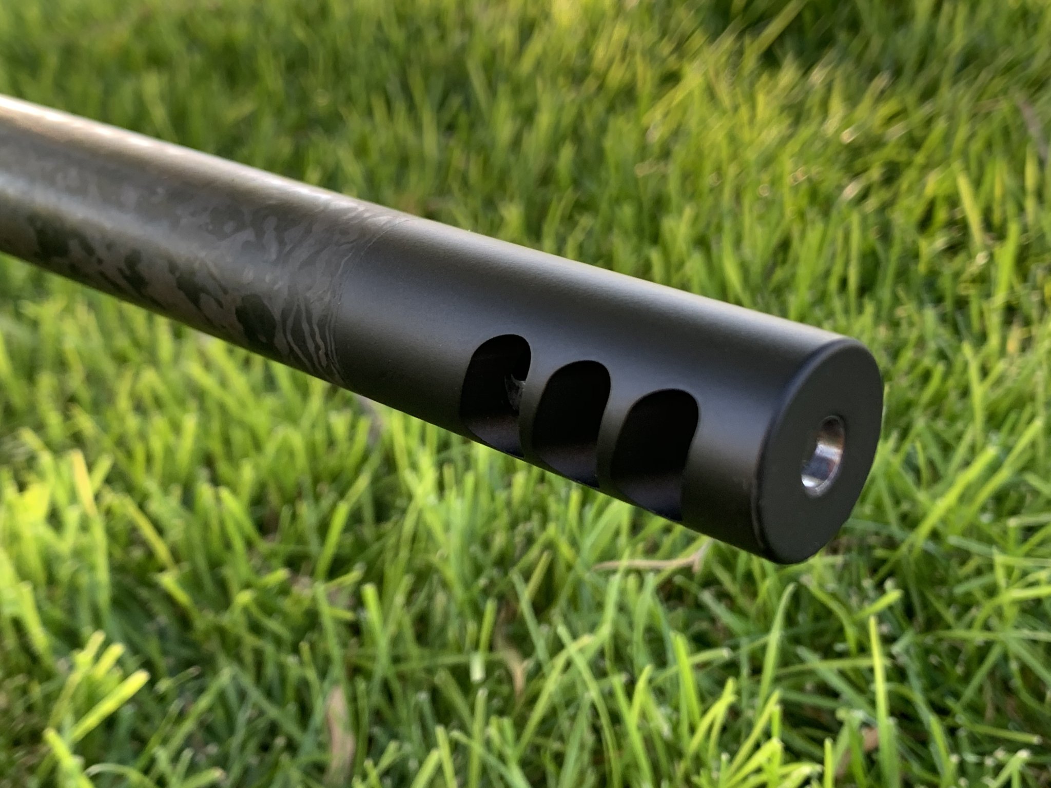

    I do a blended install with them, and they come out nice. Here’s the Lil beast (.875”) version on a proof.
    Once they're torqued/loctite in place I turn the face off of them.
    They come out super clean.

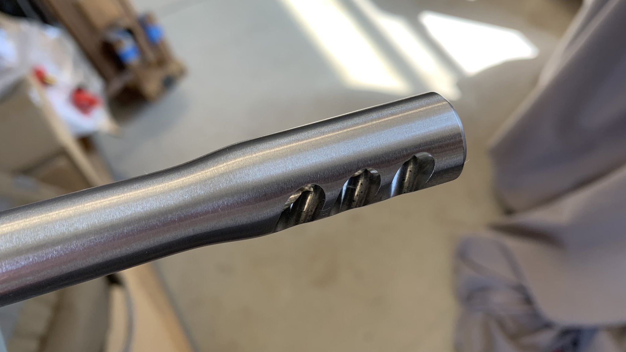

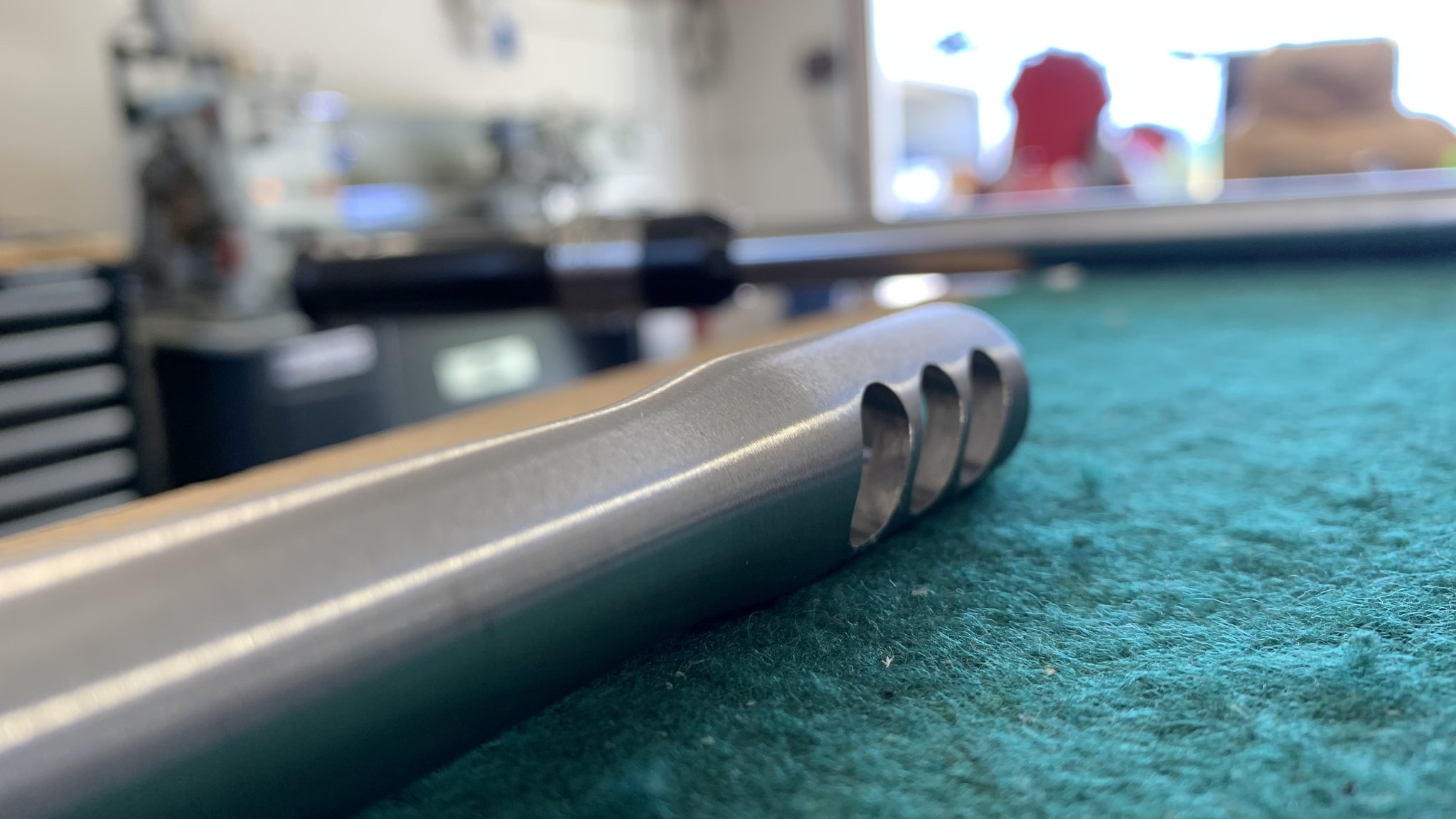

    The brake you need is this one. Its .749. Comes in any bore size. I buy them undersized in the bore so I can bore them to suit the application and know theyre perfectly concentric. Theyre very straight to begin with though. As good as anything I've seen. I have no affiliation with them, just been using them for years.
    You can turn them down but on sporter barrels I taper and blend them. These are .650 ish barrels.

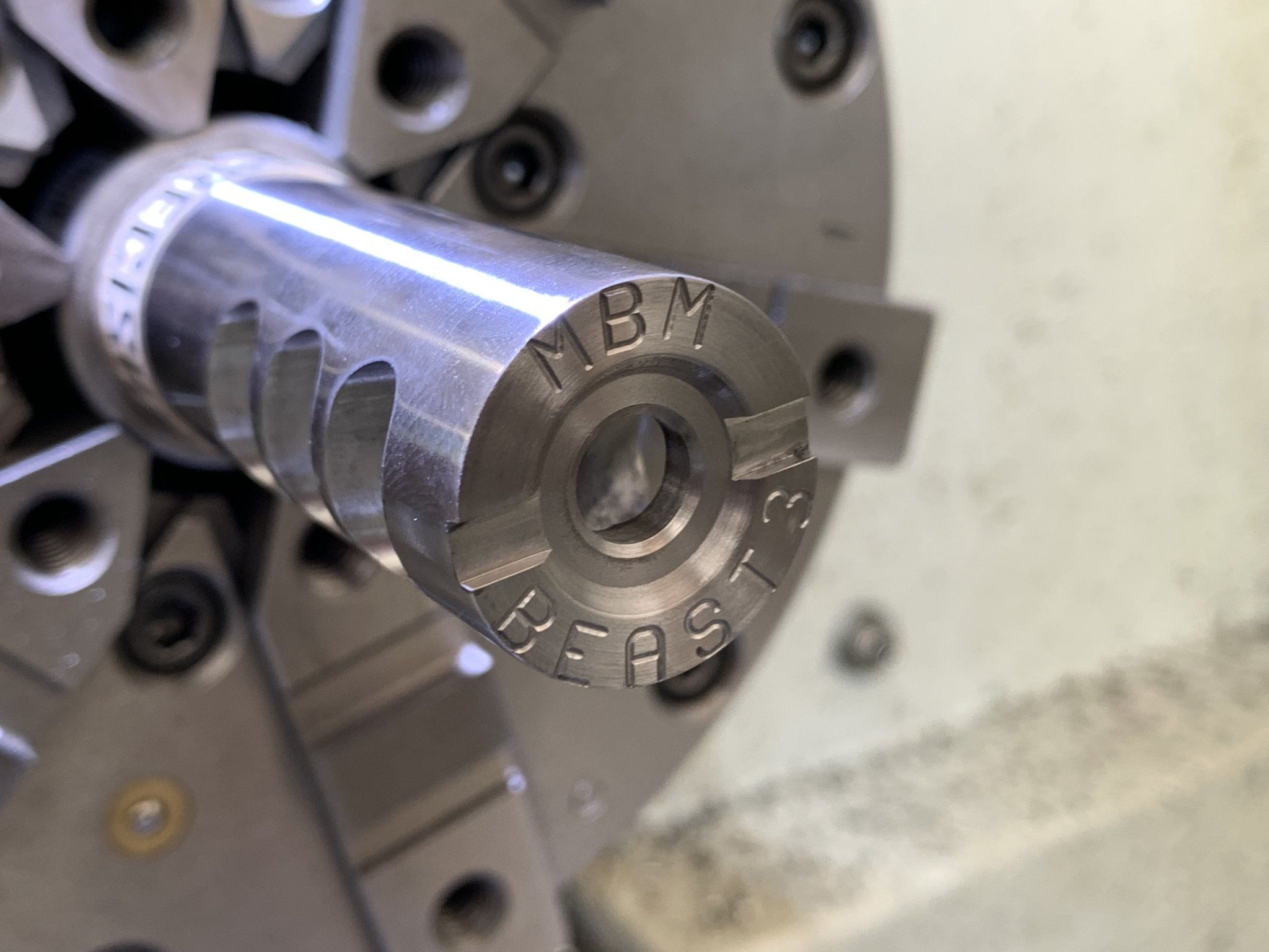

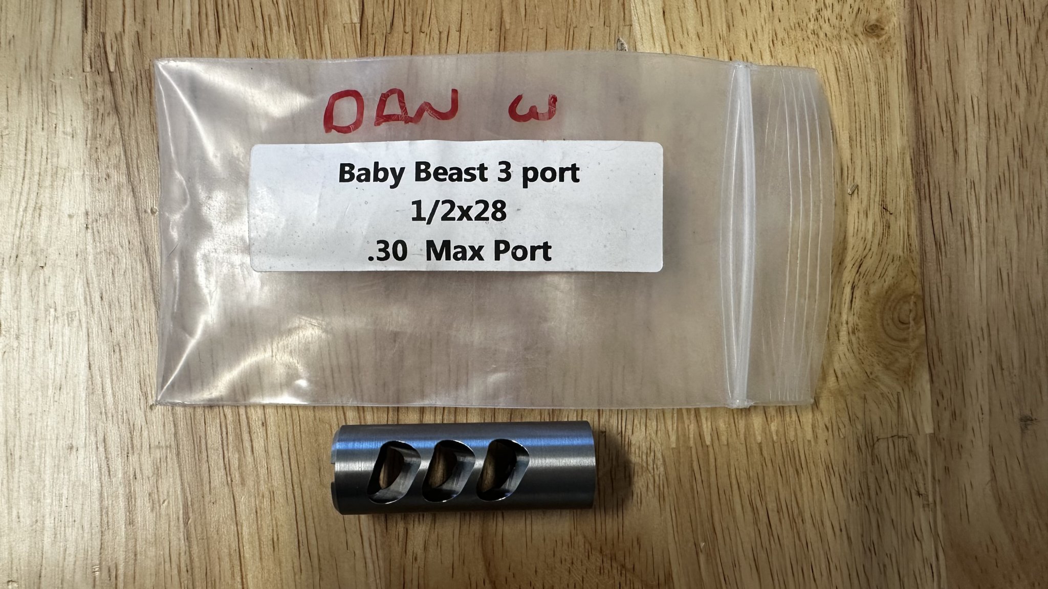

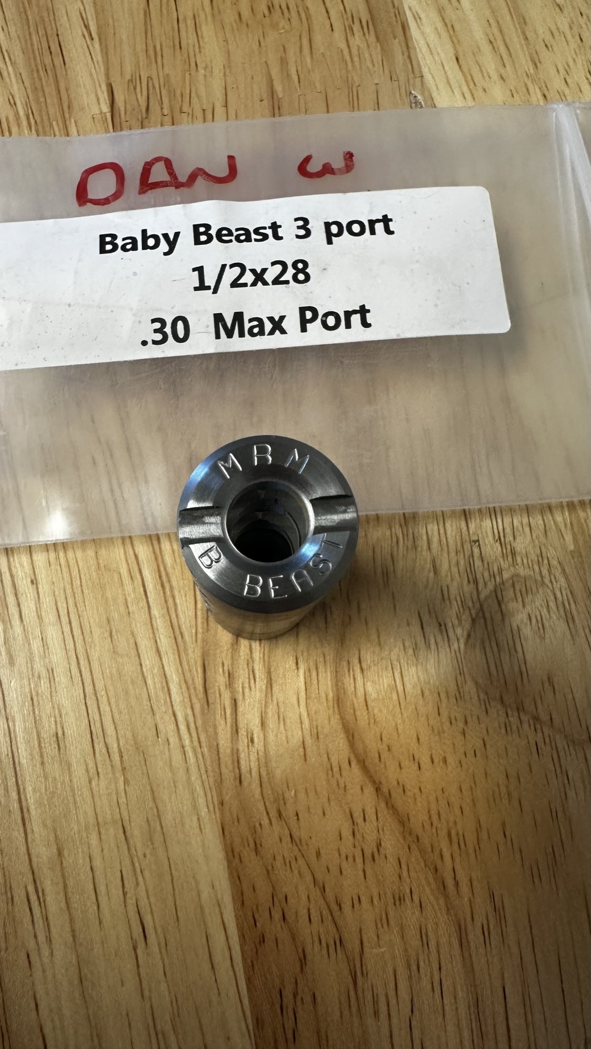

    I do a lot of timed/blended Muzzle Brakes and More "Beast" brakes on all size barrels. I like them as well as the APA Gen 1 Little Bastards and Micro Bastards, although they don't recommend turning them down. When the diameter gets much below .7", I usually recommend a radial port design.
    I can't remember what diameter these are, or exactly which Muzzle Brakes and More "Beast" model they were, but they turn out clean.

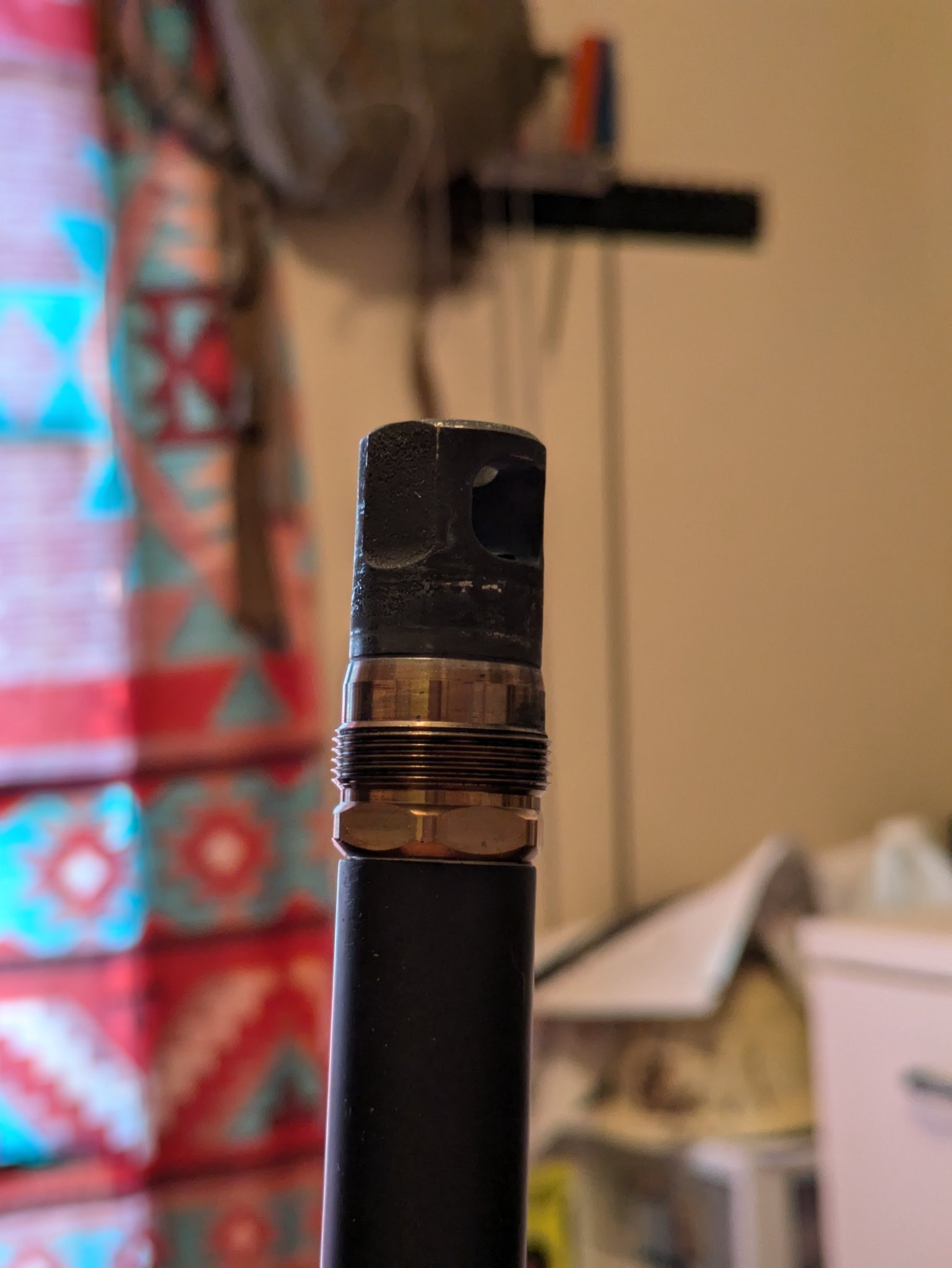

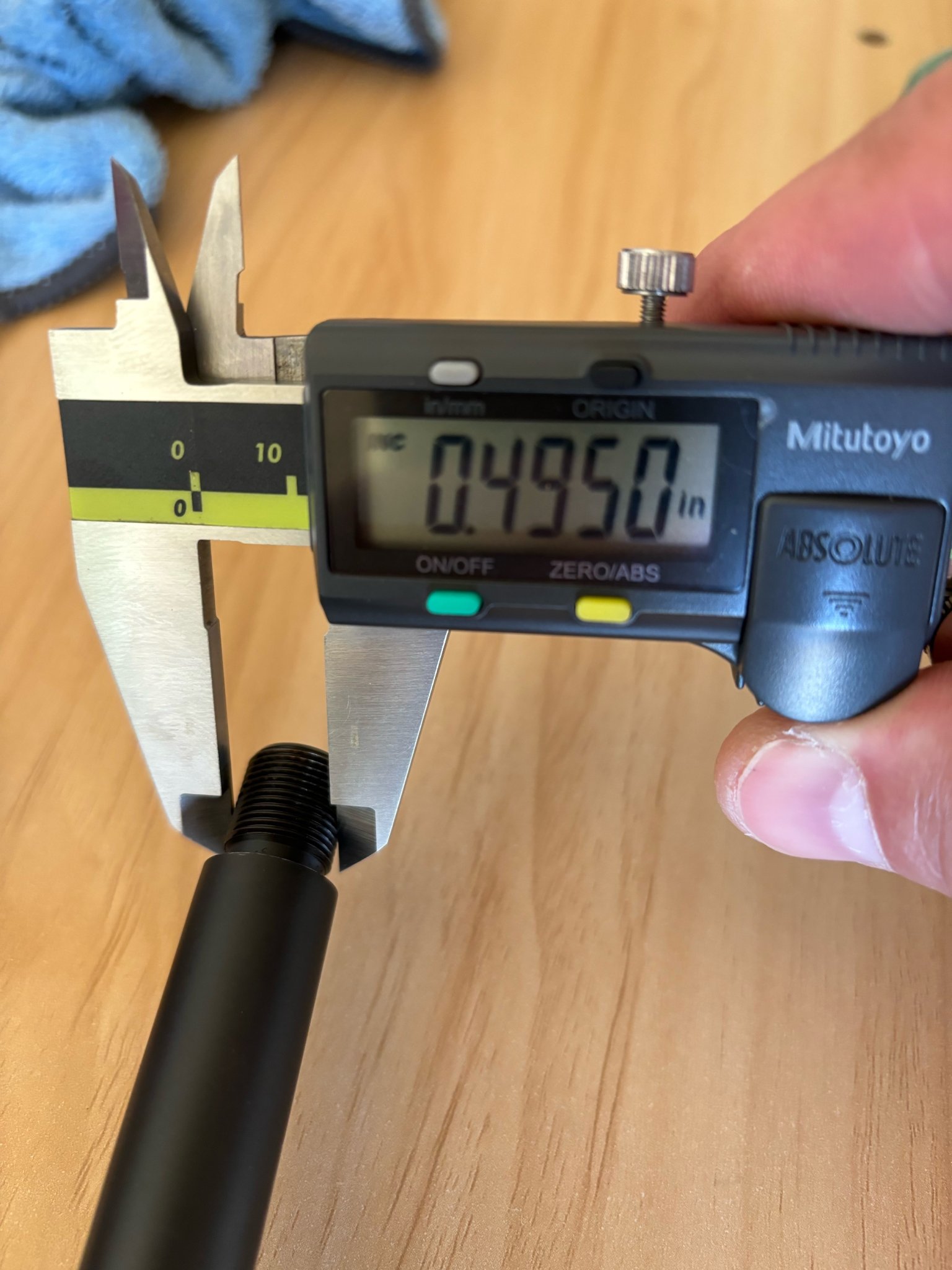

    Is there an adapter that I can buy to mount a break on my rifle? I've bought 2 different breaks, Hellfire from Area419 and Ultradyne Apollo S, and both of them are too big. The rifle is a Howa 1500 6.5CM.
    Terminator makes the T1 in a .630" diameter and the T1+ in a .730" both available in 1/2-28 threads. I have the T1 on a Superlite Tikka 223 and the T1+ on a X-Bolt 223
    Glad you figured it out, never trust published information, it's usually wrong. I always wait until the rifle arrives before I order a brake.
