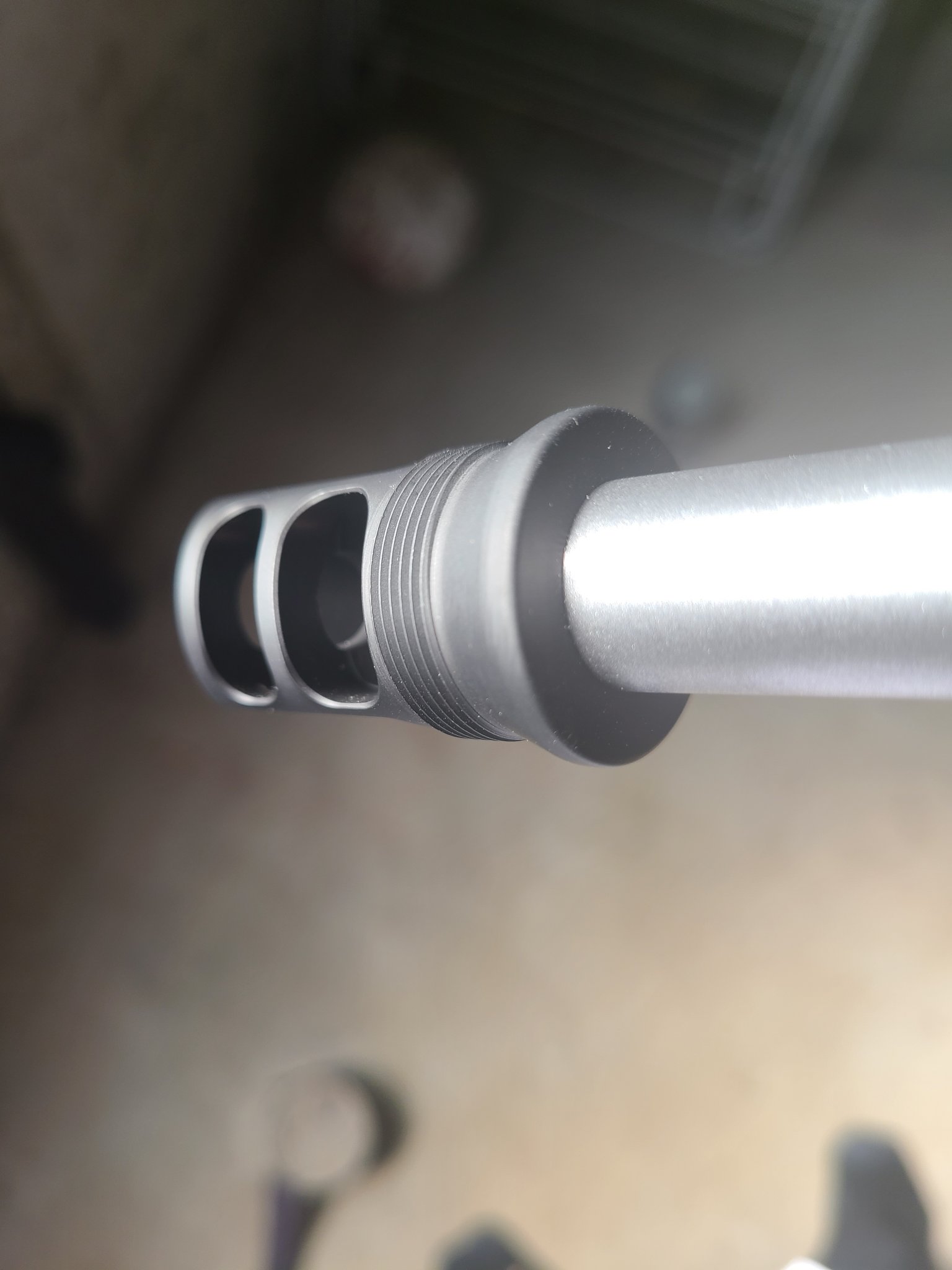

    i had my tikka t3 lite stainless 24" 300 wsm threaded for a brake, 1/2x28, without shortening the barrel. that seems to be the least expensive option.

    If I were going to try to thread a sporter barrel too thin to support a proper shoulder on its own I'd look for a smith that could do something like the video below. Could be double the cost of a standard/normal threading but maybe worth it if you want to keep the entire gun intact. Doing something like this might let you keep the length/velocity of the original barrel, find a nice light can to hang off the end. If it doesn't work out you can still put a protector on the end of it and use it unsuppressed or chop it shorter, as previously suggested, to a thicker part of the barrel and sacrifice a little velocity for stiffness.
    The OD of the original barrel MUST have at least enough meat to support the major diameter of whatever thread pattern is chosen or it's an absolute No-Go.
    As far as accuracy goes the POI will definitely shift once threaded and suppressed but many sporters retain a repeatable POI afther threading and suppressing so accuracy, especially for hunting, is often retained.

    You should be fine. In my experience with Tikkas, they all pretty much shoot well. Especially for the ranges I'm assuming your son is going to be hunting. I had a Tikka 300 WM, and one of my local gunsmiths threaded it 1/2-28.
    Thunderbeast and others don't recommend threading 6.5 and 30 cal bores with 1/2-28 because groove to minor diameter is less than 0.100".
    T3x lite muzzles measure 0.616". To have proper shoulder diameter for 5/8 the barrel needs to be 9.3" long.
    Mine I sent into Thunderbeast for their face mount cb brake. They threaded it 9/16-24. Uses muzzle face for shoulder.

    I had a T3x Lite Roughtech (fluted) 6.5C barrel cut down to 20” and threaded. My smith wanted to go to 1/2” threads for a bigger shoulder. No loss in accuracy - hammers like a precision rifle before and after.
    If you like the rifle, risk the ~$150 by having it threaded. If it sucks, see if the smith can fix it. Worst case, replace the barrel (or rifle) and you’re only out the ~$150.

    I am getting ready to send a T3X lite 6.5 creed to TBAC to chop and thread because I use TBAC cans.
    IIRC their price is $120 for barrel threading and $125 for the face mount CB brake, plus return shipping via UPS. about a 2 week turnaround.
