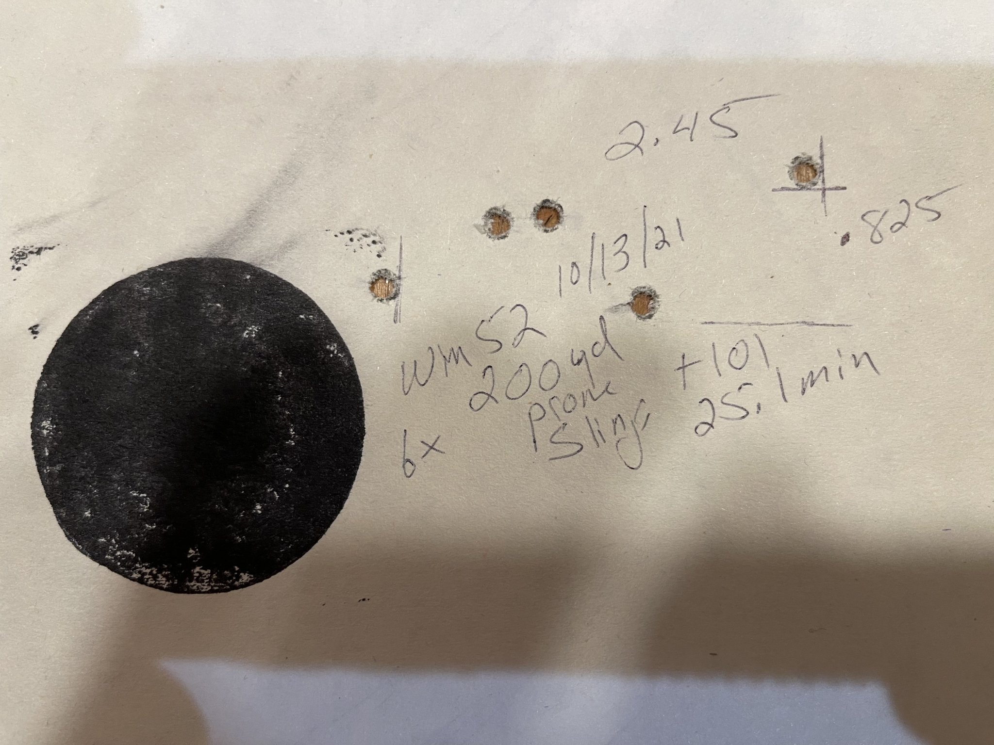

This is 5 at 200 yards. Ignored windage. Just wanted drop figures. Just a practical shooter. I get my theory from Justin. 😁

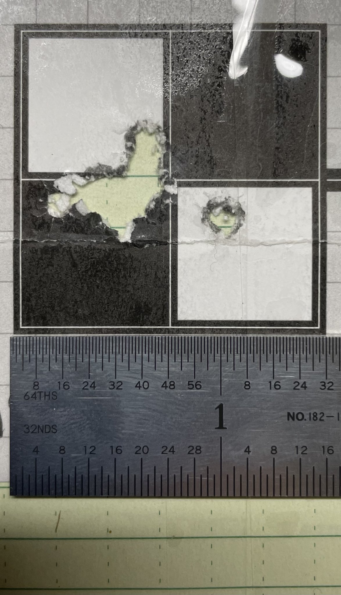

This is your green monster?
Let’s make it simple. It’s not an endurance test or
dragging it out until conditions create problems.
Just make it a 3 shot at 3 dot test. 1/8 min dot at 50 yards. Cold bore. Just like shooting the squirrel in the eye.

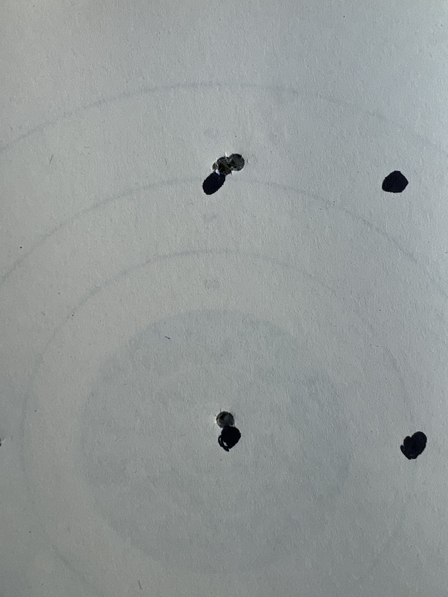

Posted this somewhere else. Top is 3 shots. Bottom after 1/4 min correction. Sitting with tree for back rest and tight sling.
This is not a one off. Rifle is very consistent. Actually not sure how it got 1/4 min R. Possibly condition I did not perceive?
This sighting allows me to hold bottom of eye and center it.

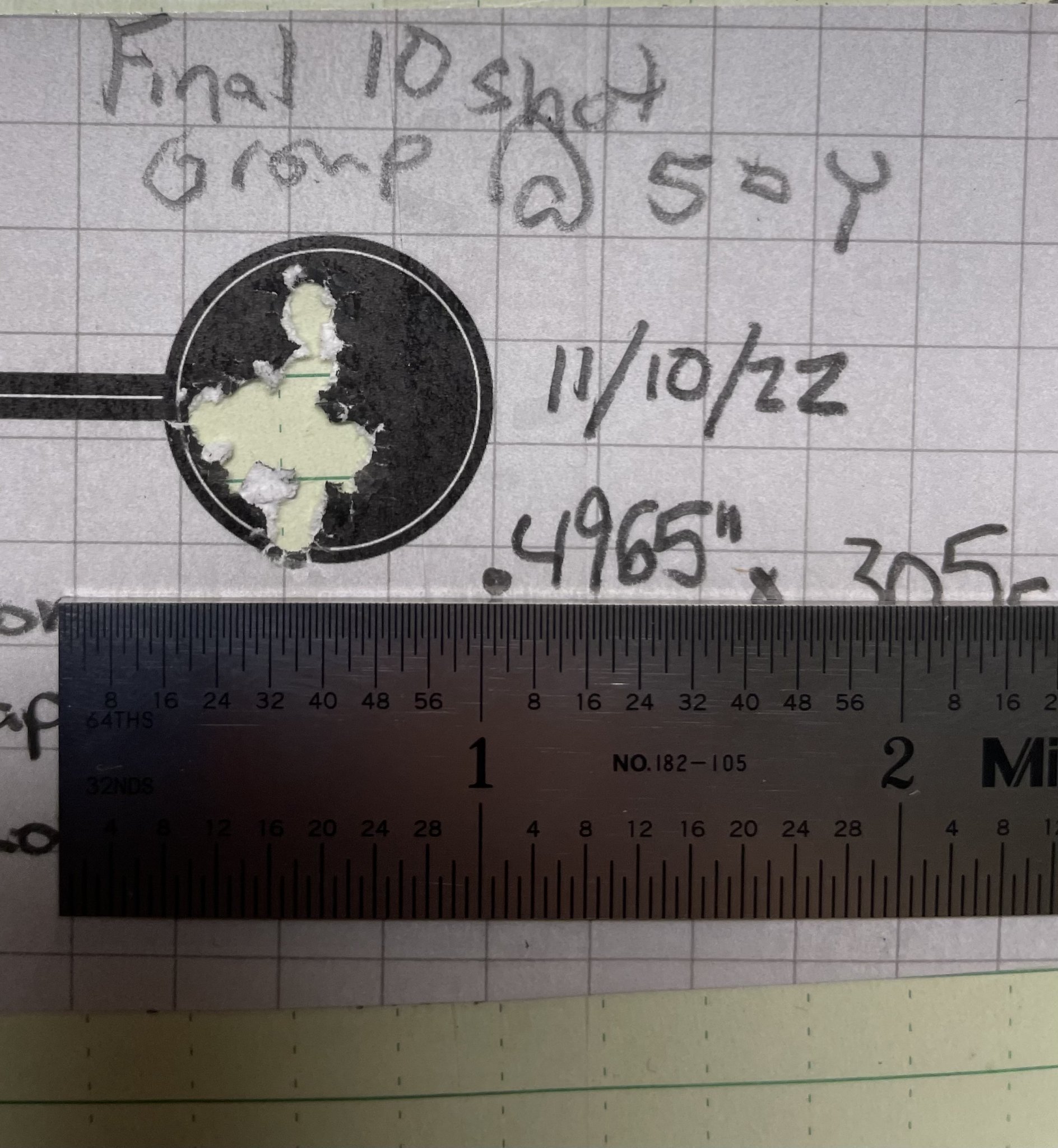

Final 10 shot group before slipping turrets
End of day grouping after 250 rounds
Lapua Center X - Lot # 27551 503876
61* F
39% Humidity
584’ Elevation
973’ Density Altitude
29.27 inHG Station Pressure
Magnetospeed (Sensitivity Level 5)
52 Rounds Chronographed
110 Rounds fired on a Clean Cold Bore before Chronographing
1056 FPS Average
12.8 FPS Standard Deviation
68 FPS Extreme Spread
