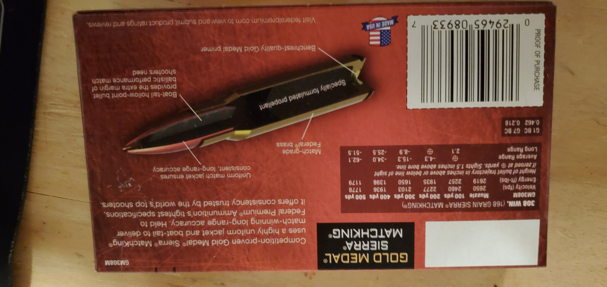

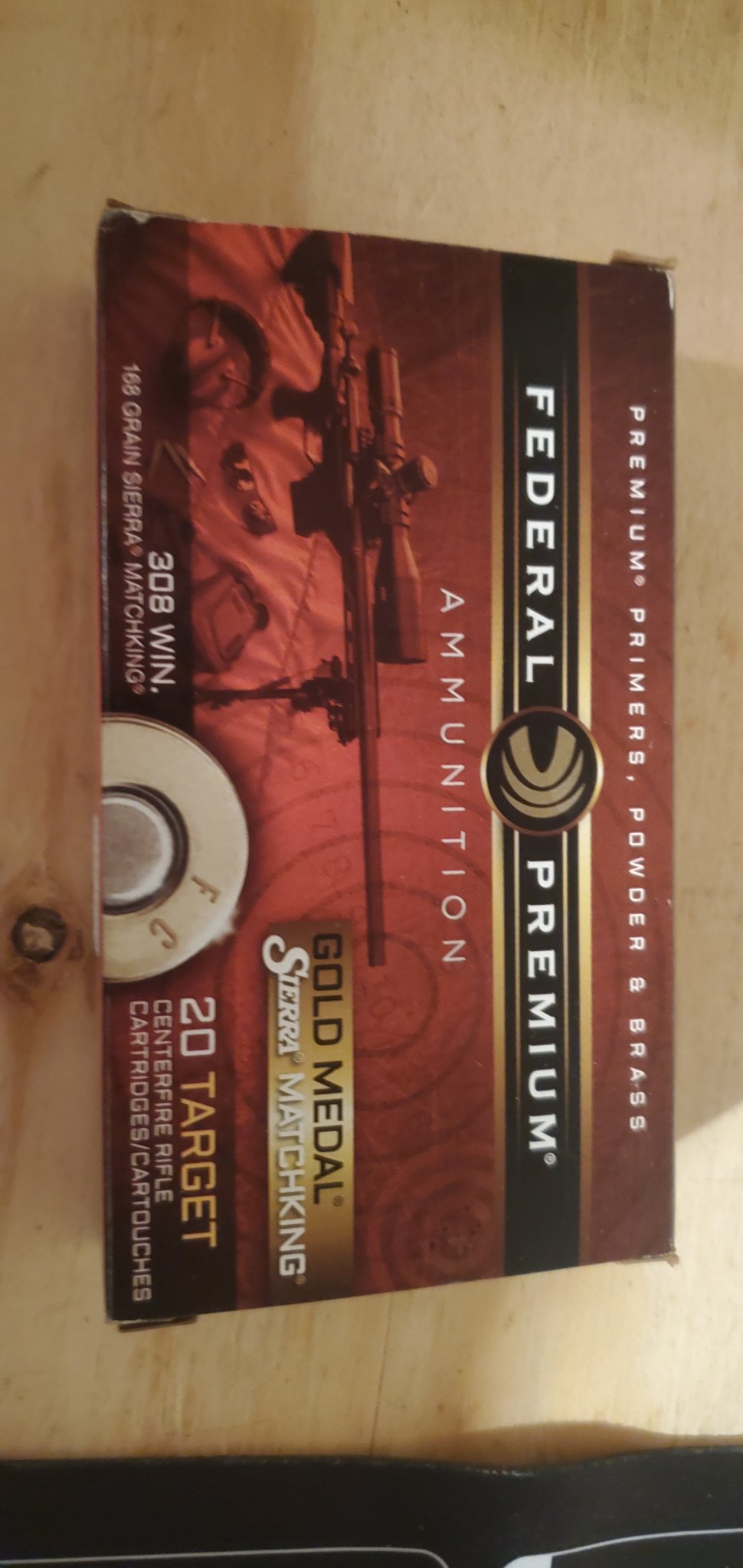

Hey everyone,
Not sure if this is the right place for this question but I do not have a chronograph and I am curious what muzzle velocity I should expect out of a .308 federal premium match king 168gr out of a 20" barrel? I know the back of the box and online info is probably out of a 24"-27" barrel.
Thanks in advance.

20" GAP-10 gets me 2605 fps from FGMM 168 SMK.
Reactions: RichardCranium
Typically they use a 24” to get their numbers. I’d throw 2650 into the calc and work from there. I always start with a higher than expected MV. If it prints/impacts low on the target or in the berm, you have data. Over the top, you sometimes get “no impact no idea” unless you or your spotter is picking up good trace.
