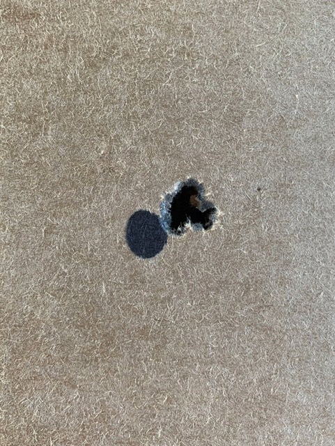

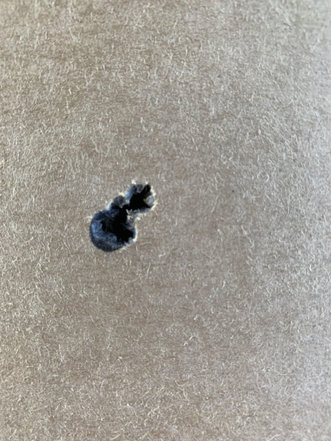

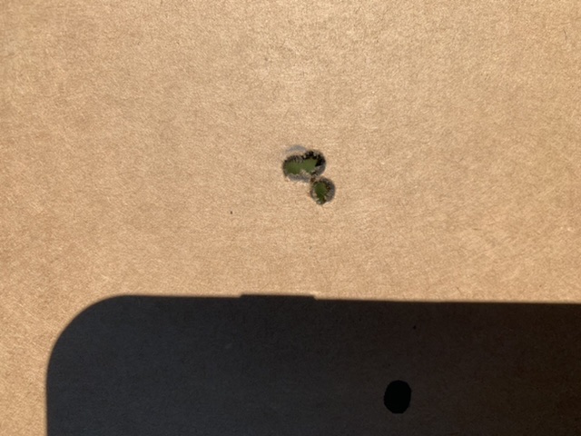

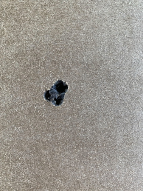

Don’t know if this is the correct section or not, but here goes.
My rifle chronos at 3115 on Magnetto Speed V3. I’m running a 6mm Creedmoor with 105 Hybrids and 41.0 grains of RE16. I shot it today at 725, 813, 905 and 1000. Shooting at a water line painted through the middle of the Target. I had to adjust the MV to match what it doing at distance in the Kestrel. It trued to 3178 MV. I was holding 6.5 mils at 1000 yards.
My question is does that big of a jump seem right? I mean I know it’s good info in as I was able to hit center at all distances. Any information is appreciated.

Was on at all distances. Looked to be maybe .1 low at 400 on a barricade based on the grouping of 8 shots.
I was running the bc on the box of the hybrids. I could put the FPS back at 3115 and adjust the bc of what I was running at 1000, which was 6.5 mils

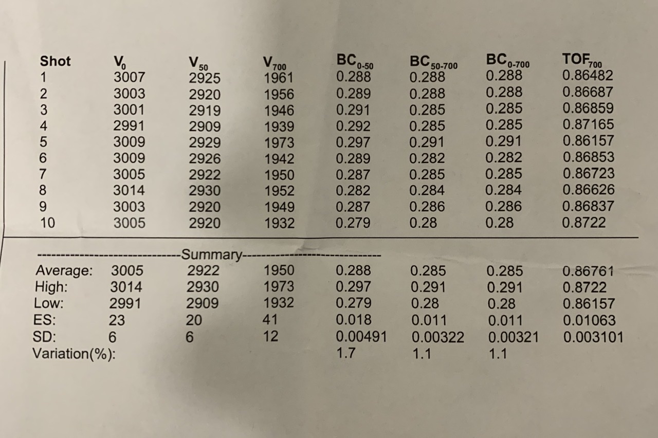

I ran 105 hybrids over the Applied Ballistics Doppler (again) this weekend. Last year with a Bartlein I got a .286 G7, this year with a Hart barrel I got a .285 G7. I bet if you plugged in .285-.286, and bumped your velocity a hair you would be about right.
Are you by chance shooting a 7 twist barrel? The faster twists tend to give the 105 hybrids an increase in BC judging from the Doppler data I’ve seen. An 8 twist will generally be in the .275 range, 7.5 would go .279-280, and 7 is typically .285-286. The 109s ran .295-.305.
Yes, I am running a 7 twist barrel.
