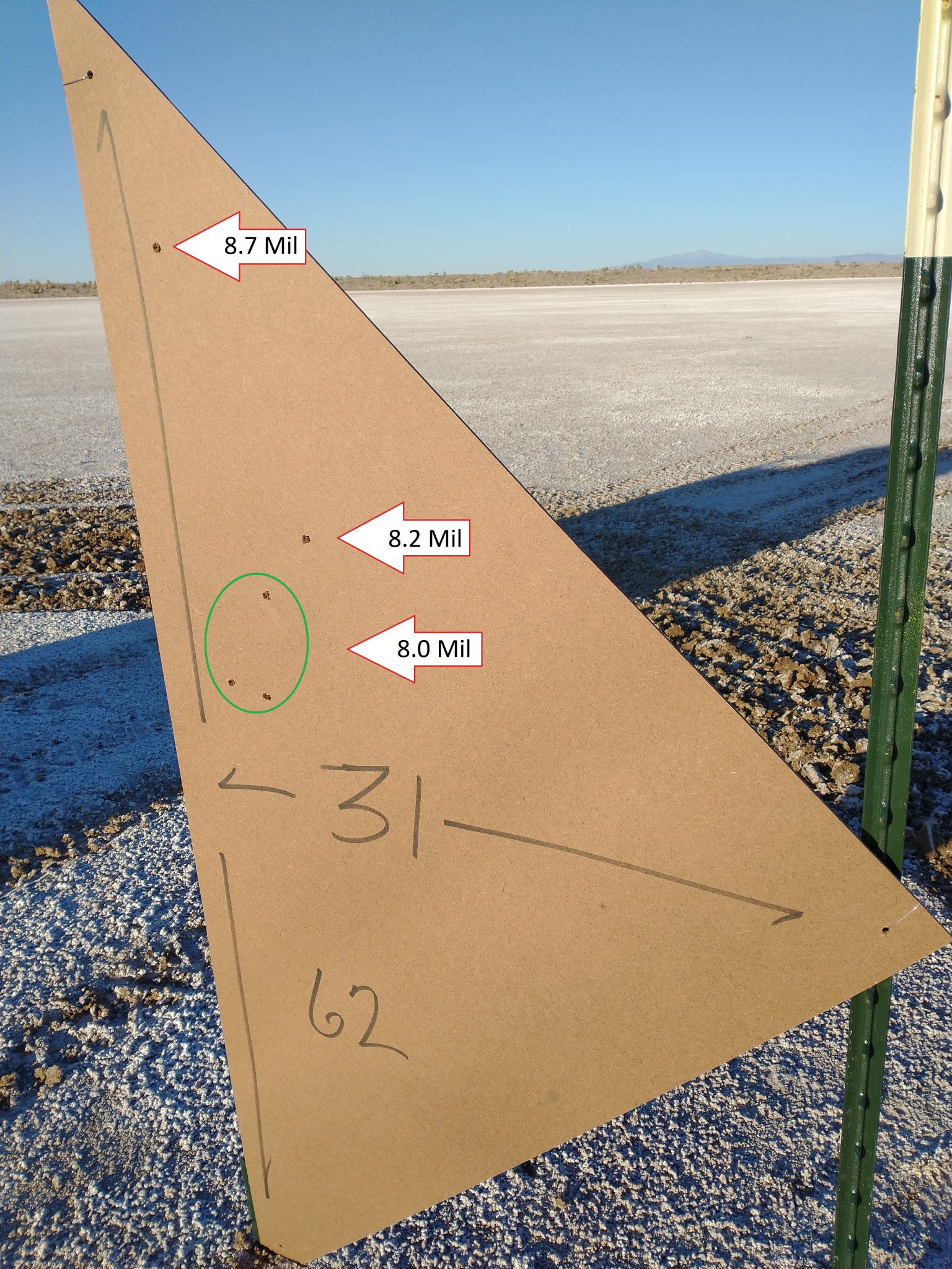

New guy here, been looking around for a while but ran into a wall and need some help.
Took the rig out last weekend, looking for hits out to 1k. I knew I would need to true the measured MV to reflect real world performance because that's just how it goes. Zero was confirmed at 100 yards, calculations were solid at 782 yards (POI may be a tad low, mirage plays with me sometimes) but when I go out to 1,076 yards the data says to dial up 9.7 mils, and nothing. I do the stupid thing and dial up more thinking I must have mil'd the target too close, and still nothing. After an hour and multiple trips to the target and back I put the smooth brain away and decide to dial down to 8.7 mils, then fire off another at 8.2 mils. Next trip to the target shows 2 holes, spaced about 1/2 mil apart (ending up about .3 mils high of target waterline). "Okay, that's odd" I think to myself, but it be what it be and hits don't lie. I shoot a 3 round group to confirm at 8 mils then go home to reevaluate my life decisions and play with the calculator only to find out to adjust POI to reflect ~7.7 (where the waterline is) I have to adjust MV from 2697 to 2988! At this range my bullet is still supersonic, so I haven't adjusted BC, but in trying it just for the sake of fun I found out I'd have to move the BC from .301 to over .410, which simply can't be.
Where have I gone wrong? Scope tracks beautifully, so I don't think it could be that. Muzzle velocities are expected to be a little off, but not by THAT much! Please see below for all relevant data.

That is correct, yes. I'll take a measurement along the horizontal axis, do the math, then take a measurement along the vertical axis and math for that one. Somewhere in between the two of them will be the correct answer and if they both agree then that just makes it simpler. Are you thinking I'm just off by .1 or .2 mil in my measurements?
Well, let's go through the math. Using a couple assumptions in addition to your data (I assumed 8-twist barrel and 1.5" sight-over-bore), the Hornady 4DOF program calls for 9.50 mils at 1076 yards. This is slightly different from your reported 9.7, but close enough for this exercise.
At 1076 yds, your 31"x62" target should mil out at 0.8 mil horizontal and 1.6 vertical. But let's say that it's actually 0.85 mil by 1.7 mil (i.e., you got it very slightly wrong in the scope). That'd make your actual range 1013 yards, and at that range your dope comes out to 8.62 mils, or 0.9 mil less on the turret than at 1076 yards.
It seems far, far more likely that you were off by 0.1 mil in the scope in the vertical and 0.05 mil in the horizontal with your target over 1k yards away in the mirage that you mentioned, than it does that your MV is off by almost 300 fps (it's not) or that your BC is ~30% higher than reported by Sierra (it's not).
Reactions: Dogtown
Once you made that suggestion I did a little more looking myself, and I have to agree with you - It's FAR more likely that I missed my measurement than all the calibrated measurement devices are just wrong (and that BC was using Litz's report). That was the most convincing 0.8/1.6 I've ever seen, but that's the only plausible explanation here. Thanks for the help and I guess I'll go out and practice some more!
