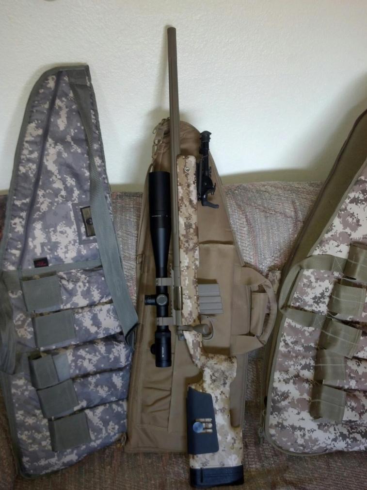

And this image is stolen off the inter-webs but it is exactly how I want the rifle to be in the end. I am curious to what contour you all think this barrel is.
It looks a bit thin but still looks good.

The end result.
Well here she is finally! Wasnt a cheap build by any means. Still needs a few things like a sling and data cards.
Edit! Forgot the Parts list!
Rem Action cut and trued with custom bolt handle
M40 Brux 1:8 @ 26" Threaded 5/8x24
Mcmillan A4 USMC spec in Digital Desert
Vortex Viper PST 6-24x50 FFP MOA
PTG Bottom Metal with Alpha type 2 mags.
Seekins 20 MOA Base
Seekins Medium Rings
Timney 510 set at 2#
Badger Bolt Knob
All metal work cerakoted FDE
Looks great man!! How you liking that Vortex?
Oh, and here's the picture made easier to see:
Hey thanks! Its come along well. I'm not sure what I think of the Vortex yet, haven't gotten it to the range yet... although that may happen tomorrow with barrel break in!

S12A, yeah, so far I like it but I haven't even been out to the range with it.
Maybe today is the day though! I'm happy with my choice.
TRTAC, see post 36, I went with a Timney and m40 contour. It is a tank... weighs in at 15lbs ready to hunt but it is gonna be backpacked in my eberlestock until I get to a location to set up typically. The flush cups help with sling versatility too.
Other then that it will be a benchrest steel ringer and long distance prairie dog nightmare.
I know I could have gone lighter with a htg stock and light barrel but that isn't the picture I had in my head. If I wanted that I could simply just buy a typically savage long range hunter or simolar model.
I was going for the M40A3 look because its unique and proven to boot.
