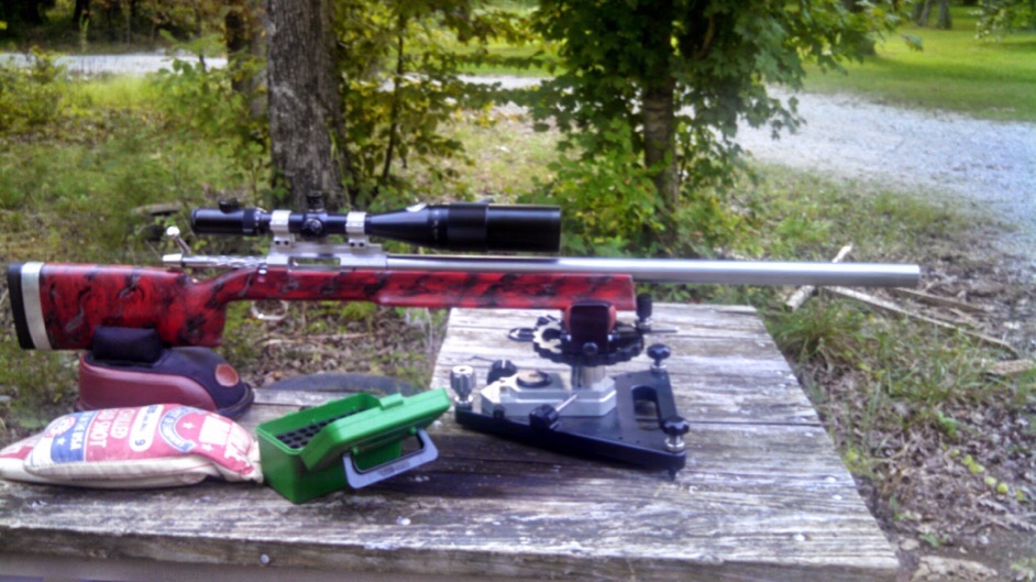

Well I managed to get back to the range this morning and run my loads over the chronograph ( Magneto Speed V3 ) the 75 grains of H-1000 and the 230 grain OTM Bergers averaged 2800 fps and at 300 yards this morning and I put five shots in under 1/4"
Next I tested the 208 grain Hornady Amax with 75.5 grains of H-1000 and the avg velocity on those were 2864 fps. They grouped under 1/2" at 300 as well so I am happy camper for sure on these two loads.

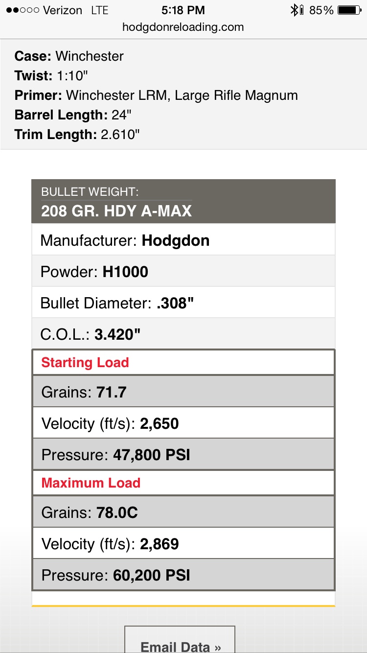

According to Hodgdon I'm running higher velocities for what they claim velocity should be with my loads. I'm not sure if I wanna try and push it much further like said I've been up to 78 grains of H-1000 and the groups were hovering around 1.5" and stiff bolt lift. My barrel is a Lilja 3 groove so it just may not like to be pushed hard and I think it's 31" in length
