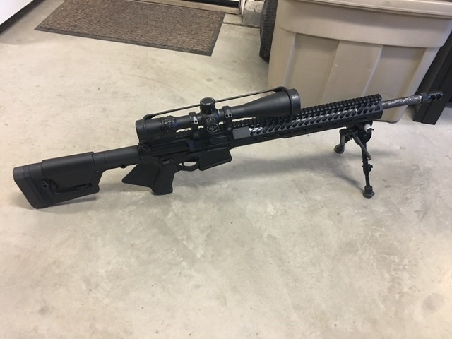

I got bored in march/april when everything was locked down and slow at work, so i cashed out a 100hrs of PTO and decided to build an AR10
Seekins Builders Kit... matching upper/lower and rail
Seekins Bolt/BCG
Proof CF .308 1/10 20” Barrel
Area 419 MB and Arca Rail
SLR Adjustable Gas Block
Radian Raptor CH
Geissele Trigger
Ambi Safety
PRS 3 Stock W/ Rifle Buffer Tube
Tubbs Wire Spring and Odin Works Adj Buffer
Put my OG NF 3-15 on it
Finally everything i needed to finish the build came in today, Barrel just showed up last week.

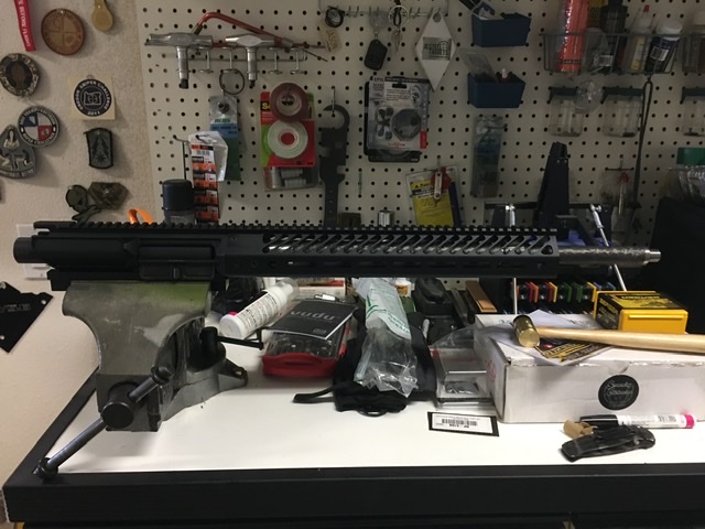

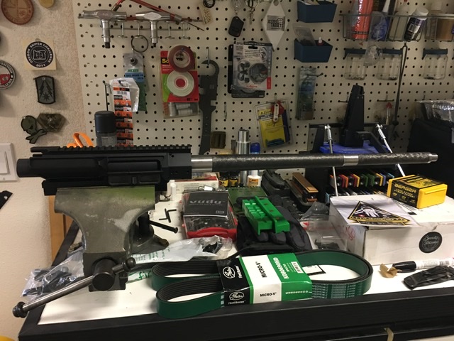

Used a Young Manufacturing ejector removal tool
I took the ejectors out of the bolt, used go and nogo gauges to check the head space.
Used SLR jig to put a second dimple in the barrel for the gas block
Got the gas block tube on and check fitment, all good
Used a Young Manufacturing upper receive block and got that barrel on and barrel nut tightened
Gas block installed on and set screws installed.
Rail installed and Muzzle Brake installed
Assembled and here it is ...
Seekins Bolt/BCG
Radian Raptor CH
Geissele Trigger
Ambi Safety
Assembled and here it is ...View attachment 7446609View attachment 7446610View attachment 7446611
