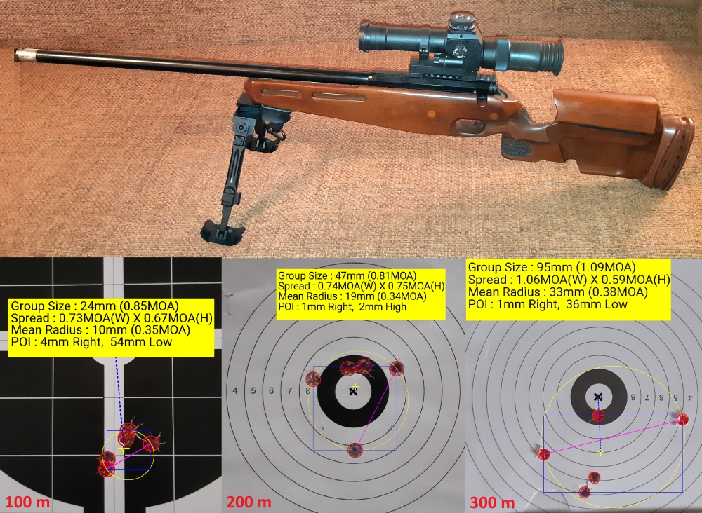

Last year I acquired an used Record-1-308 sport rifle - the gun is 20 years old, with some faults - the front and rear iron sights are missing, there are some scratches on the wood, no original documents and accessories. But the bore is in a very good condition so I decided to buy it and have some fun at the range.
It took me some time to get familiar with it, mount a scope ( the rifle has 11mm top rail so the 22 Weaver adapter was needed ), find out what cartridge suits the barrel best.
Since the Record-1 is the progenitor of SV-98 sniper rifle I decidet to mount on it a PS-07 scope, designed for SV-98. It is not an easy scope to use, especially for benchrest like type shooting.

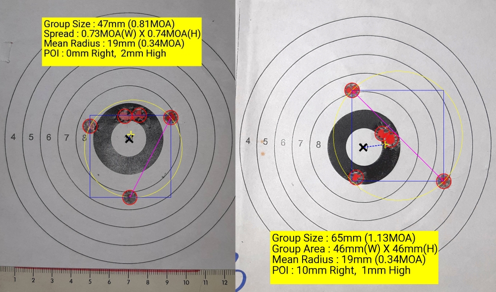

I've tested my Record-1-308 at few local shooting competitions at 200m and once at 300m. During the year I took part in 5 such competitions.
At the last one - last Saturday - I managed to shoot a 5-shot group with a size of 0.81 MOA and, despite the "dot" of the PS-07 scope covering the target in practice, I placed it more or less where it should be. It was the first 5-shots series and I am very pleased with it. In the second series it was a bit more spread out to 1.13 MOA, but overall I still got the best result by points ( and with 0,81 MOA by size ) at 200m in 5 starts in my club competitions so far.
Herewith you can find my shooting progress at 100m, 200m and 300m for 5-shot groups.

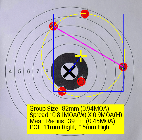

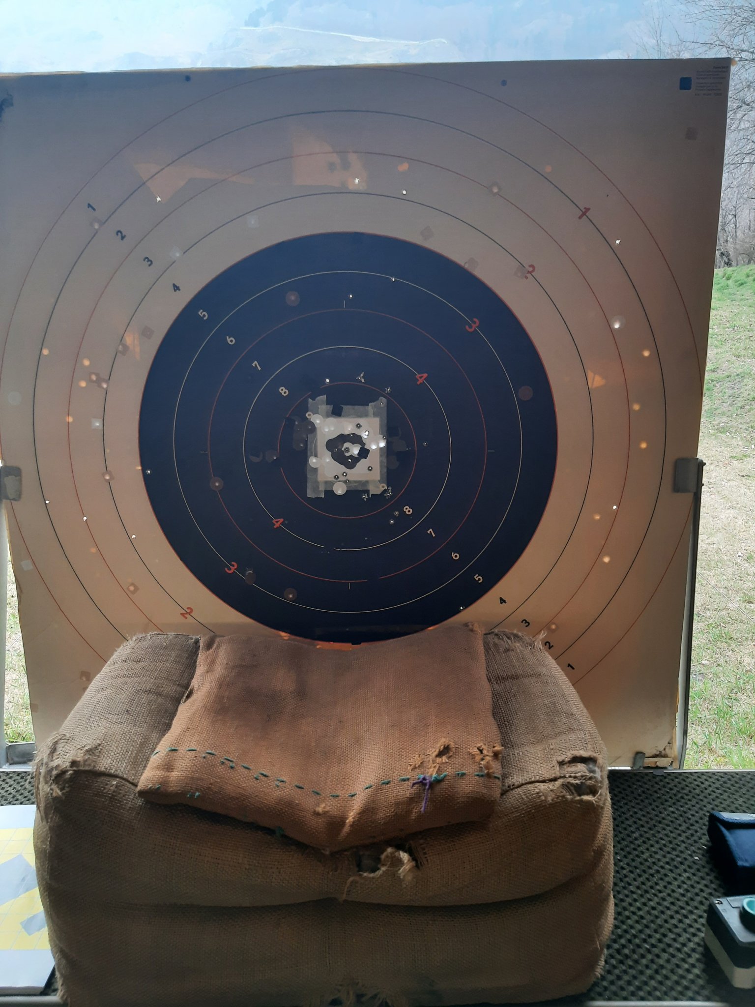

Only after 4 months I managed to go with my Record-1 to the shooting range again. Slight but a progress has been made since then ( no training or shooting in between - the rifle hasn't changed, so I'm the one who improves - good for me :LOL:.
I was able to get the 5-shot group size at 300 meters below 1 MOA :D
My new personal best - 0,94 MOA at 300m. ( the previous was 1,09 MOA )

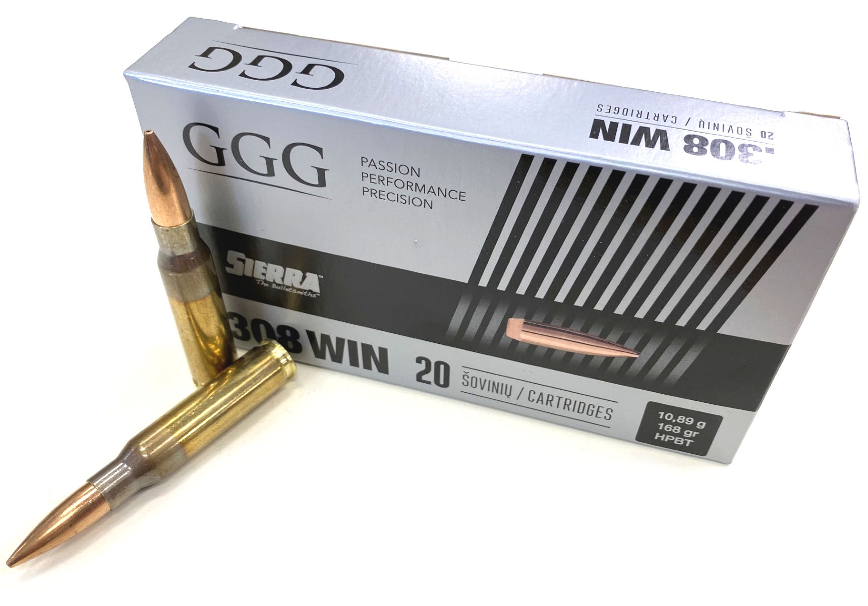

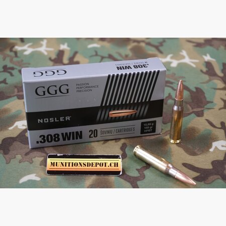

Factory ammo - Lithuanian GGG with Nosler bullet 168 gr HPBT
It looks great !
A more or less rare Rifle-model gets tangible..
By the way: the GGG .308 Win. 10,9 gr/168 gr Nosler-Match-Round makes also a good first impression in my rifle :)
A Muzzle Velocity of 821 m/s resp. 2`693 f/s.

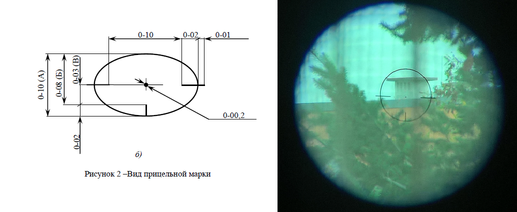

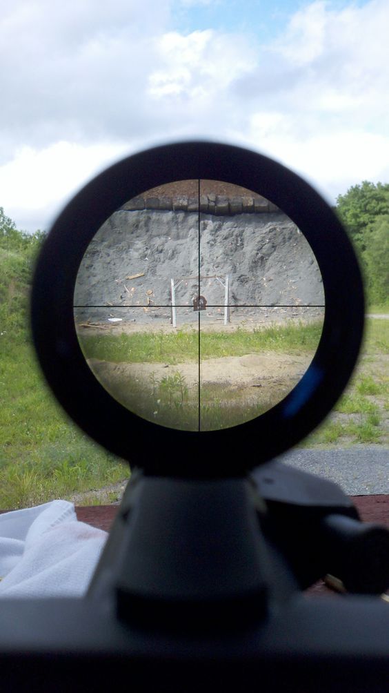

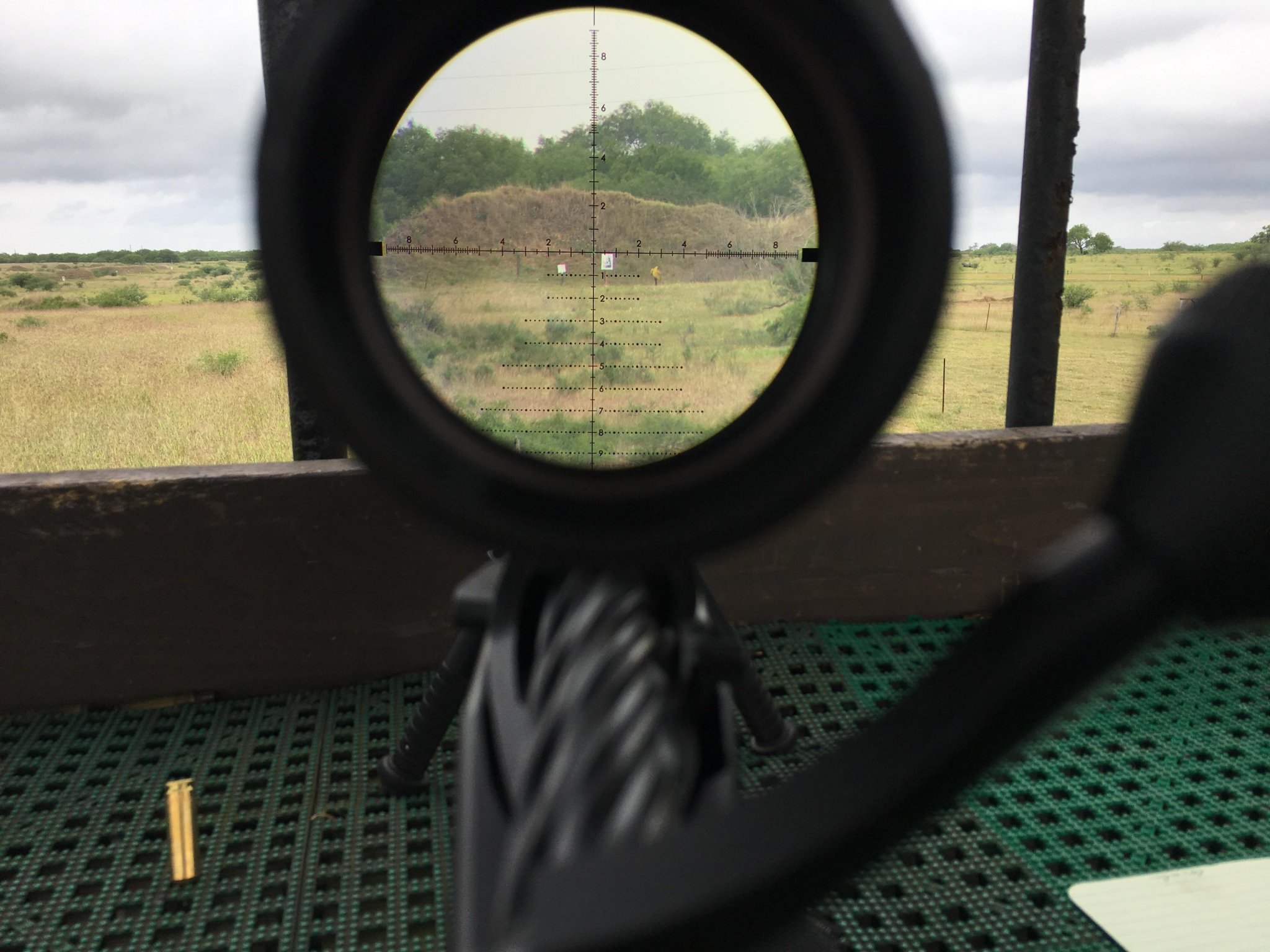

What about a Viewthrough of your scope, please ? :unsure:
The reticle of PS-07 scope is the tricky part - the aiming dot has a size of 0-00,2 thousandth of radian, which at 300 meters is 60mm, while the diameter of the "9" ring of the target I was shooting at is 39 mm. So the target centre - black ring of the "9" - the only visible at 300 m reference point by which I should aim was fully covered by the aiming dot :oops: That was tricky.
But I like the PS-07 anyway and it will stay on the rifle.
The photo was taken with a phone, with a view through the curtain in the window, so the view seems blurry, but in fact it is quite clear. The distance to the building in the photo is 100m.
This GGG-Load is the only ammo you tried out im your Record 1 so far ?

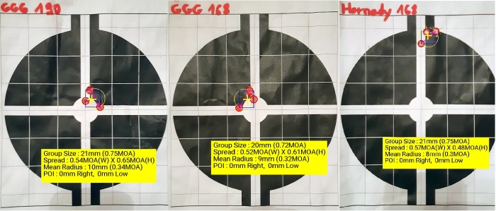

I've tested several cartridges. My first visit with Record-1 to the range was in January 2023 - I came across terrible weather, sleet, with very quick condensation of moisture on the lenses of the sight and the spotting scope - open, outdoor range - hands froze instantly :oops: - despite that I decided to give it a try, but shoot only small groups of 3 rounds.
Those groups at 100m ( Hornady 168grs BTHP, GGG 168grs Nosler, GGG 190grs Sierra ) are not so good but taking into account that it was the first time I shoot this rifle and the weather conditions I consider it a good initial test which led me to the choice of GGG 168 Nosler HPBT - quite good group size - 0,72 MOA, lower price than GGG 190grs with Sierra bullet, with slightly better group size than GGG 190 Sierra ( 0,72 vs 0,75 ). That is why now I shoot with GGG 168grs Nosler.
Other factory ammo – S&B 147grs FMJ, S&B 175grs HPBT, PMC 147grs FMJ gave > 1 MOA group.

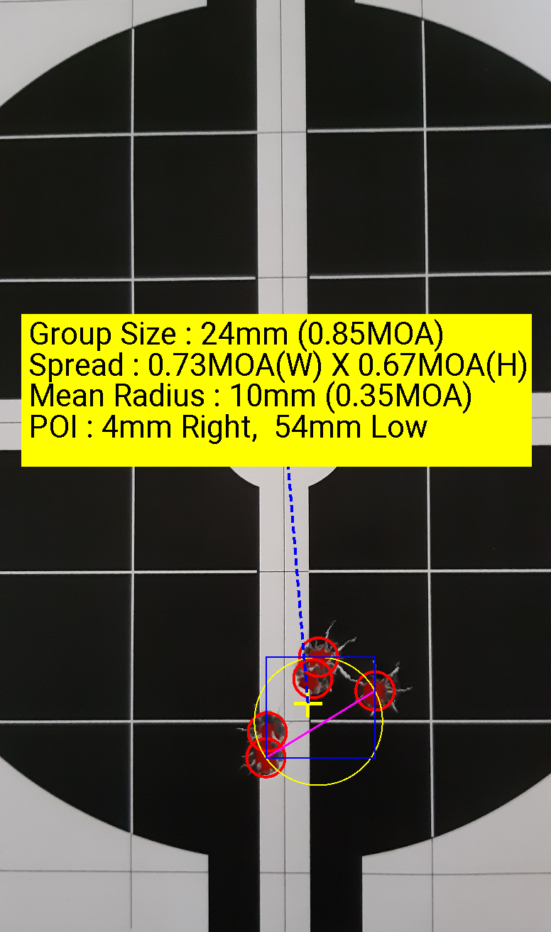

But I've tested also my own "home, hand made" ammo, manufactured with the use of Lee Loader and the hammer :D
It gave a 5-shots group at 100m with the size of 0,85 MOA - bullet: Hornady ELD-M 178grs, gunpowder - Czech Lovex 73.6 ( 41,15 grs ), primer LR Fiocchi, OAL : 72,25 mm.
I've already posted the photo of that group but herewith please find it again with the proper description :
100m, reloaded ammo ( Lee Loader + hammer ):

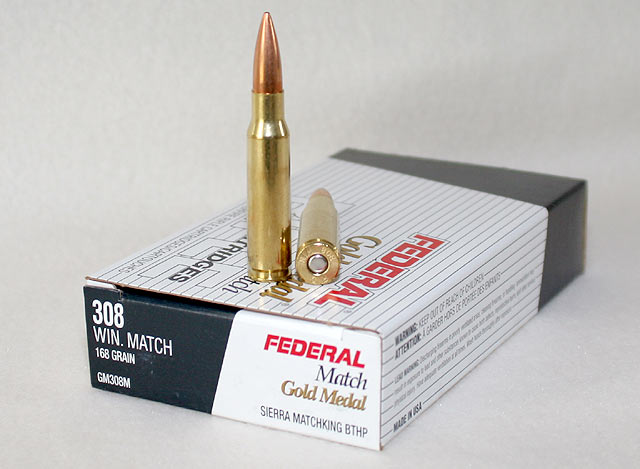

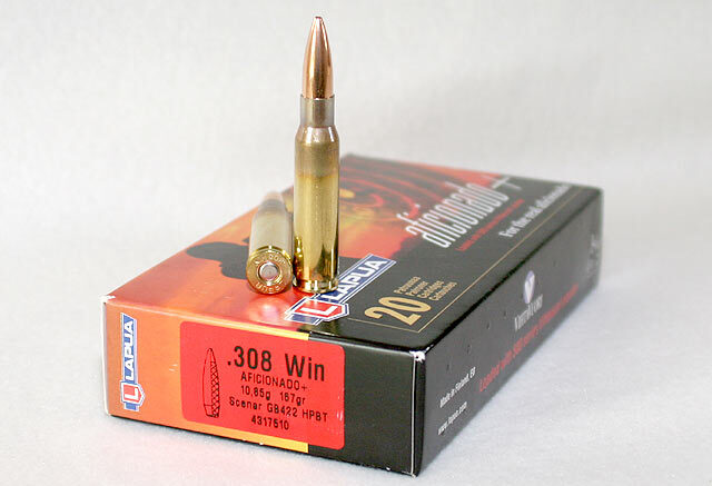

It looks great (y)
Yes, I see you did already quite a lot of shooting, PMB27
What about the "classic" 168 gr-Federal "Gold Medal"-Match, Norma "Diamond Line"-Match, Lapua "Scenar"-Match-Rounds ? :unsure:
They are well known everywhere, I got the impression.
I've no idea how the offerings in Poland are today... ?

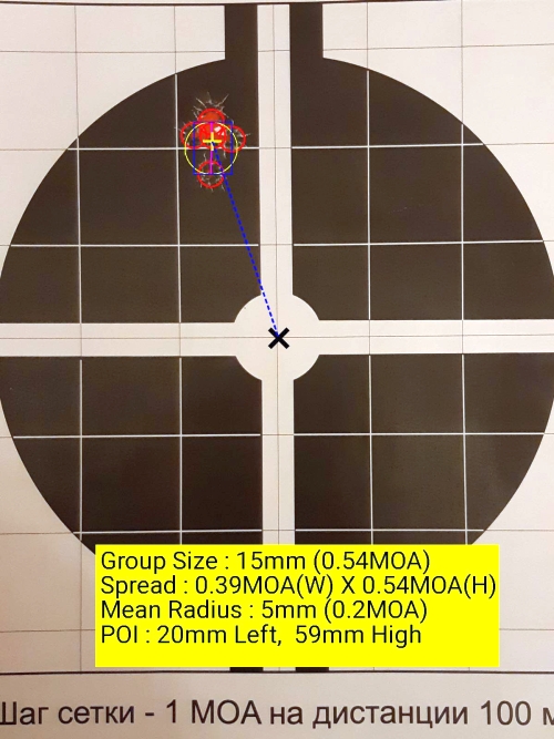

Today's trip to the shooting range and two very good news :)
First - I managed to get a 0,54 MOA group of 5-shots ( new personal best ) at 100 meters.
Second - it is my own - home made ammo :D - bullet : Nosler CC HPBT 168gr, powder : Lovex 73.6 - 43 gr, primer : Fiocchi LR, case : S&B.
[ I did not change settings of the scope - they were from the previous shooting at 200 m - that's why the POI is 2 MOA higher than POA ].
So I think the Nosler CC 168gr HPBT is my sweet bullet. I do not know my sweet load yet - I just reloaded only 5 cartridges based on the calculations of the GRT program with a charge of -15% from the maximum pressure.

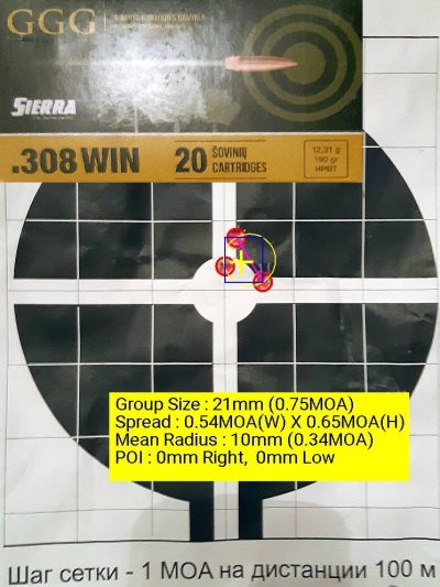

At the beginning I tried GGG 190 gr Sierra HPBT - that initial test was very rough and not very reliable beacues of just 3-shot groups, but as a result I chose Nosler 168gr because its 3-shot group was the smallest. I posted earlier targets from that test.
Here is the 190 Sierra 3-shots group

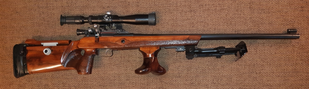

I haven't tried "the GGG sister load" with Sierra M-K 168 gr bullet and I'm affraid I'll not do it in the near future because I started cheating on Record-1 with my new love MЦ-13.

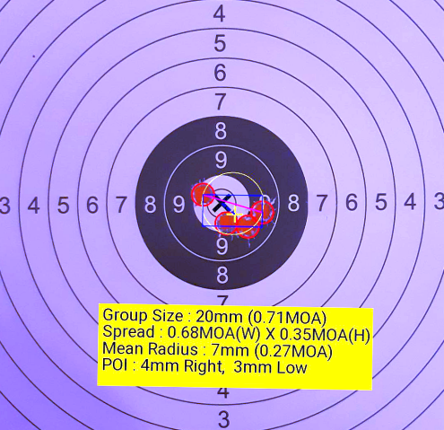

We started our love affair with the factory Soviet ammunition - Целевые патроны улучшенной кучности - at 100m a 4-shots group with the size of 0,71 MOA.
I hope that we will passionately reduce these groups even further

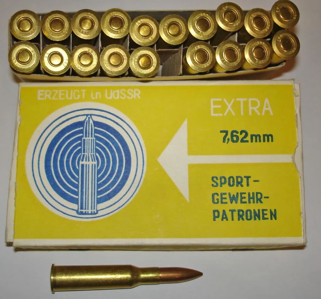

That looks really impressive, especially this 190 gr GGG-Match-Group. We should say it should be possible resp."legal" to calculate the 5 Shot-Size. Then we have here a 35 mm-Group, as a result from 21:3x7. Your Record 1 uses a 12 inch-Twist, not ? :)
Your "second love" - your cheating ;) - is also pretty.. . Which ammo, bullet weight was it here, please ? There are several 7,62 x54 Russian-Loads in case.. . Or is this also a .308 Win.-Chambering ?

Recrd-1-308 has 320 mm berrel twist ≈12,5 inch.

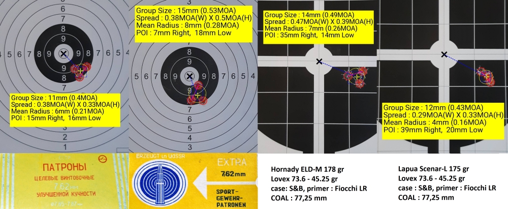

As for МЦ-13 - it is 7,62x54r - allow me to direct you to another thread where I described my short but passionate rendez-vous with Mts-13 accompanied by factory and reloaded by me ammo - https://www.snipershide.com/shooting/threads/super-rare-tula-mts13-1.6931538/#post-11580362
That is the result of that date ;)

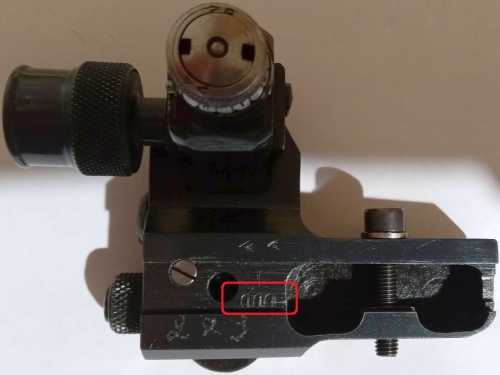

Does anyone on the forum have any knowledge about Soviet/Russian additional numbering of weapons and parts? Under the serial number of my Record-1-308 there are additional markings – three digits eventually punctuated by three zeros.
On one of the Russian forums I found quite imprecise and vague information that such a marking system was used for individually manufactured weapons/parts that differed from a factory production. That reference concerned the diopter sight for the MC-13 rifle with the marking "000" which would indicate that the sight was individually manufactured with characteristics for a specific athlete.

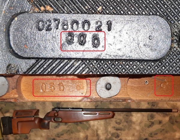

If that explanation is true then what three zeros could indicate on my Record-1-308?
The stock of my Record-1 has different number than the rifle - 056 and also a digit "2" is stamped twice.
Different number of the stock indicates that it probably was taken from the other rifle and put together with the iron 02780021 but "000" under the iron serial number? What could be the meaning of "000"?
