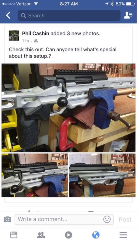

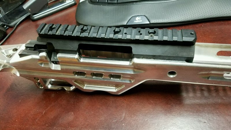

Well it happened folks. I'll post more when ithe gets here next week

not interested in selling the original chassis or the new setup. the original chassis would be useless to anybody not shooting an ai because of the square action. it's my understanding that phil will have this as a inlet option very soon
I think it looks it great. It may be the most expensive barreled action ever, but you have some pretty big balls to do that to your AT. I think you'll love it. I can't wait to see the completed pics and hear how you like it.
Did MPA just replicate the "bottom metal" of the AT to ensure reliable feeding? Is the action bonded into the chassis or just bolted in?
How much lighter will that final rifle be? I ask because I have been looking at the MPA for my Tikka .223 (I also have an AT) and the BA chassis I think is like 5.2 lb which is lighter but only a little bit than say an AICS chassis which is around 5.95 lb. I ended up going with the MPA BA Lite folder which is more like 3.5 lb.
As to what is special, I see a notch in your trigger guard…? Are you not going with a folder?
That really does look like a sweet setup!!
I haven't seen the AI chassis but I would imagine you could put it back in and glue and be just fine if you decided you didn't like it?
