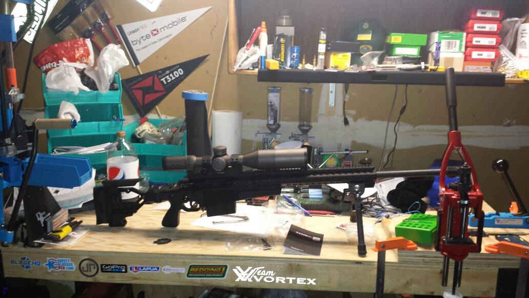

I have a brand new AX338MC 27 inch barrel with 30 moa top rail. I have a brand new Vortex Razor HD Gen2 4.5-27x56 mil EBR-2C. I have the scope sitting in a ERA-TAC 34 MM Adjustable INCLINATION, 37mm high Mount. The mount is set to 0 moa. The scope's elevation is turned all the way down to 0. The zero stop is untouched.
I shot at my 100 yard target, walked down to look at it and I didn't hit paper. Asked some guys at the range to watch and they told me I shot 3 feet over the target.
What am I going to do? I can't bring the scope down any more.
Bought the whole system from EuroOptic but they are closed for the holidays.
Advice? Was planning to shoot 1k tomorrow Labor day holiday but I can't even zero the rifle.
Advice appreciated,

Can the mount be reversed front to back? If so, then turning it "up" would in fact be turning it down,which might get you on paper until you can figure out what is going on.
I live in Silicon Valley and only have access to 100 yard ranges for most of the time. Also 200 - 300 yards is not a lot of angle for 338. 3FT is a lot of deflection!
I'm not familiar with the Razor, but it sounds like you need to disengage the zero-stop and reset your elevation turret. It may have been set "higher" within the range of adjustment from the factory.
I think the zero stop is the only chance I have got. It is set to zero from factory. I don't know how many turns it has. I have to unlock 3 screws to adjust it.
Maybe you could check a ballistic program for your load. Look for the entry that is 36moa over a 100 yd. zero. That is your range that you are on at the present setting. I hafta hold a mil low to hit at 650 yds. with 338 LM/250 , scope bottomed out. Don't normally shoot that close though.
You can look up how much elevation travel that particular scope has and then compare it to how much travel you are able to dial in your current configuration. If you are not able to achieve the scopes potential, then reset the turret.
OK Take a deep breath. If you mounted the scope your self I think it is not sitting straight in the rings. I would pull the scope out and remount it taking particular care to tighten each screw a little bit at a time and making sure that the ring gap on each side stayed about the same using feeler gauges (or playing cards).
Before you send any more of those five dollar rounds down range, remove the bolt and sight down the bore--center the target--then adjust the reticle so it is centered on the target. That should get you on paper.
I can't shoot until tomorrow but even then it is not on a bench or perfect precise ranges. I was able to turn the zero stop down... 18 mils down so there is some hope. I didn't mount the scope, pro did it, at this point I don't suspect it.

If you were able to dial down an additional 18 mils then you should be fine. You can semi-confirm using the method stated above (looking down the bore). If you can sight out to roughly 100 yds. From the house see if you are able to align your reticle with sight picture thru the bore

Power stroke I think you are correct. I am just hoping that I the 18 mils I went down in the zero stop will be enough. I read the manual and there was no mention that the starting position of the zero stop would be high. I just didn't have the means to adjust the zero stop at the range and now I don't have 100 yards available. I think I don't need any more assistance, I will need to head to the range one more time to get my 100 yard zero or the bore sight. Whatever happens first.

The OP is back! I am pleased to announce that my AX will shoot! All my equipment is running well and I am very pleased. Bottoming out the zero stop solved the problem. I went out to BLM today and was able to easily hit a three hundred yard target by actually adding some clicks up on the scope. I still want to get a 100 YARD zero since it is the range that is most available to me. I understand that shooting 100 yards is pretty silly with this gun. Someone on page three figured that I don't reload, well I do. I reload 9mm and 357 / 38 / 223 on my Dillon 650 and hand load my 308 & some 223 with my Forster Coax. Now I have recently purchased all the dies for 338. My advice, don't get into 338 unless you are a mint and can print money. The equipment alone is ridiculous. I am estimating that my cost is $4 a pop or basically a gallon of gas. I am not reloading for cost but accuracy. I would like to shoot out to a mile accurately and I have made my investment in the AI chassis. I am eagerly awaiting when the small action conversion kit comes out so I can start shooting at $1 a pop. Next step is to get the 100 yard zero and build a ladder which I think only makes sense to conduct @ 200 yards. Unfortunately for me, I have to wait for the 4th Sunday of every month to have access at the Metcalf range near my house. One last thing. I didn't waste a ton of ammunition today getting frustrated. Total shots down the tube is 7 or $28. Keep the epic thread alive.
