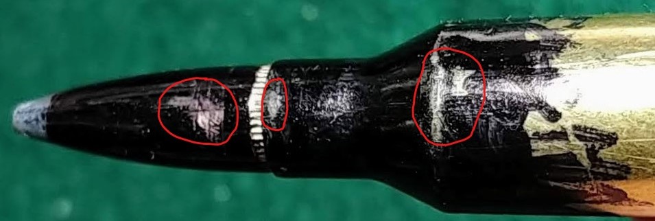

Carbon ring in the throat? Take a Sharpie and run a couple of longitudinal stripes from the tip of the projectile down past the shoulder (of a round that won't chamber), and try to chamber it. Like, *really* try. No need to break out a hammer or a cheater bar, but give it some elbow grease.
Then pull the cartridge, and see where the Sharpie marks have been worn.
Reactions: Longguns
I got 3 marks: on the bullet in front of the crimp; on the neck at the crimp; and on the shoulder. All marks at 3 o-clock. Solvent and brush cleaned before doing this.
Was that directly opposite of the ejector? AKA, was the ejector forcing the left side of the case forward causing it to drag on the right side on its way out?
Good call gents. The marked ink was due to ejector dragging against the right side. So I'm back to square one.

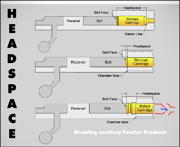

  • Belt to face: (12) casings fit nicely with min 0.2170", max 0.2220" headroom.
  • Belt to face: (26) casings don't fit with min 0.2225", max 0.2305" headroom.
  • Case diagrams from the internet have the headroom spec at 0.2200".
Therefore, it appears my chamber allows only 0.002 over spec for headroom. I have no idea if that is reasonable "slop" for factory ammo. At least most of the Federal is in spec versus only one of the Winchester cases.
What do you guys recommend I do? Return the "bad" ammo and exchange for (insert your favorite ammo here)?
I appreciate the advice!
a quick check - if you can find someone who has an appropriate set is to check the action with go/no-go gauges - or even better yet a set of headspace gauges to determine if the chamber has been made the right size and the headspace set correctly - it's starting to sound to me that only slightly undersized cartridges chamber properly for you - suggesting slightly under dimension somewhere in the chamber/headspace - not a common problem in a new rifle, but certainly not unheard of either
This rifle is around 25 yrs old and I haven't had this issue until recently. Logically, the only possibilities are: carbon fouling at neck or shoulder; brass fouling at head; brass fouling on bolt face or lugs; ejector malfunction; ammo out of spec.
So far, I have ruled out: bolt and ejector; carbon ring. There is the color of brass on the lip of the head so I need to get the right tool to clean that. However, even if there is a couple thousandths worth of brass on the rim, my chamber headspace is currently 0.2220" which is .002" larger than spec. I have almost a full box of Winchester ammo that needs between 0.2240" and 0.2305" or greater to fit (Gander Outdoor will take it back for full credit).
So I am left with this question: What is the reasonable, or allowed, deviation from spec for factory ammo?
