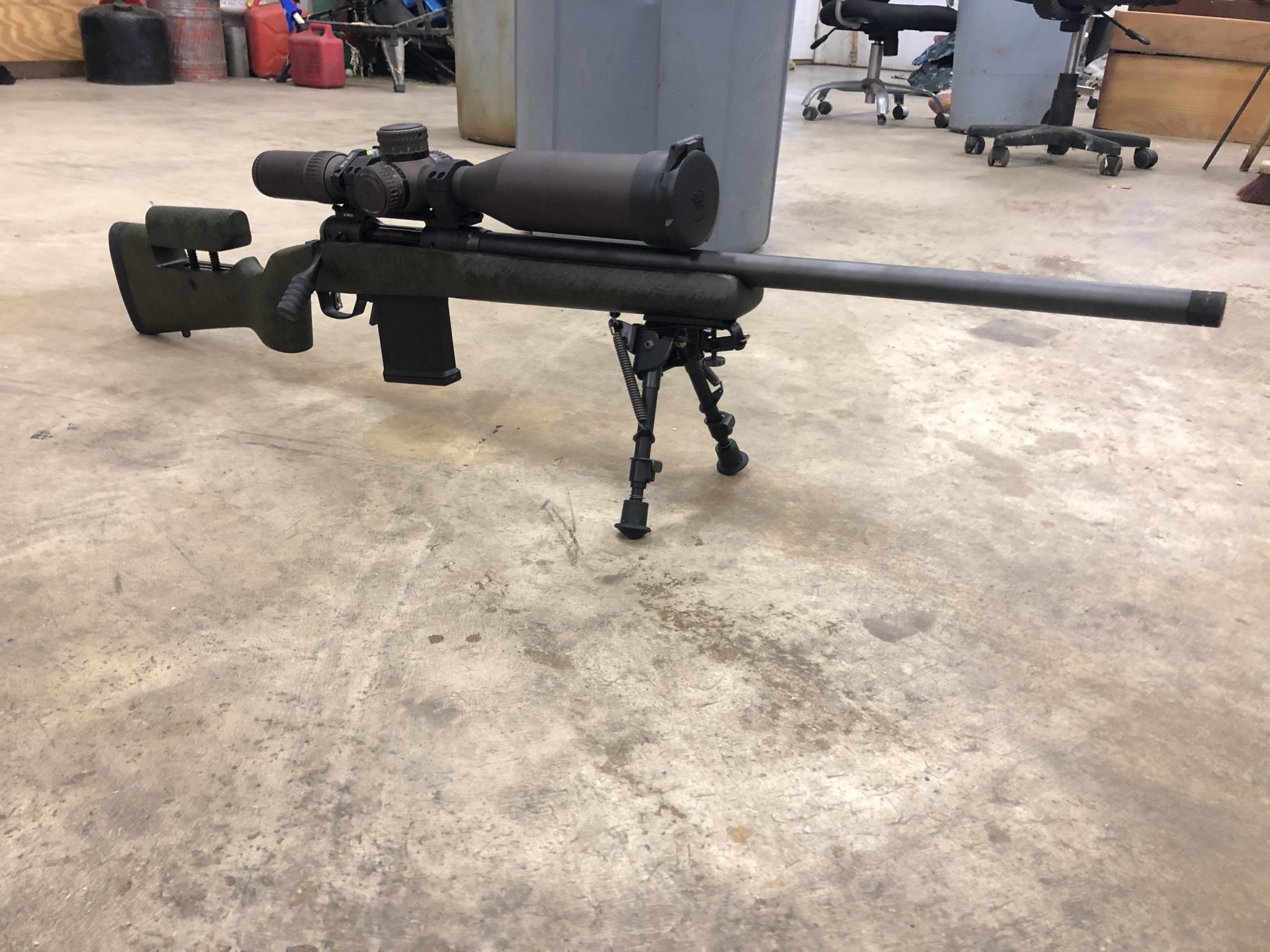

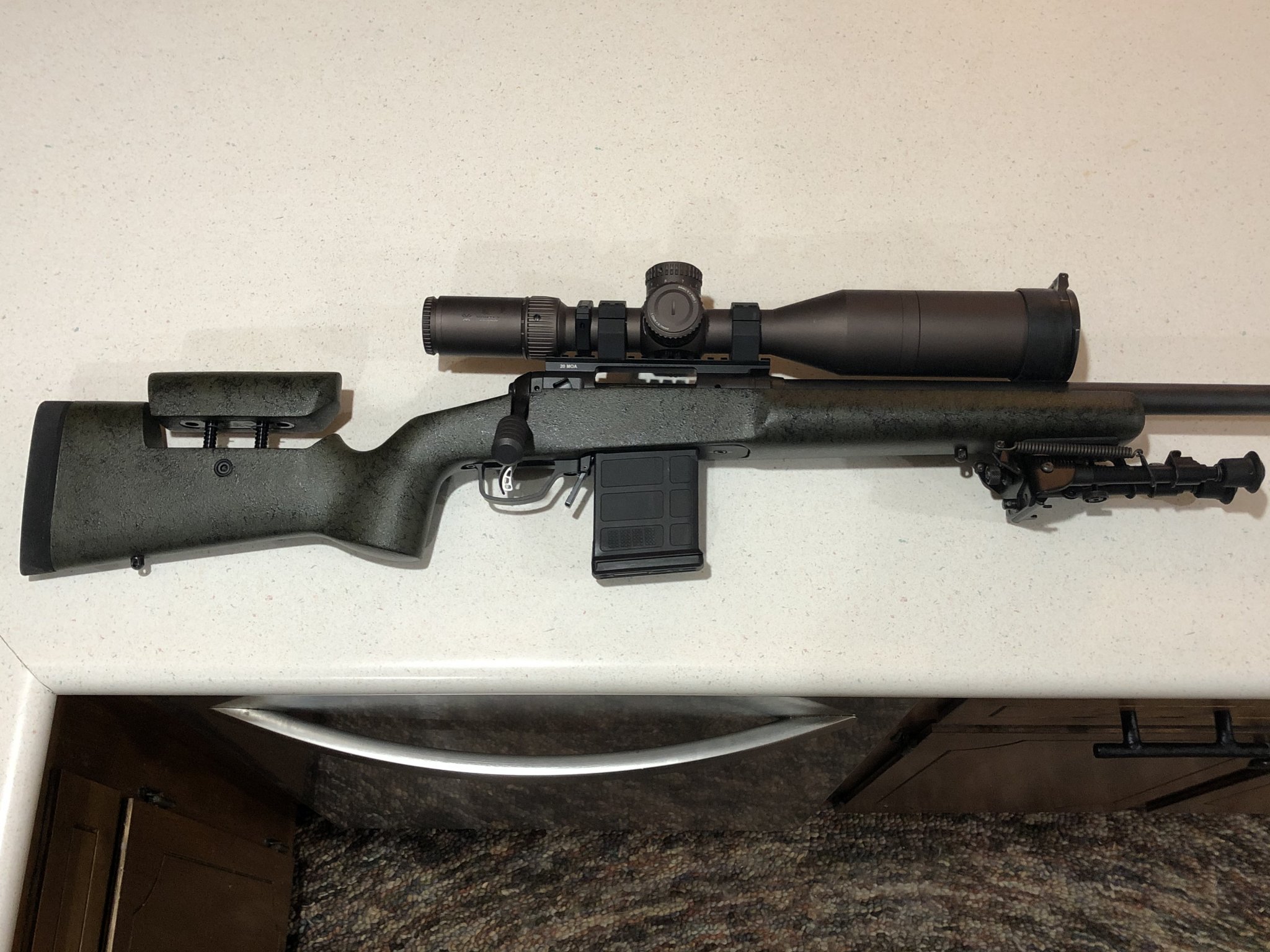

    New member here, and first dive into precision/long(er) range shooting. .22's and AR's have kept my interest for a long time but recently I've wanted to get into longer distances. I bought my first property 2 years ago and now have a kid on the way, so as much as I would love to own a custom action, I decided to try and keep this little project as "budget" as possible. This allows me the most time for actual shooting, as opposed to saving up and buying piece by piece...and it also gives me the most money for ammo.
    Anyways, picked up a Savage 10sba in 6.5cm a while back on sale(ish) for $380. 24" threaded barrel, 20moa factory scope rail, etc.
    Topped it with a Razor II 4.5-27 w/ EBR 2C reticle. Picked this up in a trade, and while I understand this isn't a "budget" scope, I technically only paid $800 for it ($700 for the scope I traded for it, plus $100; came with mount)...which is obviously a steal and I'm not passing that up. So I'm counting it as $800 lol... which is budget-esque precision scope price. I did pick up some Vortex PMR 0.92" rings off here to bring the scope a little closer to the rifle. The 0.92" rings DO fit, with the sunshade and Defender cap on...but it is close.

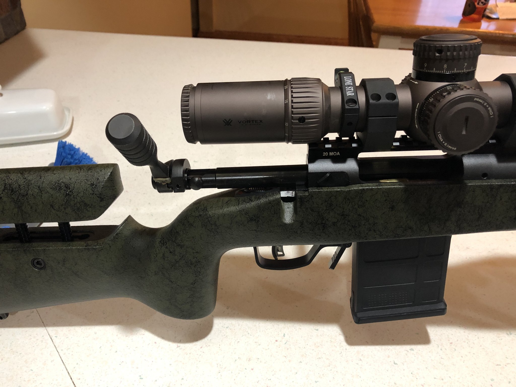

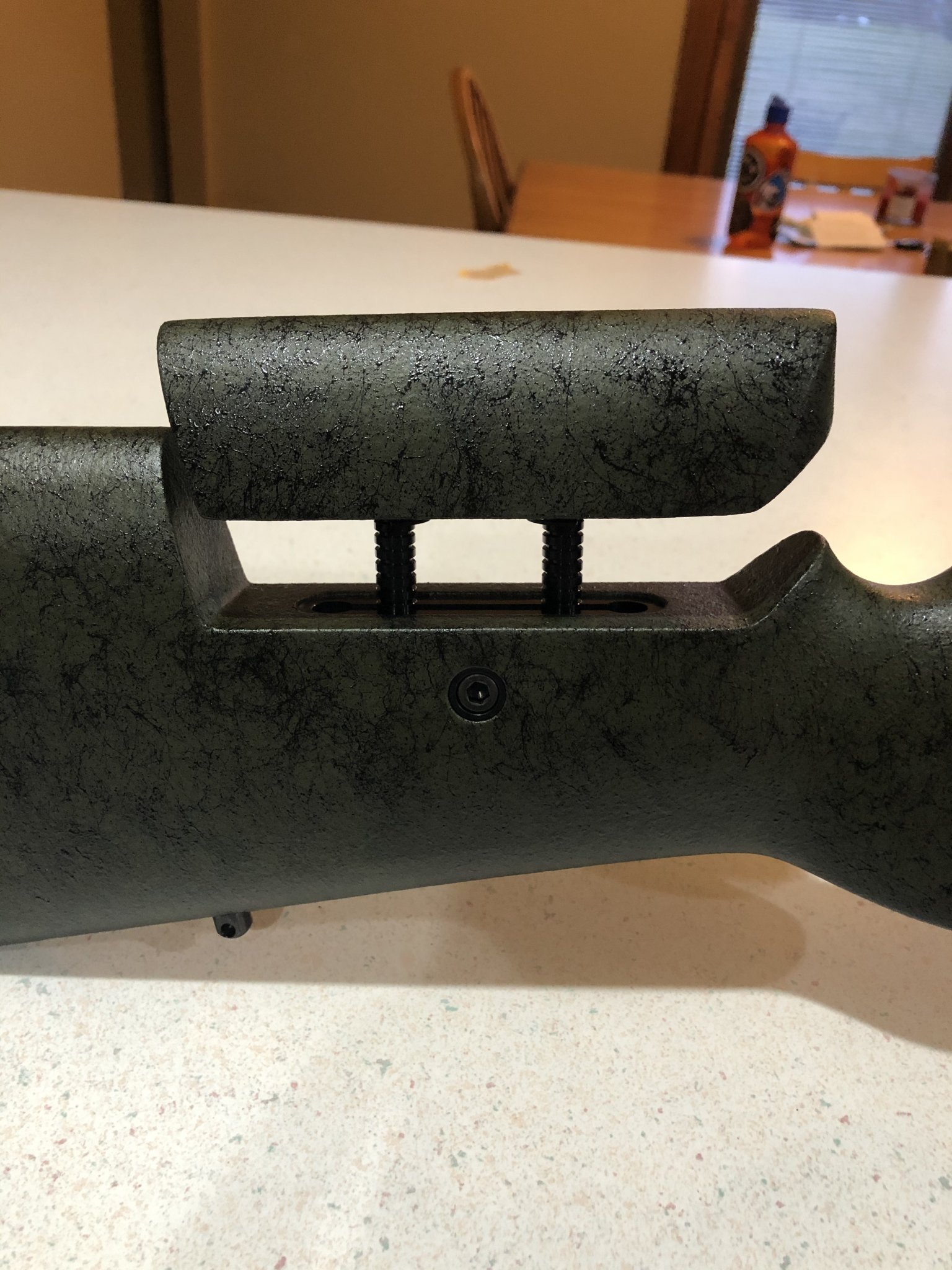

    It came with the obvious Tupperware stock, so I picked up a Bell & Carlson Medalist 6 stock over Black Friday sales for $373. The Savage 10sba is a blind magazine model, however after talking to Jeff at CDI (before he passed), I bought the Medalist 6 which is fit exactly for the Savage factory DBM, which is what CDI bottom medal is modeled after.
    I was fortunate enough to find a used Savage 4.4" CDI dbm here on the forum, and bought that for $125. Coupled with a Magpul AICS mag on black friday for $28, I've got a good base to work with now.
    I really contemplated picking up a Manners T7 or T2 that was in stock on Manners website, and prefit for the CDI for a savage...but I just couldn't pay almost 2-3x the money for a stock. Again, I'd rather have $500-$700 for ammo or diapers lol. So I went with the Tactical Medalist style 6 and I am pretty impressed honestly. I realized I'm newer to the precision rifle game, but I really like the feel and overall fit/finish of this stock. I'm sure a Manners or McMillan have their benefits and eventually would love one, but for now the cheaper option was the winner.
    The CDI bottom metal was almost a perfect fit. I did need to remove just a little bit of metal from the aluminum bed, on the inside where the CDI bottom metal magwell fits into the stock. Taking a little bit off at a time, I got a nice snug fit. The extended actions screws that came with the bottom metal were perfect. The rear trigger guard screw position did need drilled out in the stock, I used a 7/64 bit and it went in snug.
    The magpul mag works well so far, fits snug but easily removable and is a tight, but not difficult fit when fully loaded against the bolt.

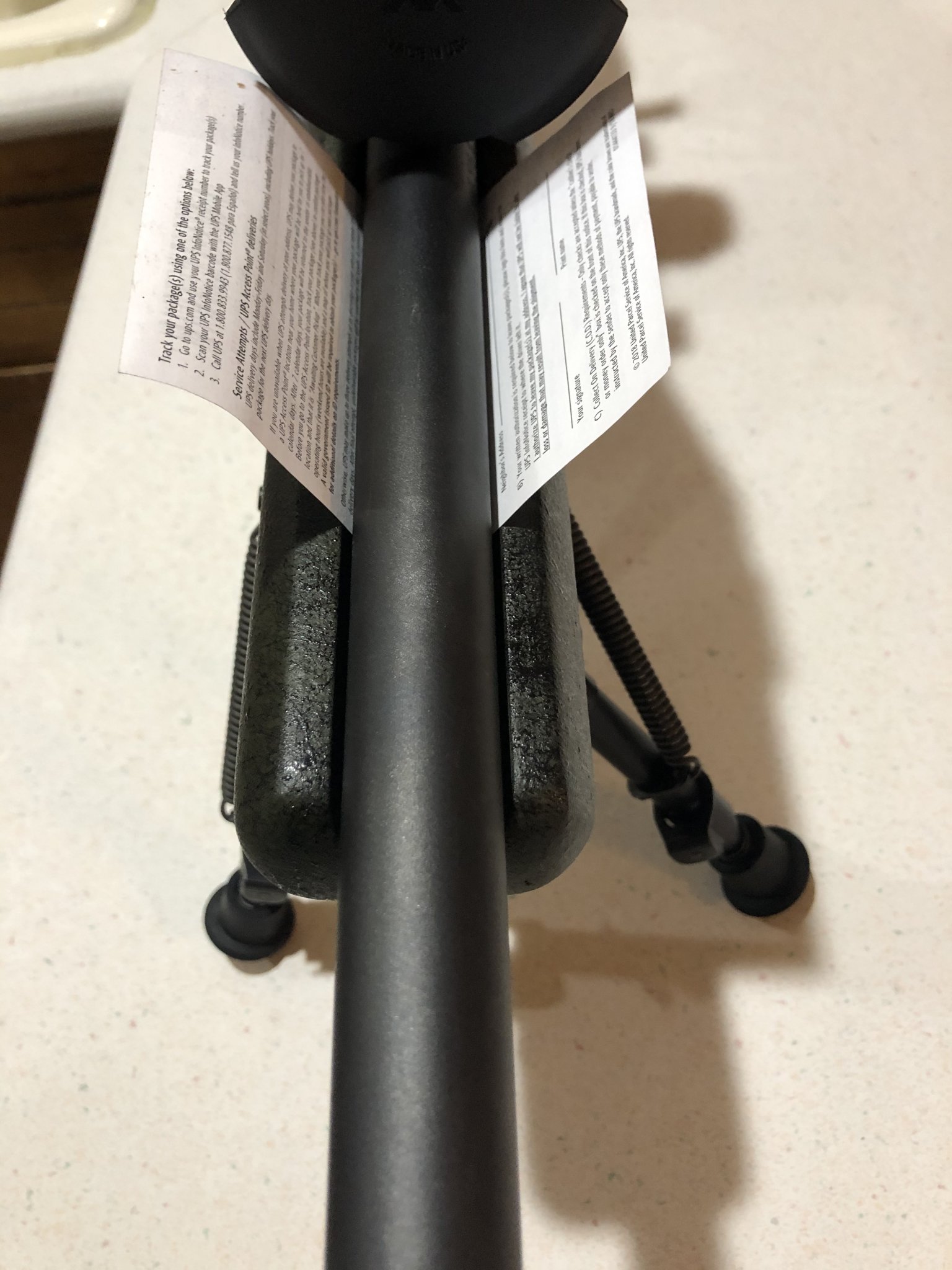

    Absolutely no modification was needed for the stock, or anything done to the barrel channel. It was a pretty much perfect fit. The stock comes with a 1in decelerator pad, and this model has the cheek riser. Two steel pins, with slots cut in them every 1/4 in or so run up and down the pins. There are two c clips in the slots, so you can move the c clips to lock the position should the cheek riser bolt fail. The comb riser is tightened and loosened by a single allen key on the side. It locked up nicely. I'll see how well it stays tight over time and usage.
    The barrel channel was true and straight, and easily free floated all the way up the barrel. There is a tiny bit of flex but you really have to push hard on the end of the stock. I can't imagine you would or could put enough pressure directly on the end of the stock to actually touch the barrel, at least not in normal PRS style positions.
    All in all I'm pretty happy so far. I have just under $1800 total in the rifle with all accessories and components. It really loves the factory 147gr ELD-M's and was shooting 1/3-1/2 moa 3 shot groups and 1/2-3/4moa 5 shot groups at 100yds. I'll be taking these out to 400-600yds soon at my family farm.

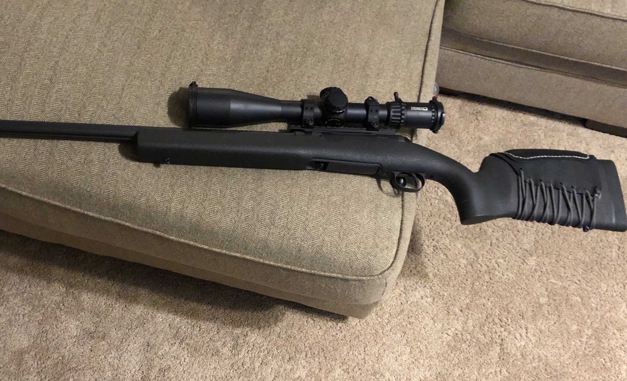

    It’s a bad picture but here is my model 12 LRP. It’s a great rifle. Setting in the factory HS stock. I put a Timney trigger in it. Steiner t5xi 5/25. Most accurate rifle I own. .220 is the best it’s shot at 100 yards.

    Great looking rifle man, those really catch the eye, especially from the factory like that. I'm pretty happy with the accutrigger on this thing so far. It seems pretty damn light to me for a factory trigger. Its noticeably better than the X-Mark Pro trigger I had on my old R700, at least to me anyways.

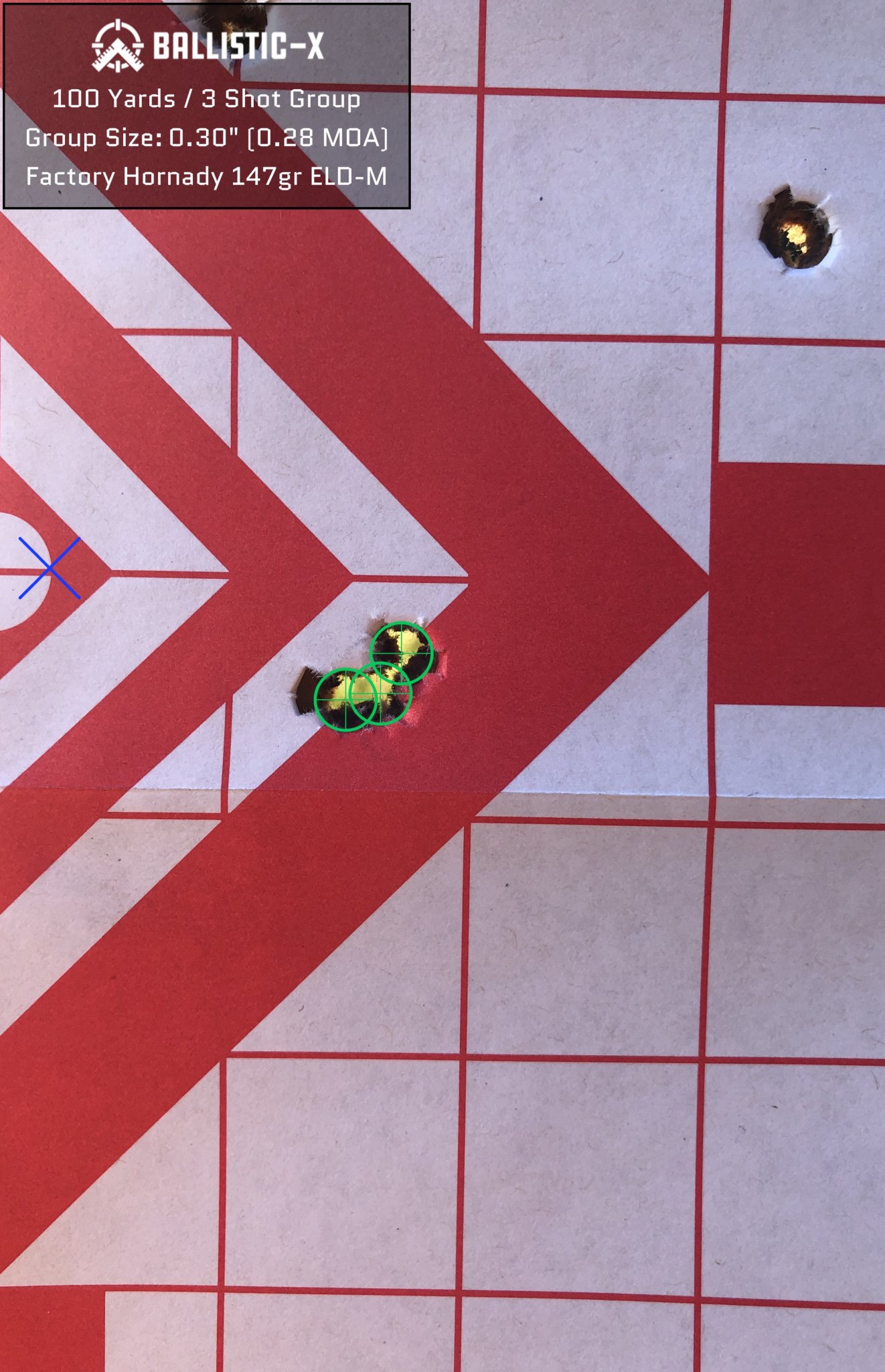

    The best 3 shot / 100yds I've shot thus far was 0.30". I'd love to be able to do that more consistently. I realize thats not everything, but its nice to see regardless lol. Hoping this stock helps my position and cheek weld more than anything. That factory stock was junk lol.

    I'm sure the B&C stocks aren't always great, and probably aren't quite as nice as a Manners or McMillan, but I tell you what, I'm impressed me for $370. Its definitely the nicest stock I've held that doesn't cost 4 digits. It will do well for my purpose. My next build I'll probably get a chassis to try that route out. This project I wanted to keep a little more classic.

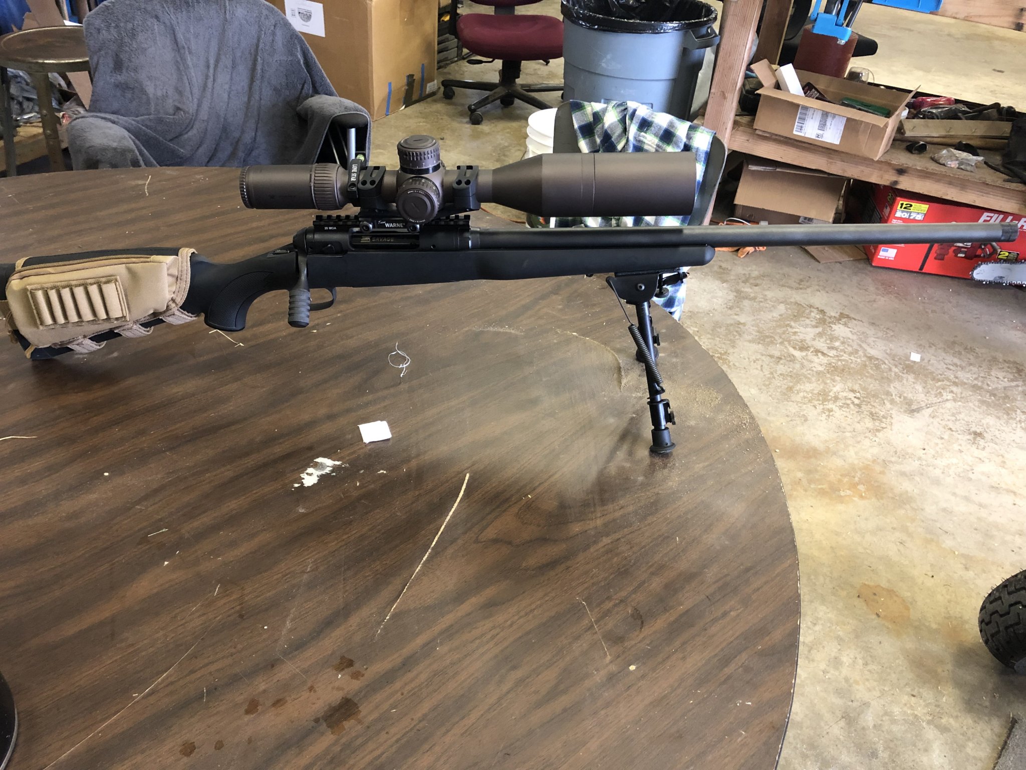

    This is everything I am trying and failing to do with my Savage .270. Got a takeoff Accustock for cheap and a PTG bottom metal that fits it, but doesn’t feed.
    do you know why it’s not feeding?
    Is the mag binding up/down?
    Are the rounds catching on something?
    bottom metal too tight?
    Possibly the bottom metal fits but isn’t fitting good enough to allow feeding?
    when I put the CDI in the B&C stock I almost kept it where it was after some initial sanding, but went back and worked it a bit more so the mag wasn’t as tight in the mag well. This made feeding better and taking the mag in/out better

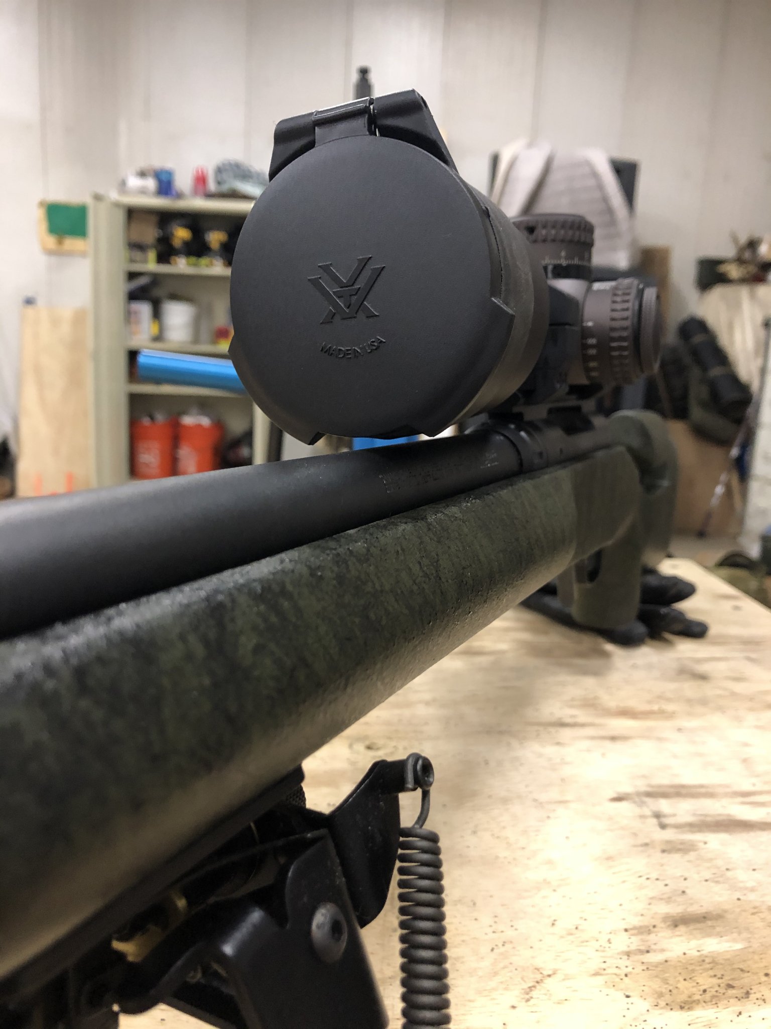

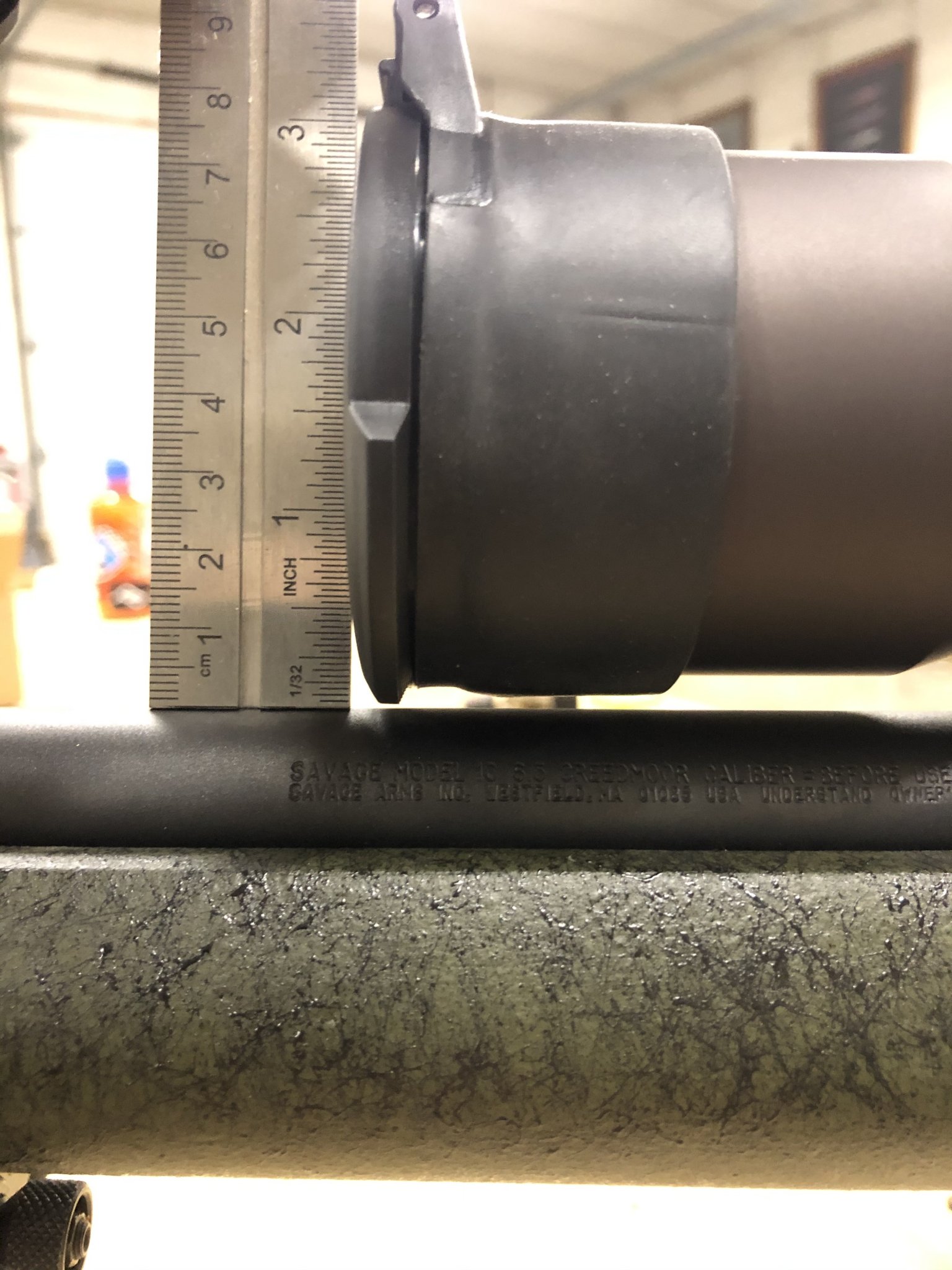

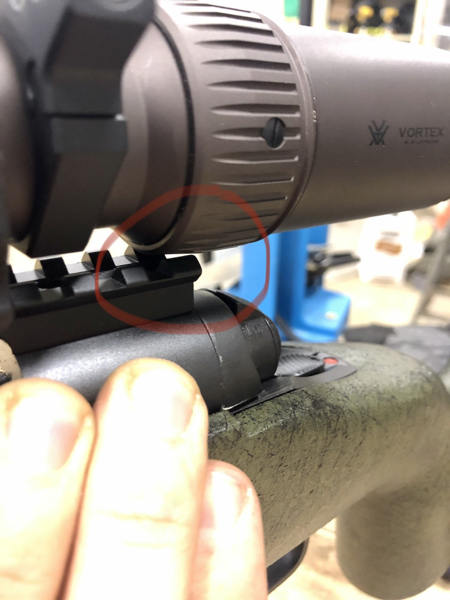

    Figured I'd throw this out there about the low rings and a Razor II 4.5-27x56 that I'm using on this rifle.
    I picked up the low Vortex PMR rings at 0.92".
    20MOA rail from the factory
    "heavy" barrel not sure what actual contour this is. Close to Rem. Varmint probably.
    Worth mentioning that it fits WITH the sunshade as well.
    The only caveat to all this fitting was actually the magnification knob. The scope is so low that the thicker magnification ring will only go so forward before it hits the mount. Luckily for me, the best spot was just before it touched. But for you tall guys and giraffe dudes, this could be a problem without adjustable length of pull.

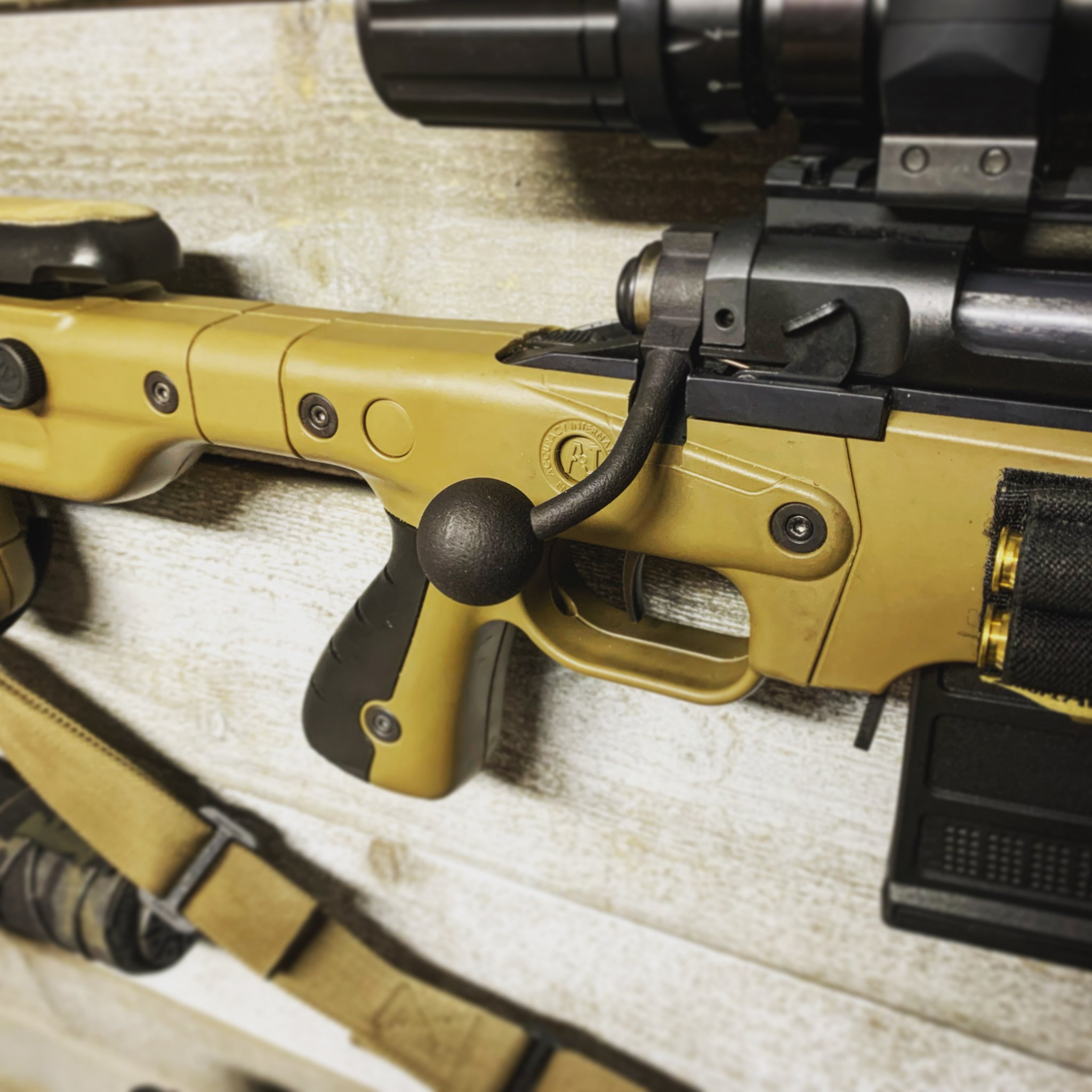

    Love my savage! I’ve got nicer rifles but this one has sentimental value and is a hammer! Check our our ELR rear bags to really squeeze accuracy out. I designed this bag because I was frustrated with every rear bag being the same- just a sack of beads.

    Where a magnification knob blocks forward mounting, an answer can be the next higher size set of rings. That's a good answer when adjustable comb height is an available option.

    The main reason I put the pictures up of the low rings was just for reference for anyone who wanted to see quality photos of that scope with the low (0.92") rings. When looking for rings originally I couldn't find any photos using them so I figured I'd put them up. You're definitely right, I could have gotten higher rings, but I got these for cheap and it happened to work fine for me. Might not work for a taller guy who needs the scope moved forward, and in that case taller rings would fit the bill.
