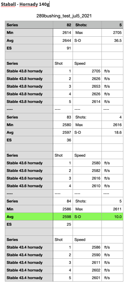

Sorry to spew but here are some of my reloading woes and queries.

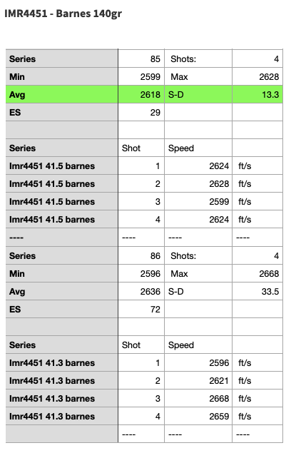

  • I was thrilled with my Staball in 6.5 creedmoor reloads. With 43.8 grains, I got the SD down below 10 and group size to 0.25". I tried IMR 4451 and had problems though. I tried full spectrum in ladder test and bullet seating. I could not get the SDs down below the 20s and 30s. Everything was loaded the same way as my Staball loads. Should I just accept its not working for me? At what point do you give up?

I ordered a .289 bushing from Midway ... I'll see what happens just using that and report back on whether it helps the IMR SDs alone. I'll try it with longer OAL. Noted on the Mandrel solution though. I think about making that just part of my regular process ...The process never ends, does it?

5) how did you develop the 4451 load? Normally, shooting rounds in ocw format can get you a best sd, as long as you are using Sd as your deciding factor and shooting 5 min per group.

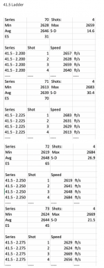

5) Ladder testing in 0.2 increments. I kept testing since orig post and when I went a bit over max found that 41.5 was pretty good. Just did bullet seating test follow up ...best one was base to ogive of 2.200 ... the other longer settings weren't quite as good ...see screenshot

I got to test the .289 bushing on my usual hornady brass. (@Supersubes!)(Recall I was using a .291 bushing before and was having an occasional loose fit ..where bullet wouldn't seat snuggly.)
First there was a noticeable increase resistance as I was seating. I also thought there was a slight increase in felt recoil - but not very scientific. Both these things logical I guess. I liked having more resistance when I was seating. I'm assuming tighter seating increase pressure when fired.
My previous best loads were with 140gr bullets were 43.8 of Staball and 41.5 of IMR4451.
Did a mini ladder with the 0.289 bushing. Best load for Staball was 43.4 (down 0.4 gr) with SD of 10. For IMR441 it stayed at 41.5gr (SD: 13). See screenshots.
Will repeat with .290.
Look at the 41.5 load of 4451. 3 of the shots were within 4fps of each other. Thats what you are wanting. Sd is important but es is also very important, while your sd numbers have come down the extreme spread is still very high. Because the extreme highs and lows velocity wise are what makes it hard to get a load to group. Be meticulous in your brass prep. Do the same thing to every case in the same order everytime. Might also want to measure your cases for water volume and group them together in similar volumes. All of the consistency will bring your es and sd numbers down into single digits or at least closer to single digits.
