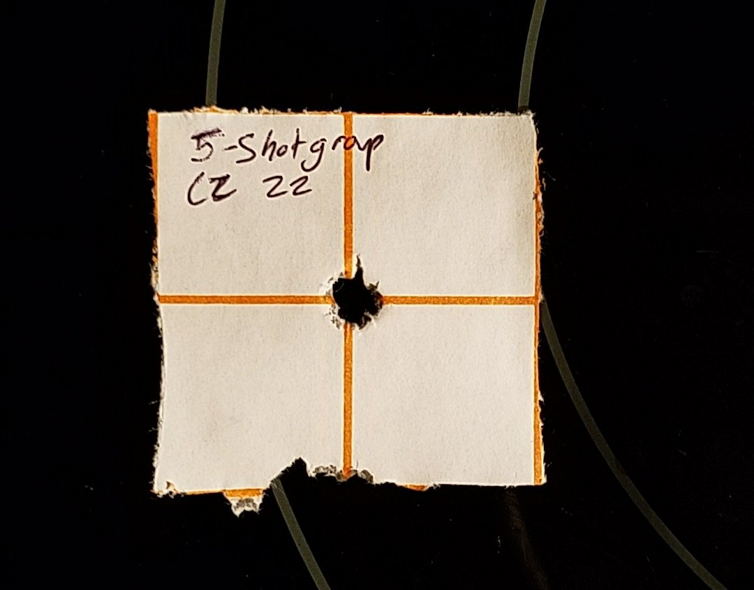

I have a that same rifle with the a trigger kit but no bedding or pillars and if I got lucky it'd shoot half inch at 40-50 yards with all of the expensive ammo I've tried. Wolf, eley, aguilla, gold medal etc.. so I started trying a few things differently. I removed my suppressor and tried all the ammo over and it loves the GECO ammo. Shot a 1 hole group almost instantly, then followed it up with a 1 hole group. I would recommend them for the 455 tacticool. They are cheap, and definitely worth a try. I'll post a pic of them and my group below

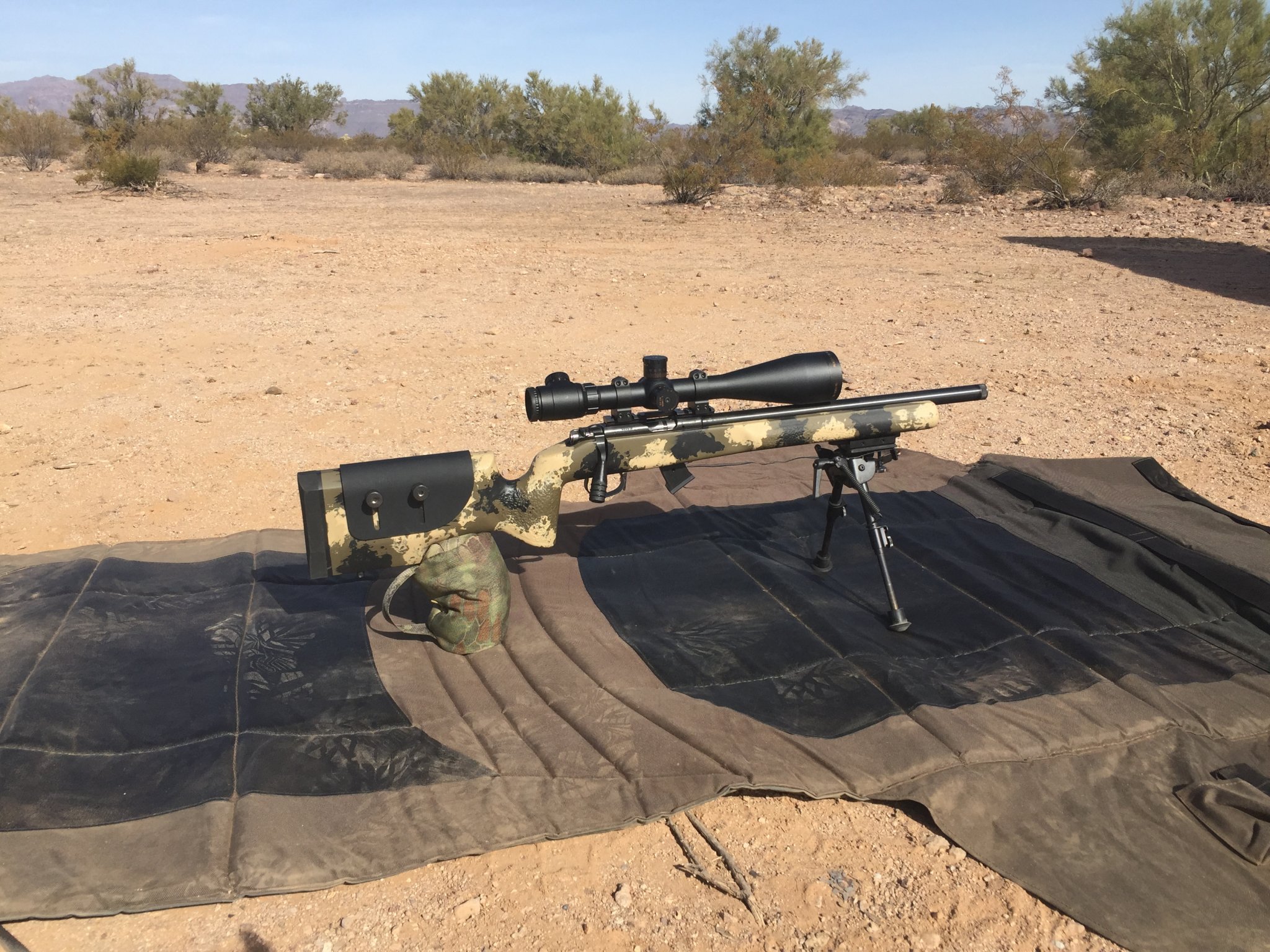

Nice... that’s how mine started and I got a Manners Stock on eBay and it was bedded and pillared somit was a good deal. I just upgraded to a Sightron SIII 10-50x60 MOA-2 which I will have next week. I had the 8-32x56 but couldn’t focus below 40 yards so I sold it because of that.
I also bought Area 419 15 MOA rail I figured it will help to get the new scope higher so I get good bolt clearance.
