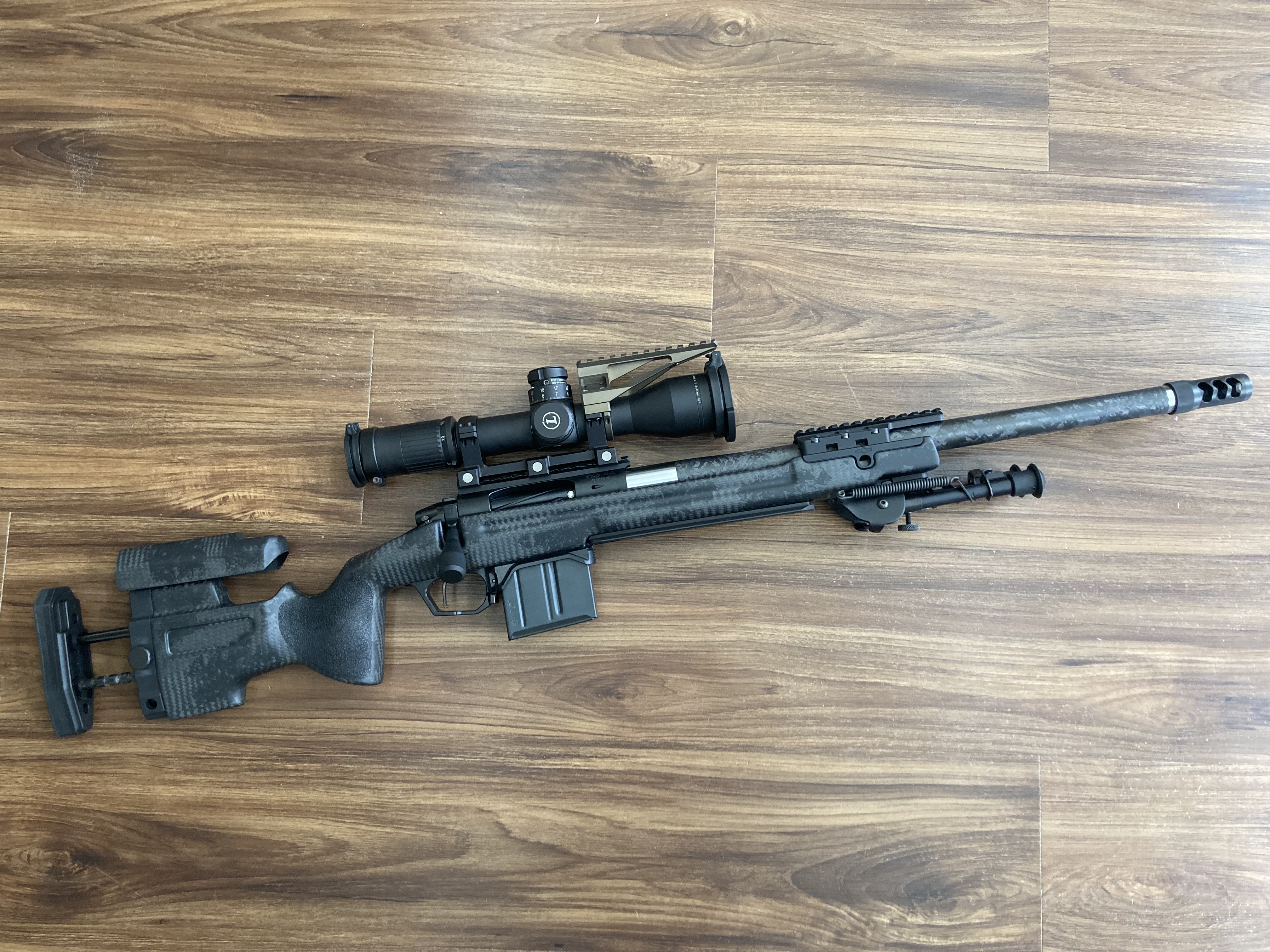

    Getting ready to start the 6 ARC build so I can play with the different bullet weights and speeds, I am gonna pair this build with a gas gun so I can look at the progression from gasser to bolt in the 6 arc space.

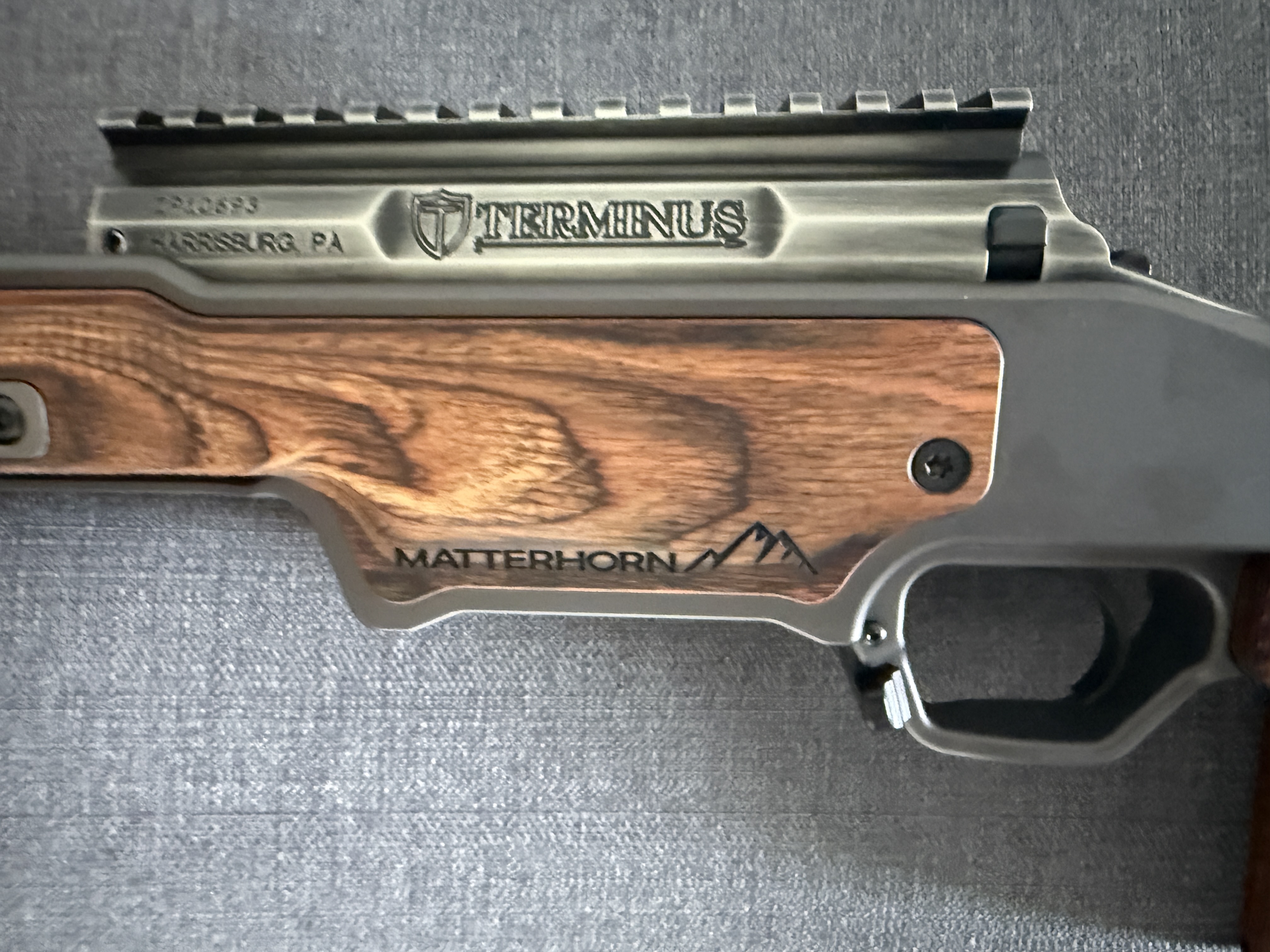

    My Zeus build is on a Zermatt Matterhorn stock which is just crazy nice.
    The barrels are being spun up by Bugholes as we speak for some Terminus PreFit Action
    I have a 20" and 24" barrel coming so can I can experiment with the shorter barrels in the 6 arc space as they intended but also a longer barrel to get the speed, in the end it may require a 26" to get it right for comps, but I think with the factory bullets we have a potential to bridge the gap in cost to play, correctly.

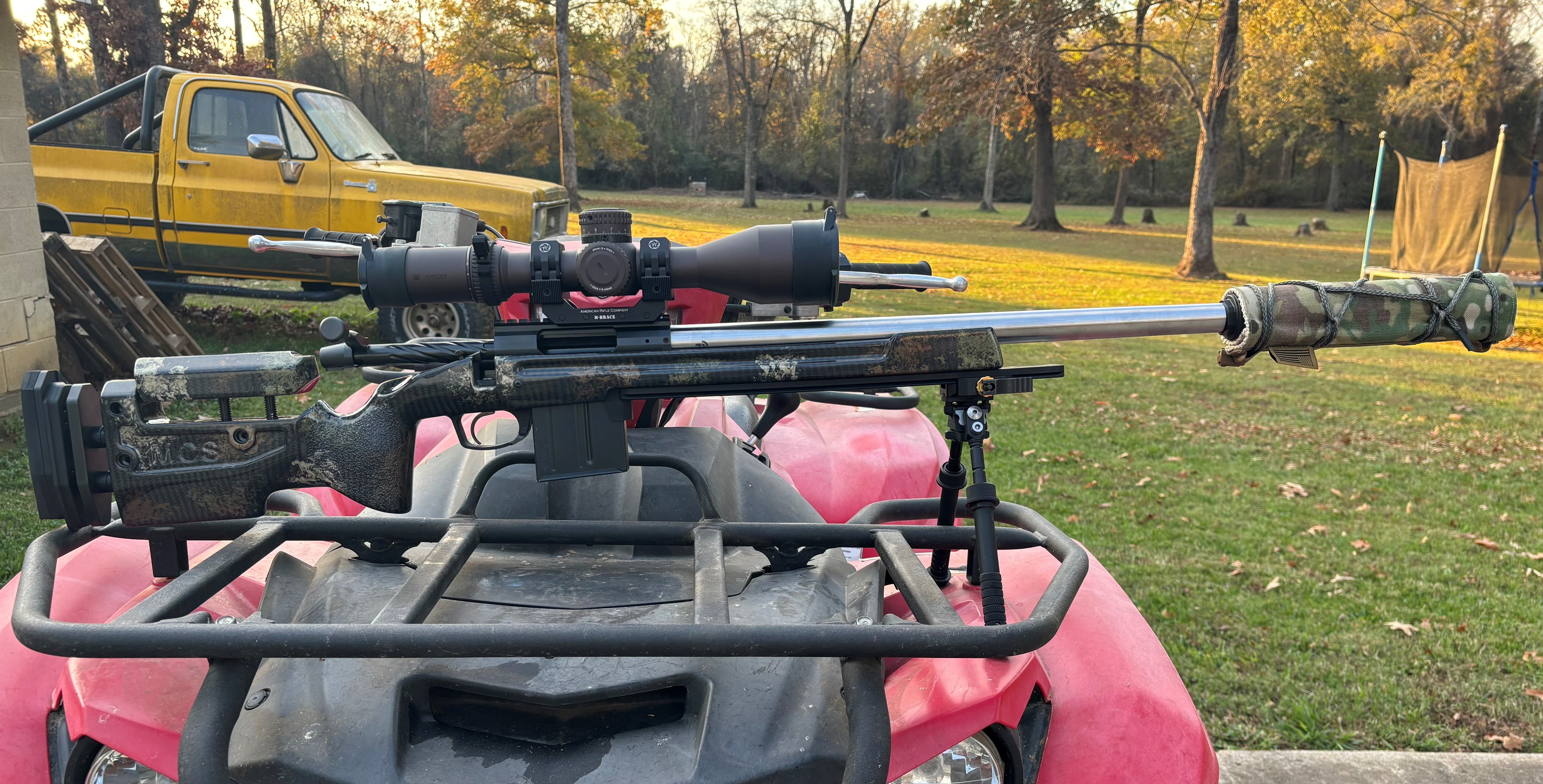

    Awesome. Still deciding what I am going to do with my distressed Zeus. Already did a 20in arc with my standard Zeus last fall. Haven't played with it much yet. Got 2659fps with factory Hornady 108eldm and 2762fps with Druid Hill 90gr eldx. View attachment 8656500

    My Zeus build is on a Zermatt Matterhorn stock which is just crazy nice. View attachment 8655918

    My latest build used a Zues QC as well as a CRB barrel, distressed Samson with a Bix’n Andy pro X 2 stage. All my other builds are 737Rs, but on a 22 Creedmoor I expect yearly barrel changes so I went QC.
