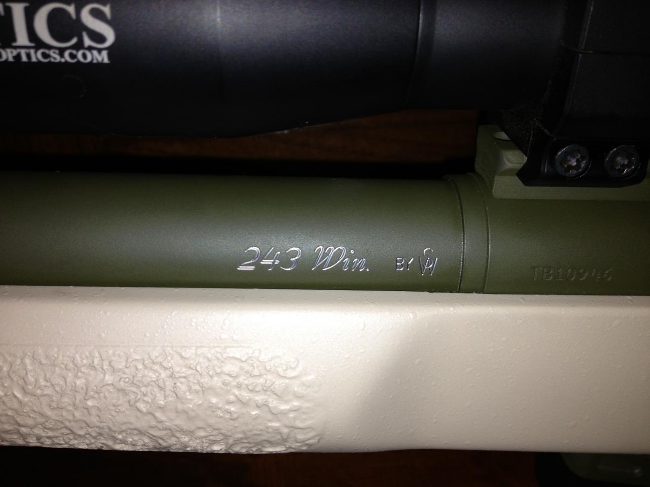

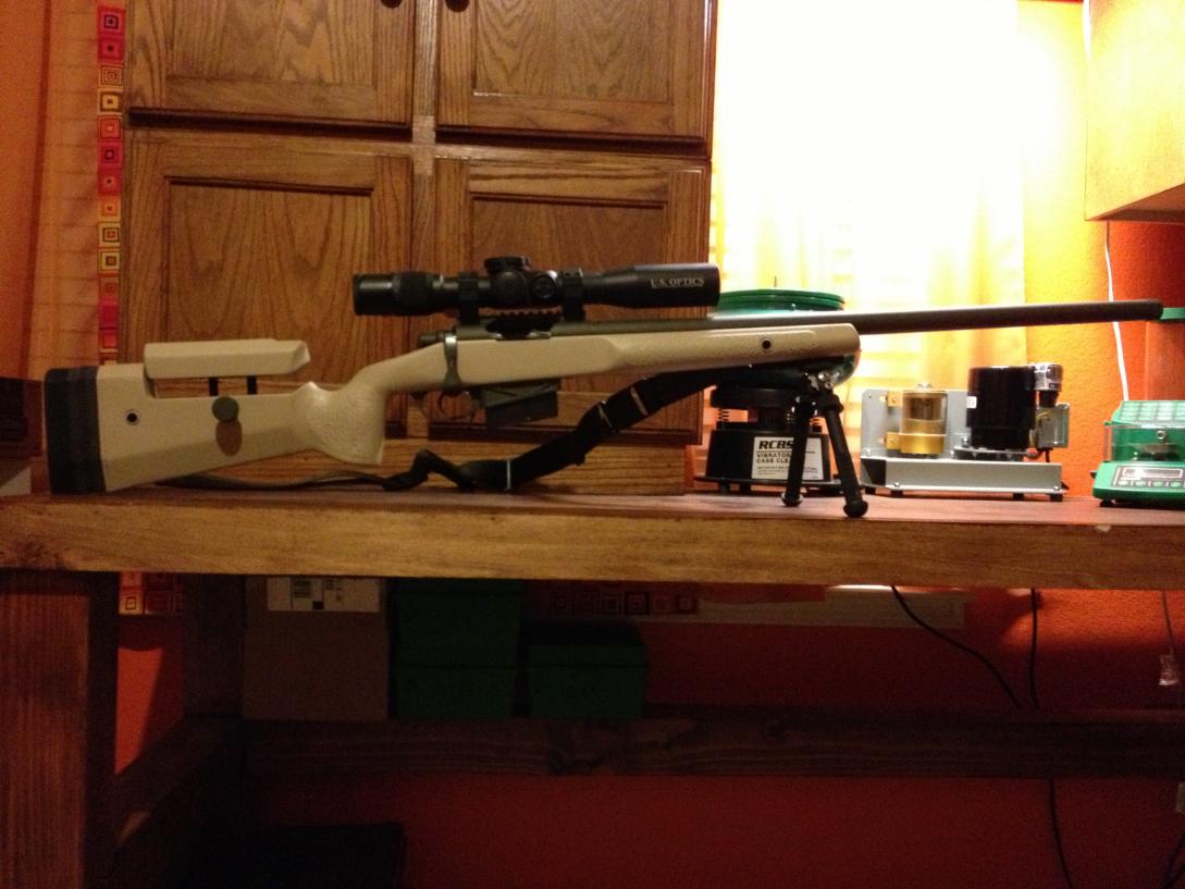

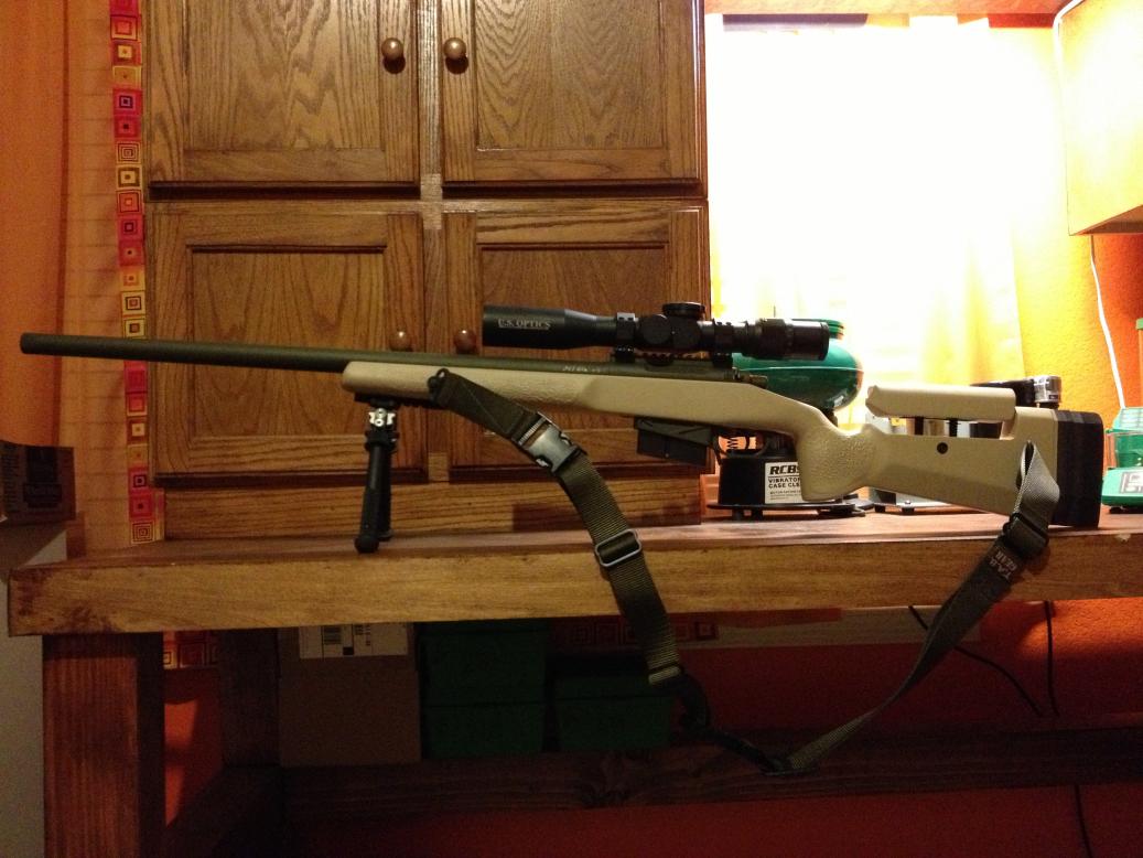

About a year ago I got started in long range shooting, not really knowing what I wanted I had a rifle built by a local smith. The rifle shot good, but it left me with something to be desired. After putting some rounds down range and being comfortable with my shooting I started to learn what I really wanted. So I started buying parts until I had everything that I wanted, and if I could do it over again I would not change a thing. For my smith I decided to use Scott Weichel local to me in Wylie, TX and I couldn't have made a better choice. Scott was top notch to work with and does some amazing work. He will defiantly be building me more rifles in the future. Most of the parts were sourced here on the hide and everyone that I did business with was top notch in their dealings and I could not recommend them more.
Specs
Stiller Tac 30 action with aw mag cut, one piece bolt, with straight bolt handle bought from Sledge Hammer here on the hide.
Barrel is a Brux M24 finished at 26" Threaded with a thread protector bought from Bugholes here on the hide with great service and fast shipping
Huber two stage trigger at 2.5 lbs bought from Mark at Accurate Ordnance who also had great service and fast shipping, Mark was great to deal with and answered all of my questions with no problems
Stock is a Manners T2A with 90% carbon fill, two non rotating flush cups on both sides, extended lop. This is my second Manners Stock and the crew at Manners is in a class of their own with top notch customer service.
Bottom Metal is from Stiller and I like that it has the beveled mag well, holds the mag nice and tight with no rattle or sloppy play.
Atlas bipod, Tab sling, and extra 10 round aw mag were all bought from Triad Tactical, which is also a top notch company that will defiantly get my business in future purchases.
Scope is a USO 3.2-17 Tpal, erek knob, digital blue illumination sitting in seekins low rings. Which was purchased from Lazy21 here on the hide, He is great to do business with and the only place to get your USO gear from.
The rifle is chambered in 243 win. The purpose of this rifle is for target shooting and some hunting, but it will be my go to rifle for 500 and in. I have some Berger 105 grain hybrids to work up some loads with when I get a chance, but will be sighting it in with some factory HSM ammo, because I have a ram hunt to go on next weekend.
I can not say enough good things about Scott, if you are needing a rifle built he is defiantly GTG.
