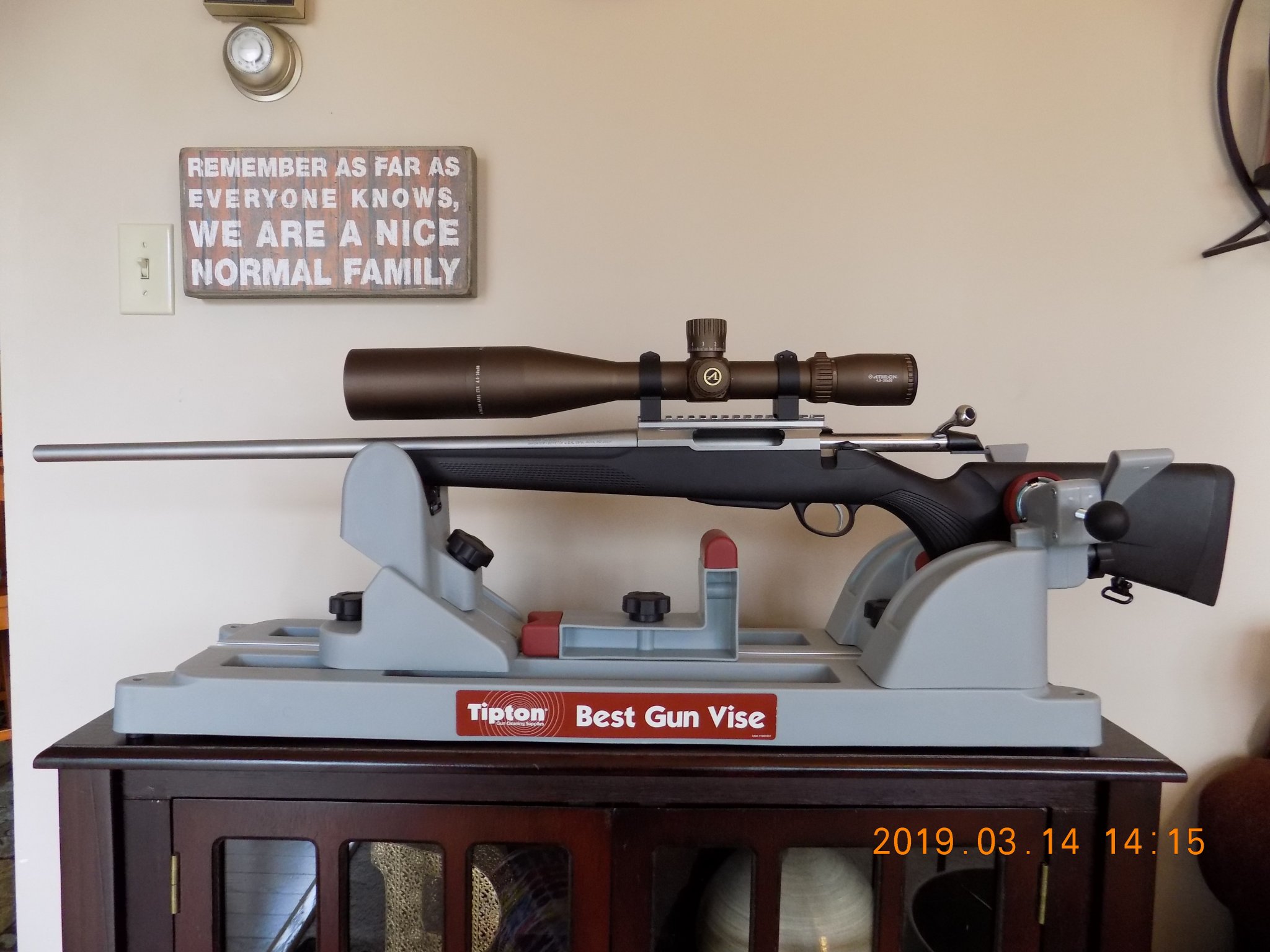

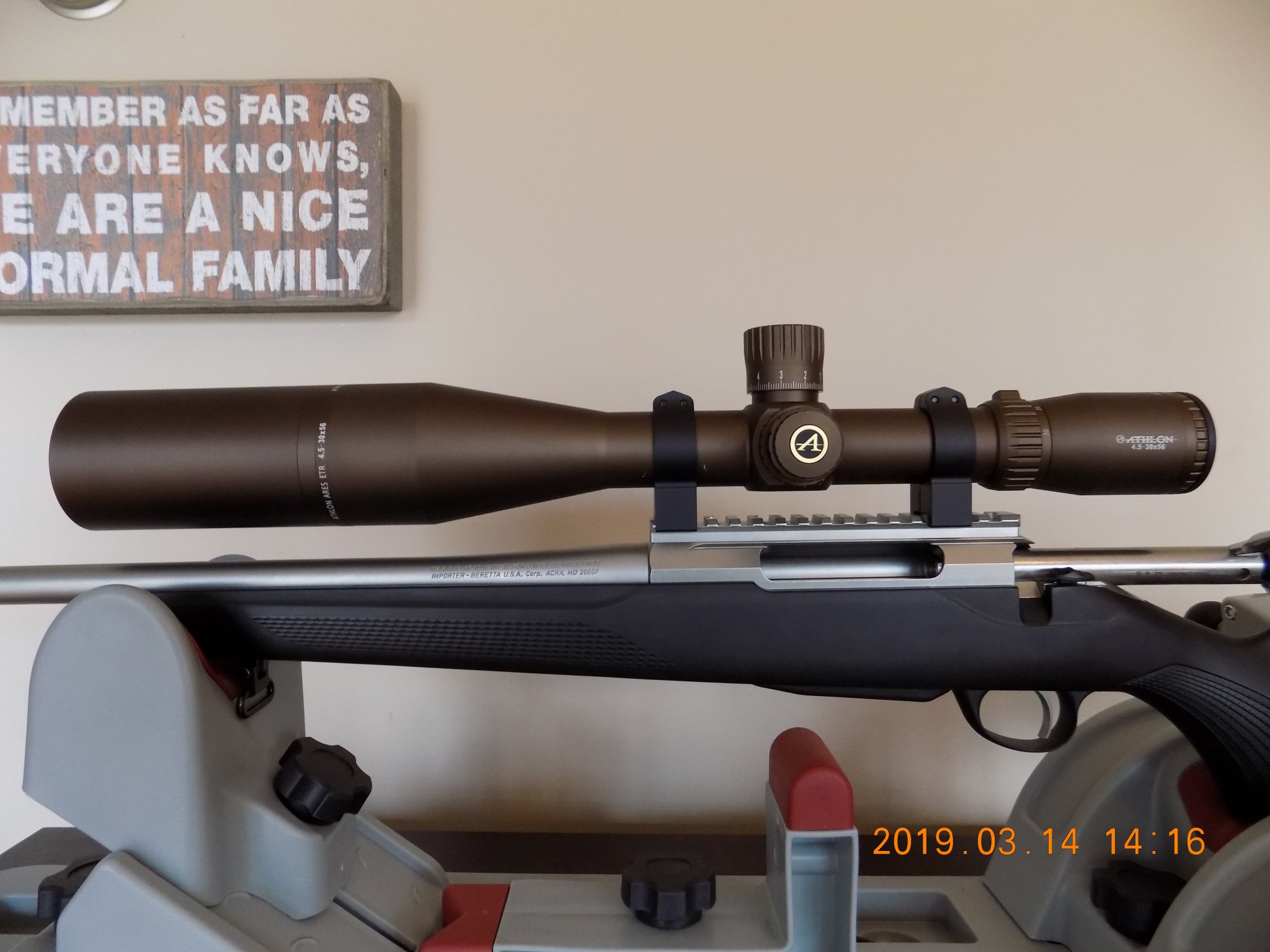

Tikka T3x .308 Lite Stainless Left Handed
Athlon Optics Ares ETR APRS1 MIL Reticle and 4" sunshade
Murphy Precision 0MOA Picatinny rail
Warne Maxima vertical rings
Built my own AR. That was my first rifle. Now that I've fallen in love with the sport of precision rifle shooting, I had to get a bolt action. This is what I've ended up with. Can't wait to get it all put together and on the range.
These photos are a dry fit to ensure all is going to work good together. Now I need to break it all down, bed the rail to the receiver and mount it for good. After that, will remount the rings in the proper position and lap them... doesn't matter to me that the manufacturer (Warne) says they don't need it. I'm not clamping any rings down to that scope without lapping them. Too big of an investment to take a shortcut like that. Even if the rings don't truly need lapping, lapping them will show me that.
Pretty sure I'm going to need to add a cheek rest, but other than that, just need to nail down some good ammo that it likes and we'll be on our way. Yee-haa!

I would invest in some better rings. Vertical split rings are known to have issues. Lots of info on this site about it. Otherwise it's a nice setup.
Agreed on that. A set of Vortex precision rings, JP 1 piece mount, Seekins Rings, etc. All will do every well. I have Leupold, Vortex, and JP on my stuff.

Love the brown scope myself. Offsets it from just black and stainless in my opinion. I may replace the rings with a lower set though, as it sits pretty high... that's the one thing I may change. Other than that, very happy with it. Shoots great as well. Going to lower the trigger pull weight since I am mainly using it for punching paper.
Choosing rings was a real stress area. I went with Warne as that is what the Athlon tech support person recommended - though he didn't recommend a model... few to choose from in the 34mm size though.
