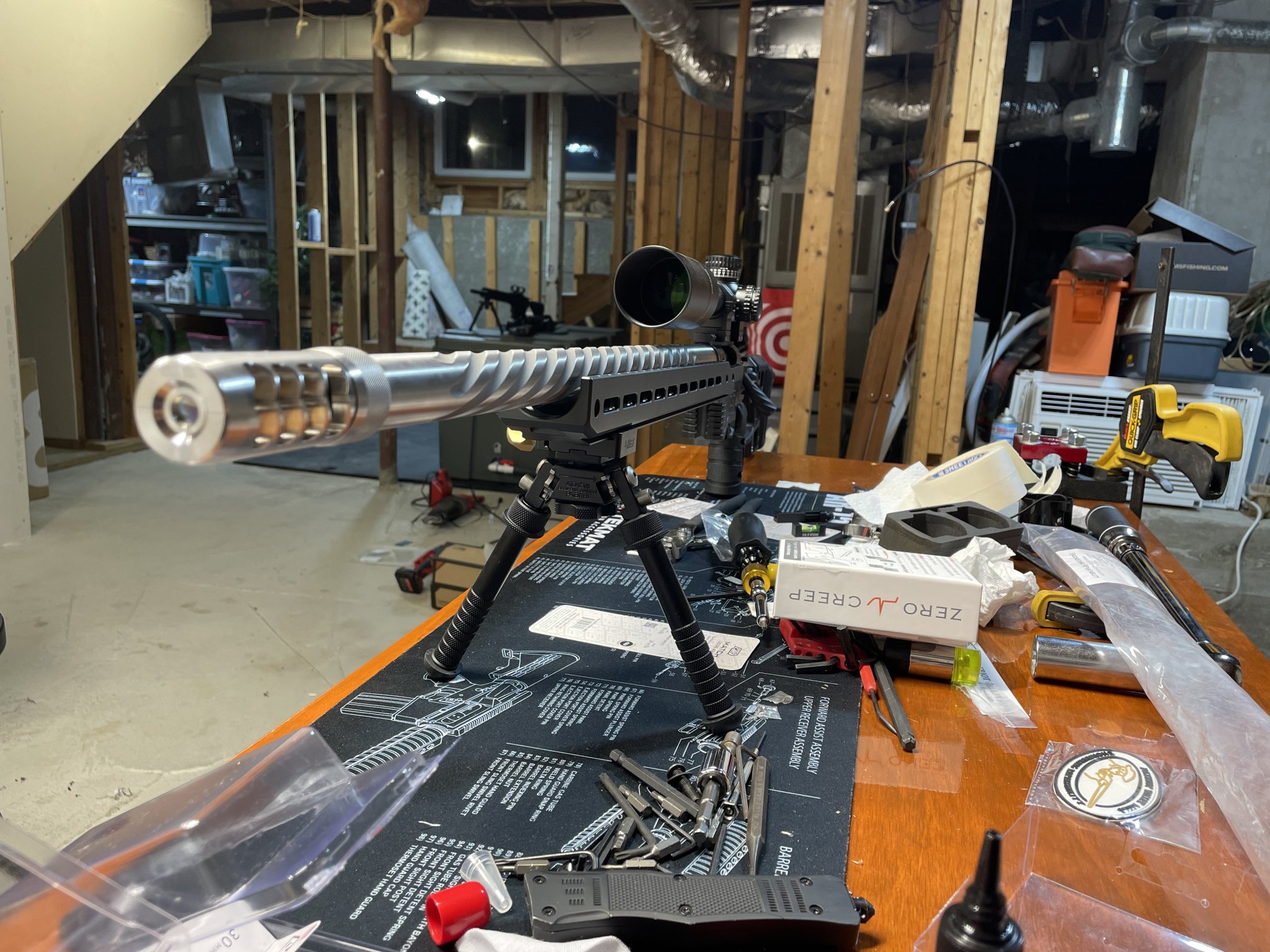

First off, huge thanks to everyone who has answered my questions over the past few months, you all have been a big help in getting me started. I think I’ve finally finished load development for this gun, and the results have really impressed me, so I wanted to share with you all what you’ve helped me create. 5 shot group at 100yds measured out to about 1/4”. Very impressed with this build!
Action- Zermatt Origin SA
Barrel- Osprey shouldered prefit in 6.5 creedmoor from PVA (Proof comp contour)
Chassis- MDT ACC Elite
Trigger- Trigger tech diamond
Brake- Area 419 Hellfire Match
Scope setup- Vortex viper PST gen2 on area 419 match scope rings
Bipod- atlas bipod with area 419 arcalok clamp
