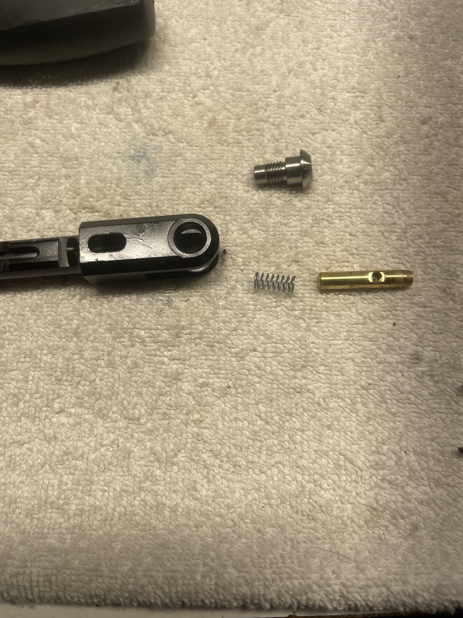

    Had my first issue with the Ckye double pull. Here’s a simple check/fix/cleaning for someone to avoid the same.
    The spring/brass pin assembly in the leg got some dirt from the corn or alfalfa field in it. Had issues with the brass pin being able to move eventually just seizing it up in the unlock position where the leg wouldn’t lock into place.
    Simple fix but a good place to make a regular service area in the off season

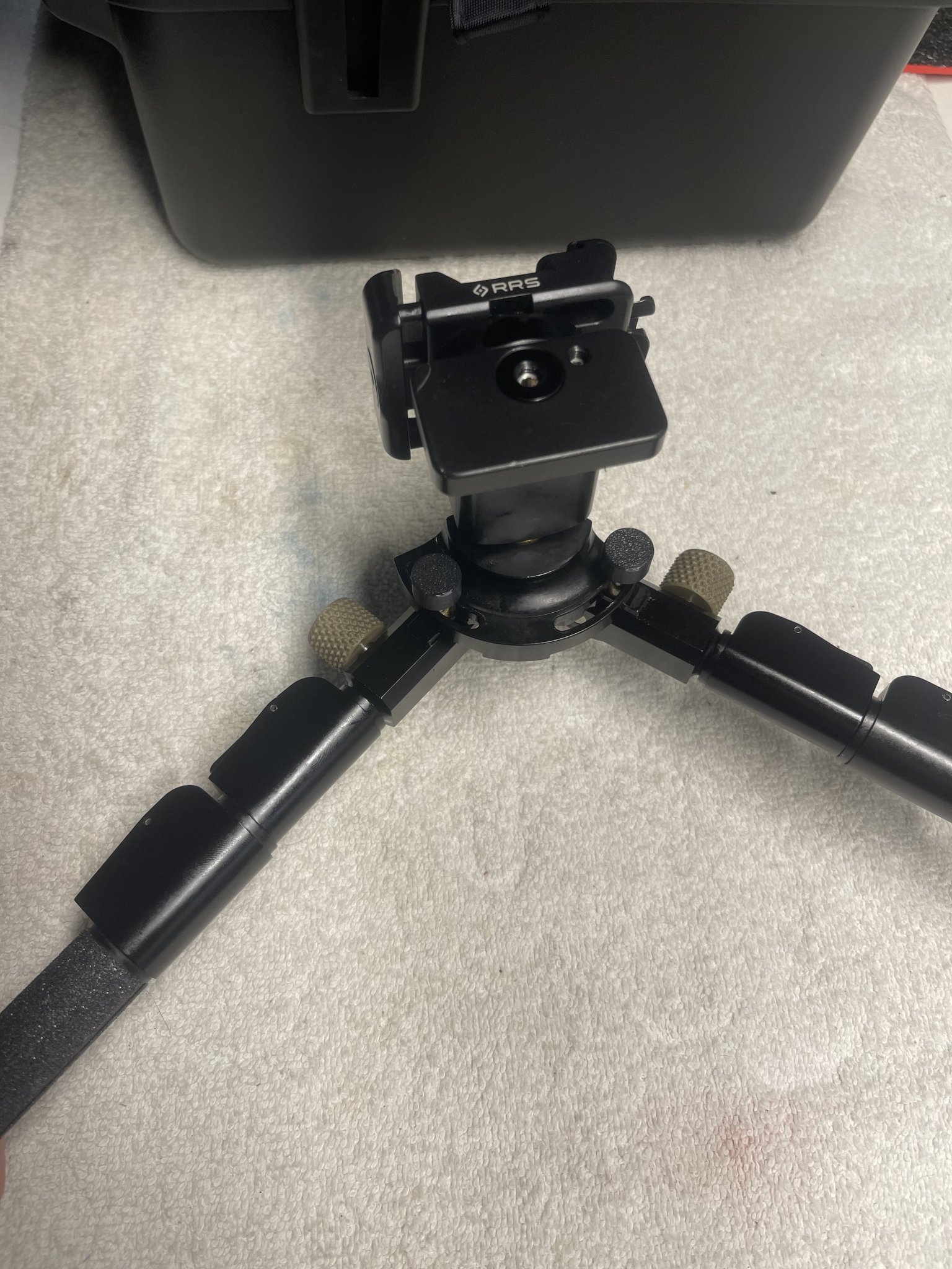

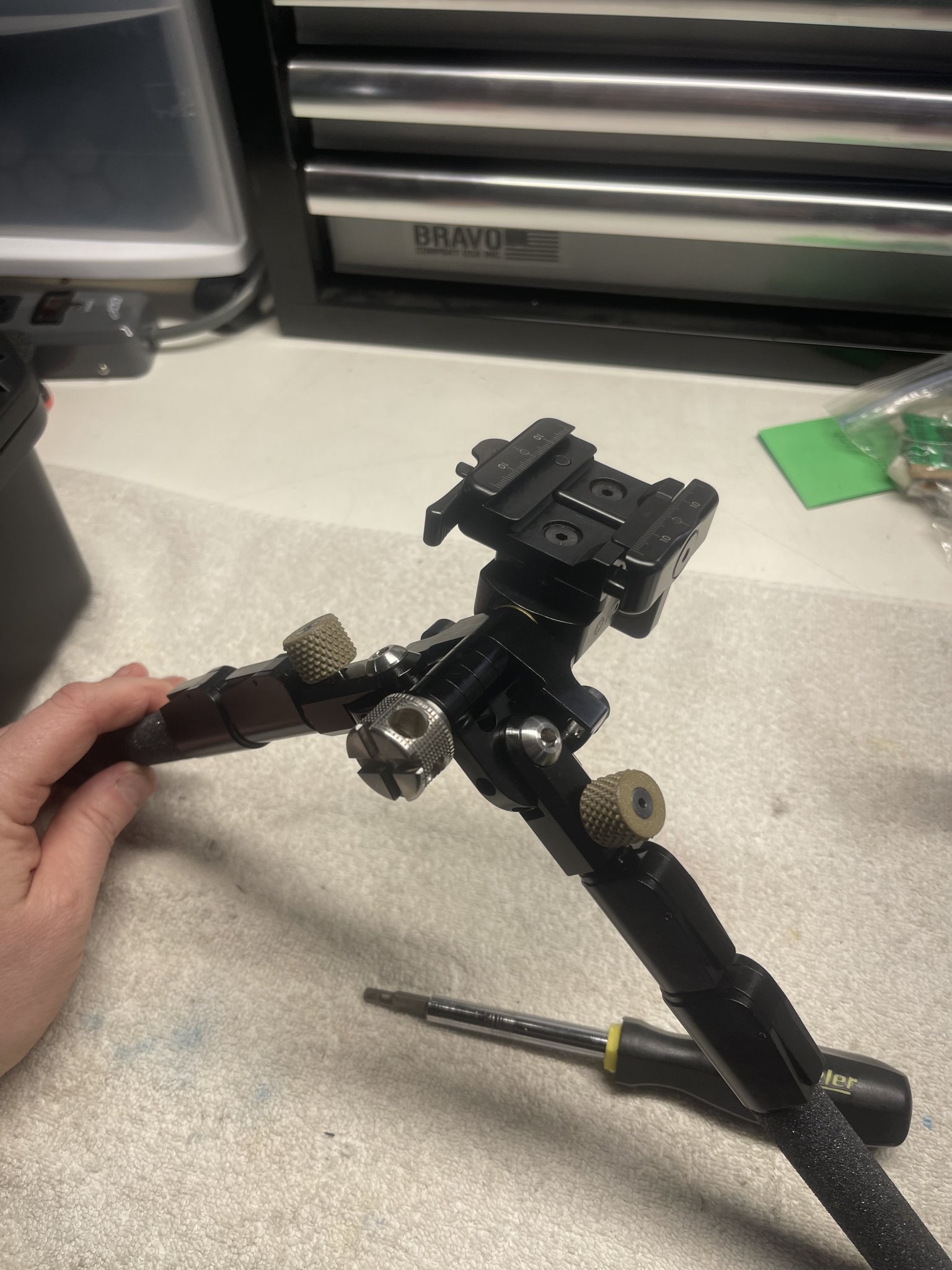

    On another note after the cleaning I installed some new pod knobs. Really nice upgrade for anyone looking

    I honestly love the thought into this bipod. It would however be cool if they made (some of which is made by @Prknives) thumb screws for the major bolts. Including where the hinge is where the legs deploy.

    Grease and lube attracts dirt. We have lots of dirt. I have never let lube anywhere near mine and it's flawless.
    I do know a guy who decided to smear lithium grease to make it smoother. It locked up with dirt the next match.

    I don’t shoot comps. Never lubed it with anything either. I did now after cleaning it so we’ll see how it holds up
