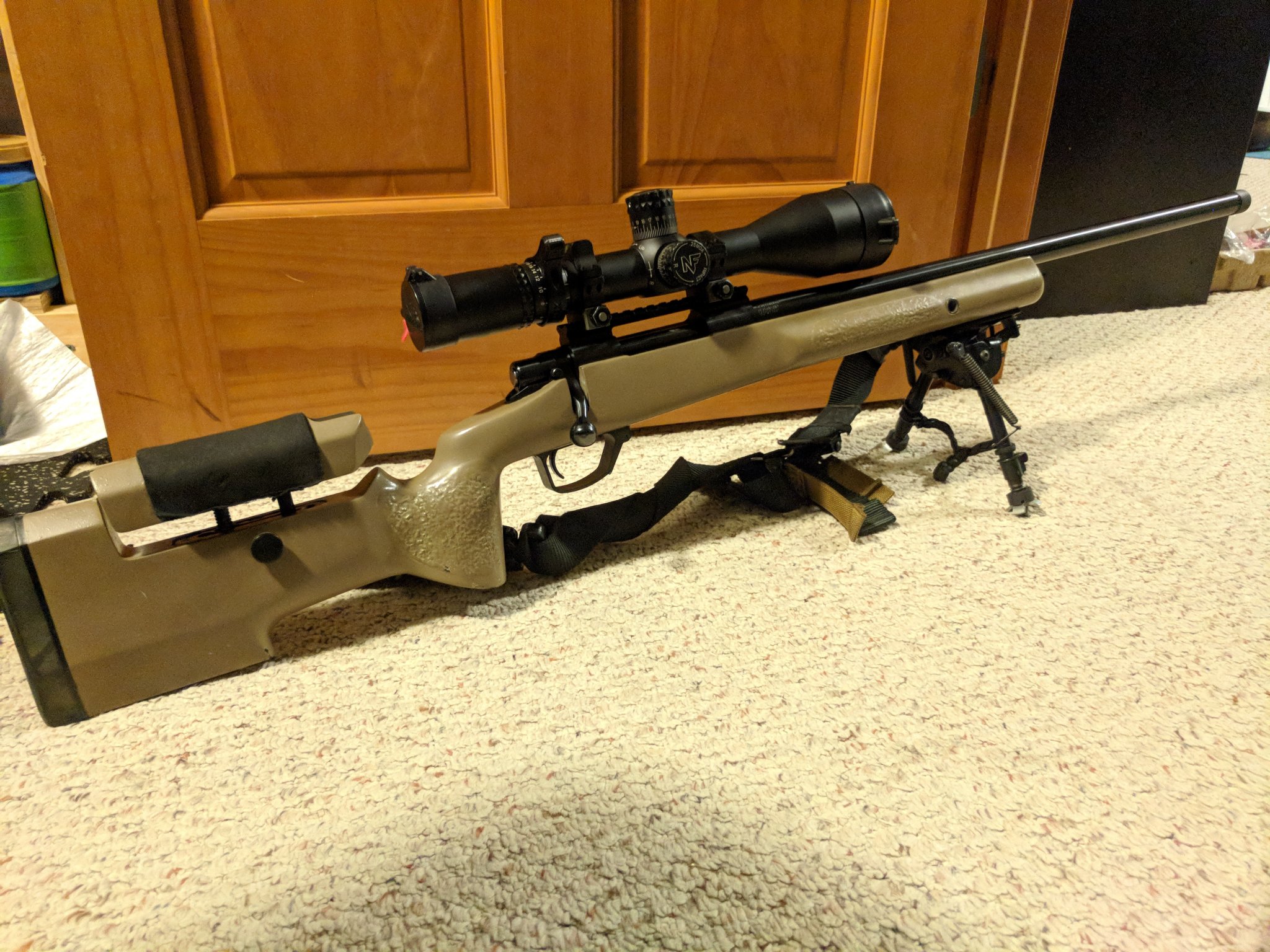

I'm new to the precision rifle world and trying to learn as much as possible and this site, what little time I've been here, has been tremendously helpful. My rifle is a Howa barreled action 24" 6.5 Creedmoor in B&C stock, EGW 20moa base and Badger rings holding a Vortex AMG. I need to work on a lot of fundamentals of precision shooting so I will take it slow and practice a lot and ask a ton of questions, watch videos and read. I don't have anyone more knowledgeable than me in the sport to shoot with so I'm learning in my own. One thing I need to work on is my grip and I need to get a trigger pull gauge to see what my pull weight is but I feel it could be lighter. Here are some pics of my very first noob 5 shot groups with Prime 130gr. I did have some worse groups but these are the better ones. I also shot some Hornady Match 140 ELD but I felt the Prime shot better. Also I did try suppressed and that caused my groups to open up a bit and shoot about an inch low but I need to shoot more suppressed to confirm that.
ETA: sorry for the sideways pics not sure why they uploaded like that.

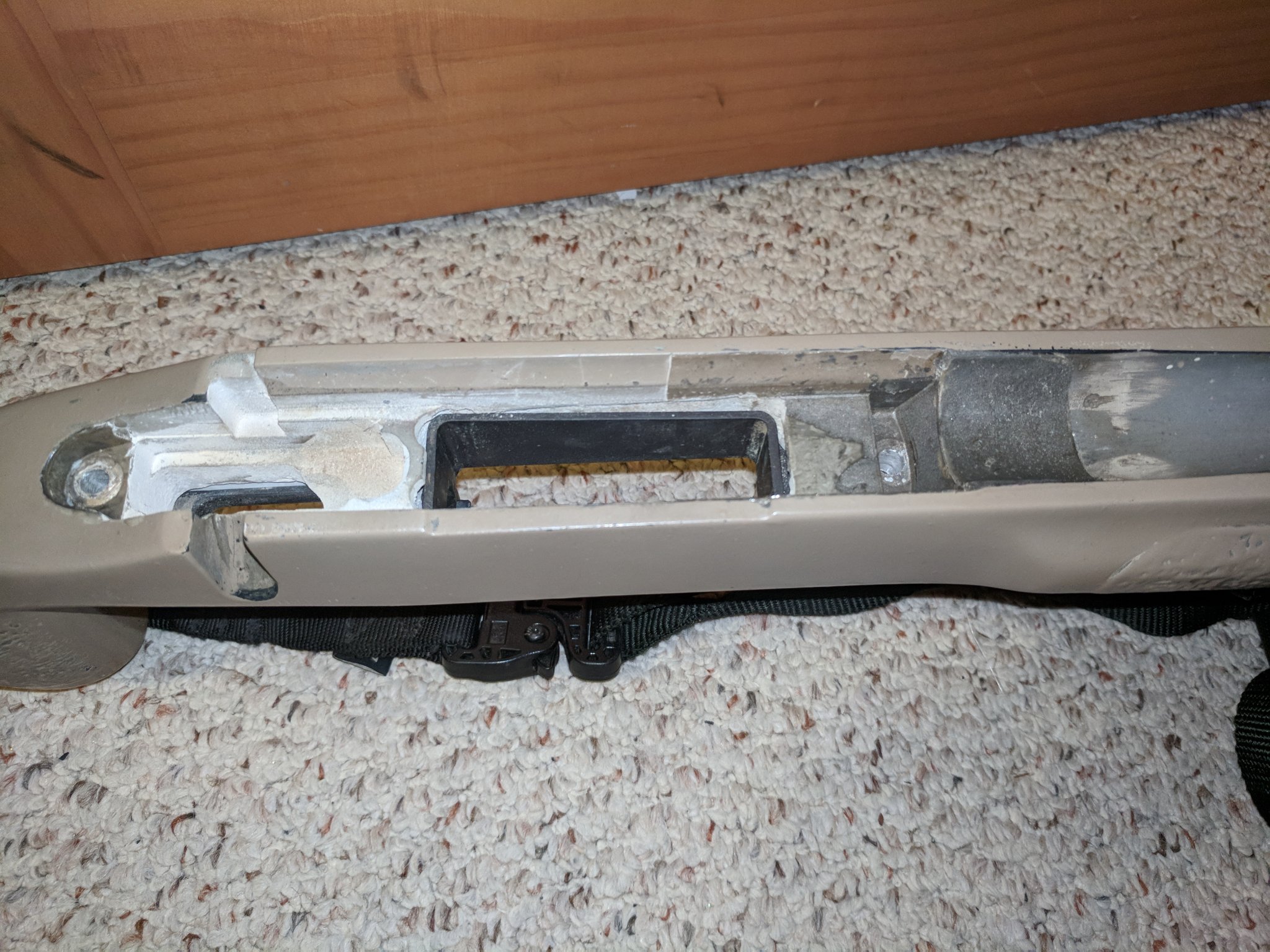

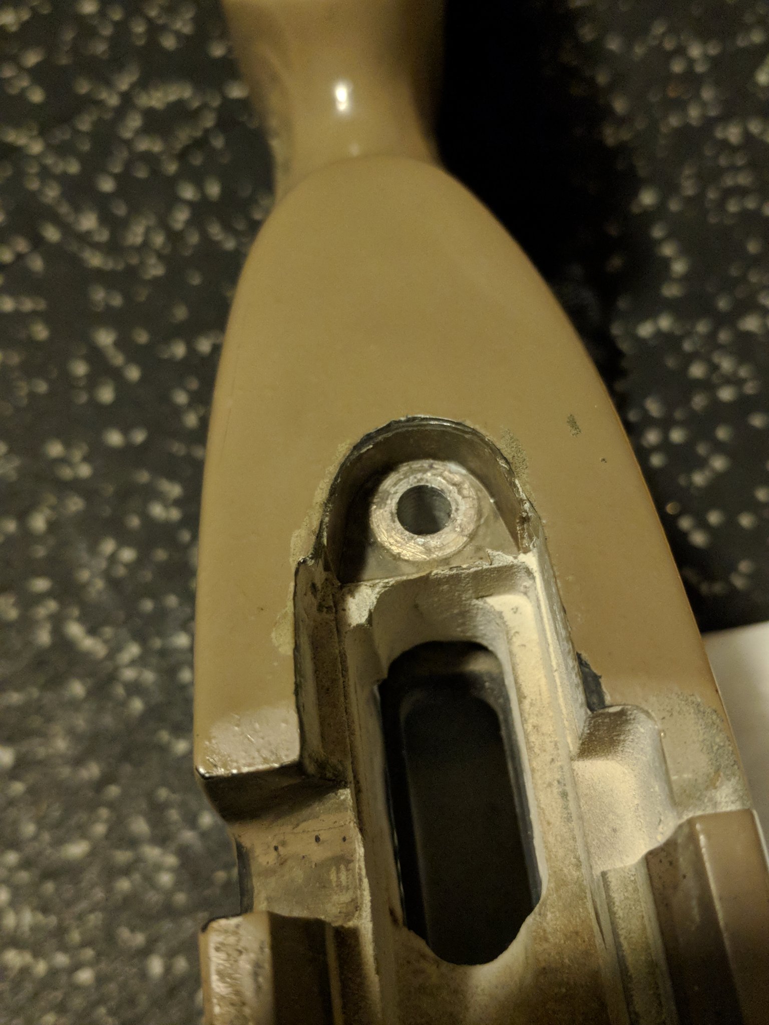

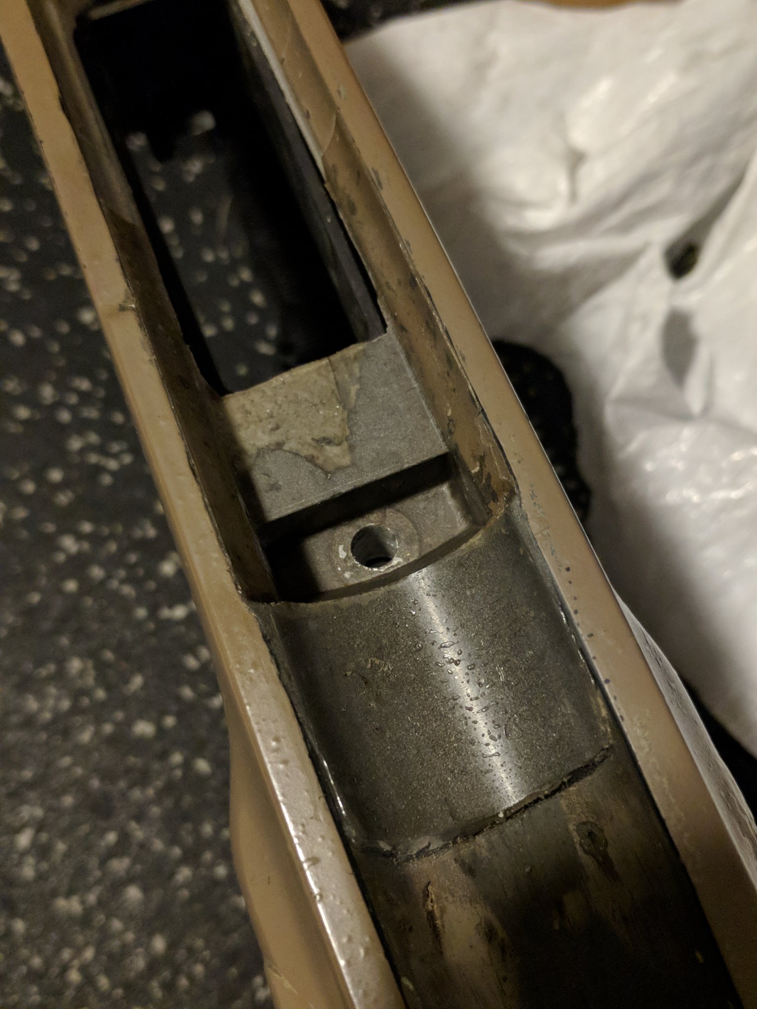

Thought I'd attach photos of how I bedded mine. The lug recess (all around), little bit onto shelf (just to even contact points), rear tang area, and forward into barrel channel about an inch.
Stock is a Manners T4A and Howa 1500 action.

I should add that the biggest concern area is preventing bedding material from leaking down into the action screws. I didn't have to worry about this due to the material I used but others will have good info on avoiding seizing action screws to action/stock. Again, liberal amounts of release agent are best safety measure in most cases.
Did you tape the edges of the recoil lug?

Just got done bedding the action. I'll post results tomorrow after it is dry. I already see I missed a big gap in rear tang that I will add more bedding to tomorrow. The epoxy did squeeze out and got all on the action screws so I had to clean them off and coat them real good with the release compound. Man I hope this comes out successful.
Did you tape up. Are you cleaning excess off with mineral sprits?
Yes I taped it but I didn't put so much in that it spilled out over the edges
I took q-tips and rags with mineral sprits and did almost all the cleanup while wet. A lot easier than chipping or cutting at it later.
If you used release agent all over, I would not worry about it coming lose. If it for some reason should be hard coming out, some light whacks with a clean wooden mallet on the rifle metal will help. Protect your rifle finish if you do though. I seriously doubt you’need to.
