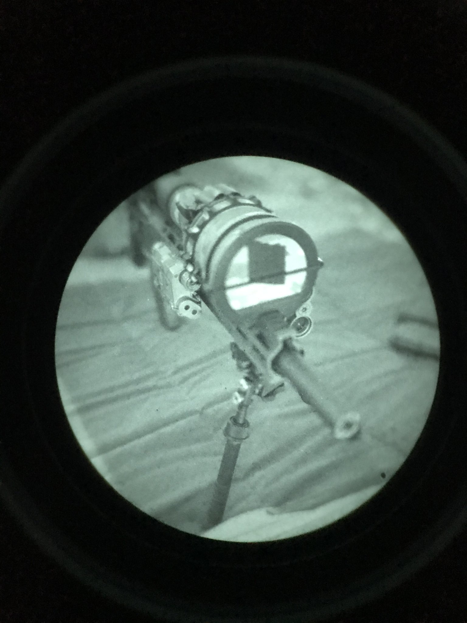

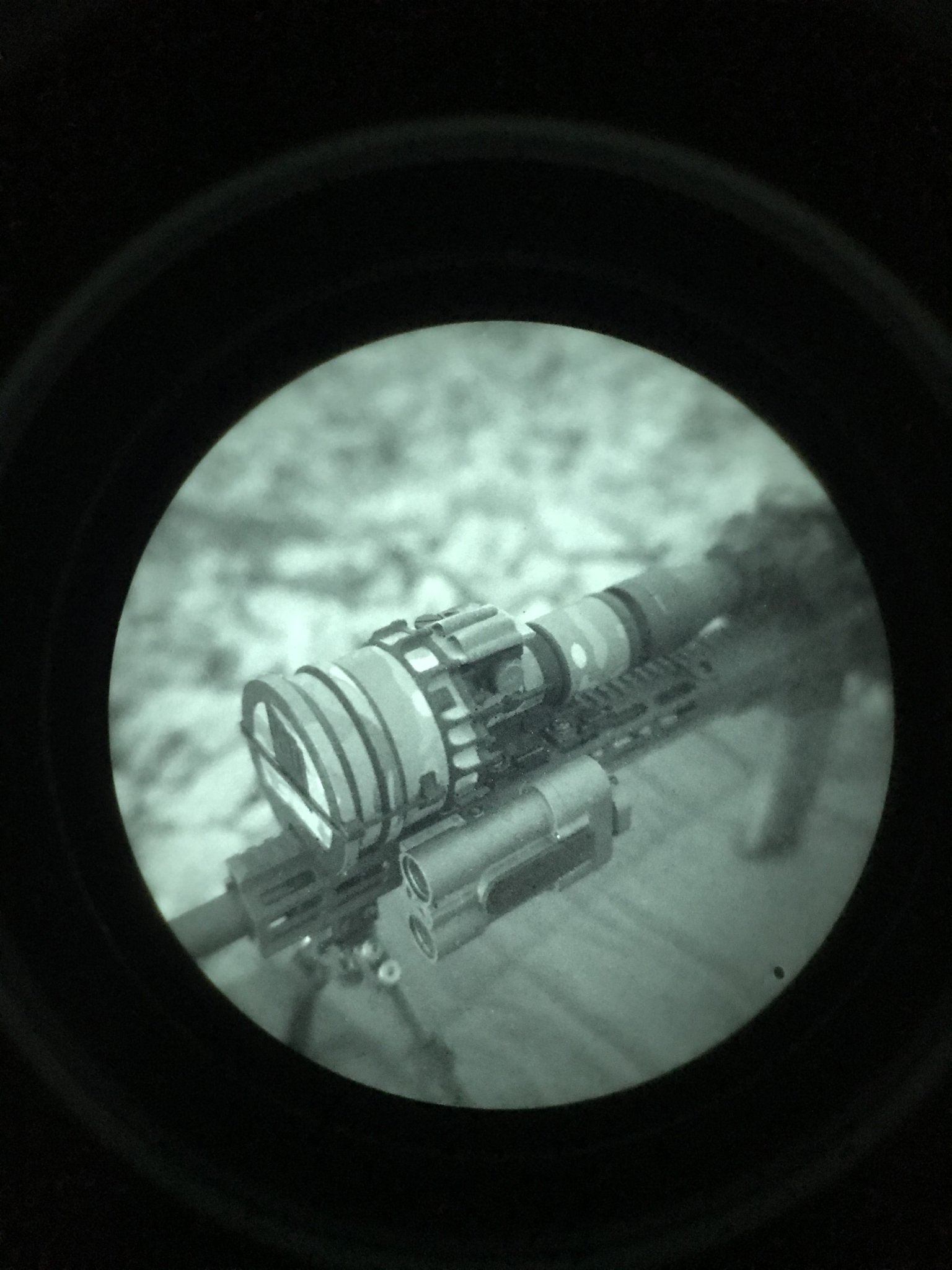

Here are a couple of photos that I took in complete darkness. The rifle was placed in the garage aiming to the back yard fence. The distance from the rifle to the fence was measured just shy of 25 yards.
I put two boxes of 308 ammo side-by-side on the fence bracing to use them as the reference point for the photos. The Gain knob on the PVS27 was turned to a low setting, about a setting of 3 if we were to use a scale of 1 to 10.
The first pic was take at 5X, the other at 12X. I couldn't get a clean focus on the boxes of ammo because of the short distance.
The following photos were captured using my cell (IPhone 6?) phone and it was a real pain in the arse trying to get good shots. The photos do not represent the clarity or brightness that I saw through the optic. The view was Spectacular.
Pic1 taken at 5X.
Pic2 taken at 12X

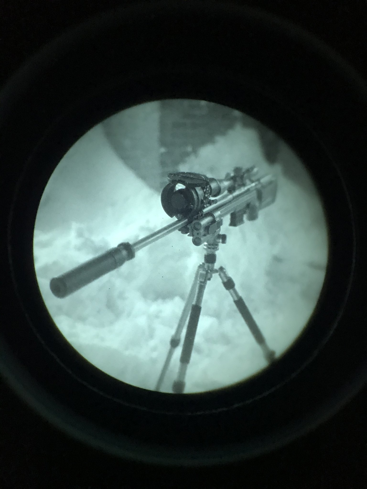

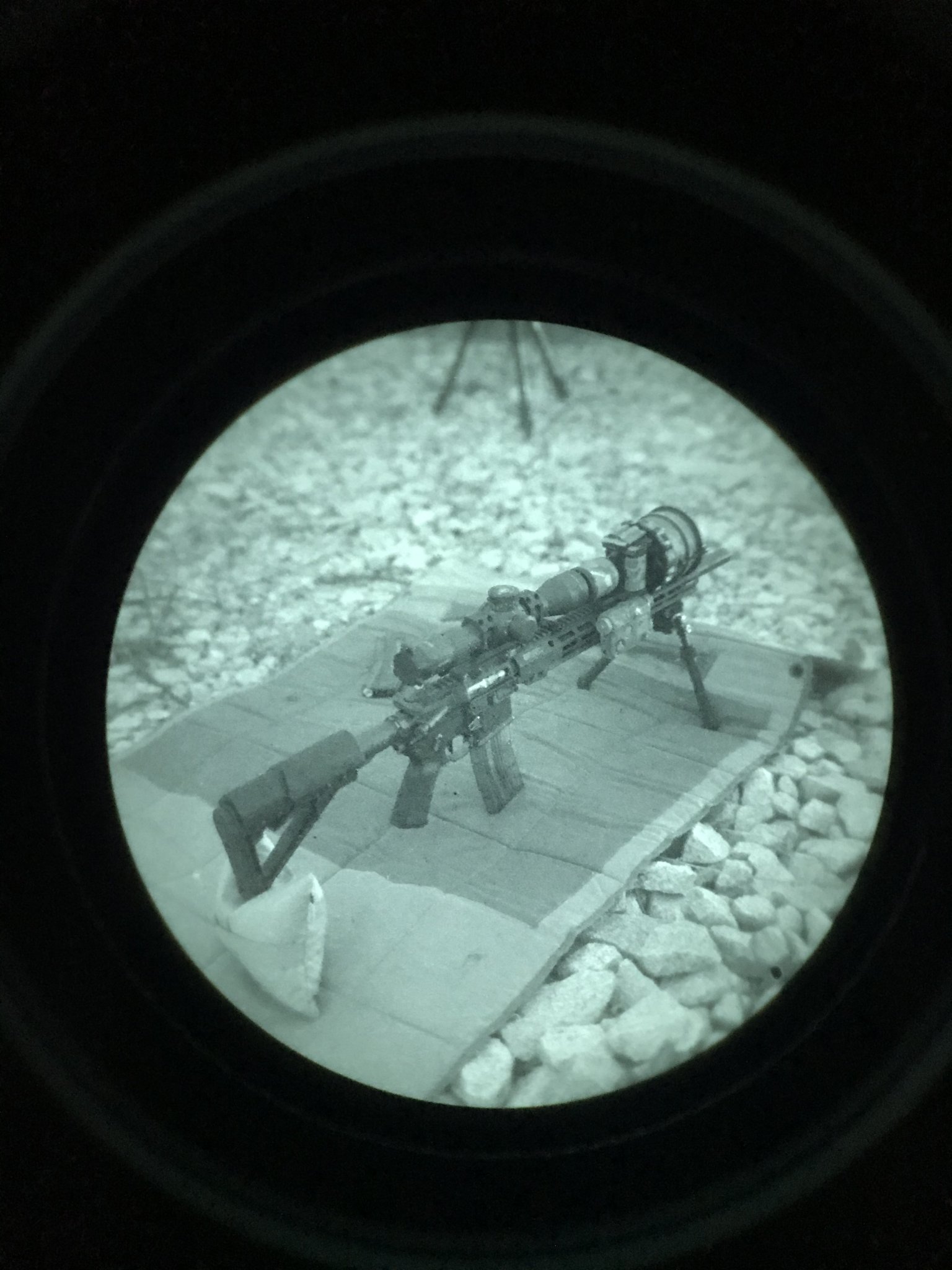

The Raptar was delivered today so I mounted it and took a few photos. This thing comes with 2 owner's manuals, a mini CD and a booklet. It can be reconfigured and adjusted a million ways. The digital mode display on the back panel can be adjusted for brightness, as well. Here's the current setup as it sits today [subject to change. :)] ..

What type of mount is the 27 attached to? Looks like it interfaces with the spigot system
Reactions: LOS
Thanks for the mount information
Sorry for all of the questions but which RAPTAR is that. Looks nothing like mine. Looks like it has a flashlight of some sort on the one side
I found a great deal on a brown Raptar so the black one will be sold. The difference between the units is that the black raptar comes with nice factory QD mount and matching black remote.
Nice set up, and I am jealous.
As already noted, running that close to muzzle with brake will be a issue. If you do, use a surefire flash hider, or equivalent, they really do a great job in eliminating flash. Quite a number of ways to address this. I think you have your plan though.
Measure if there is any deviation between the day and night optic on paper. I would do so every 6 months or so, depending on how rough you use the NVD.
IR flood mounting is best used near the front of your chassis. Your current mounting may cause shadowing, test it to be sure of the clearance of the objective housing
The 27 with white phos is also pretty sweet.
@8up
Thanks. Excellent advice on all levels. Oddly I’m only getting a [27 bell] shadow with the flashlight, not the IR flood. The laser beam is also unobstructed but I think the raptar is definitely coming off the top.
Mounted on the front side, If the raptors remote switch isn’t long enough I’ll have to rethink my illuminator situation.
I’m waiting on the Arken SH-4 to deliver next month. It’s a lot shorter than the B25 so my NV proximity to muzzle will be resolved at that juncture.
