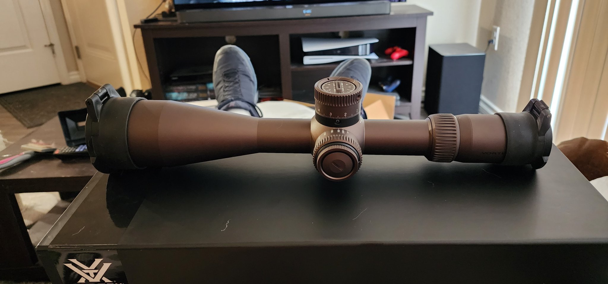

Vortex G3 arrived and wow. It's difficult to really comprehend the size and heft of these things from videos. This thing, even without the sunshade, is absolutely massive!

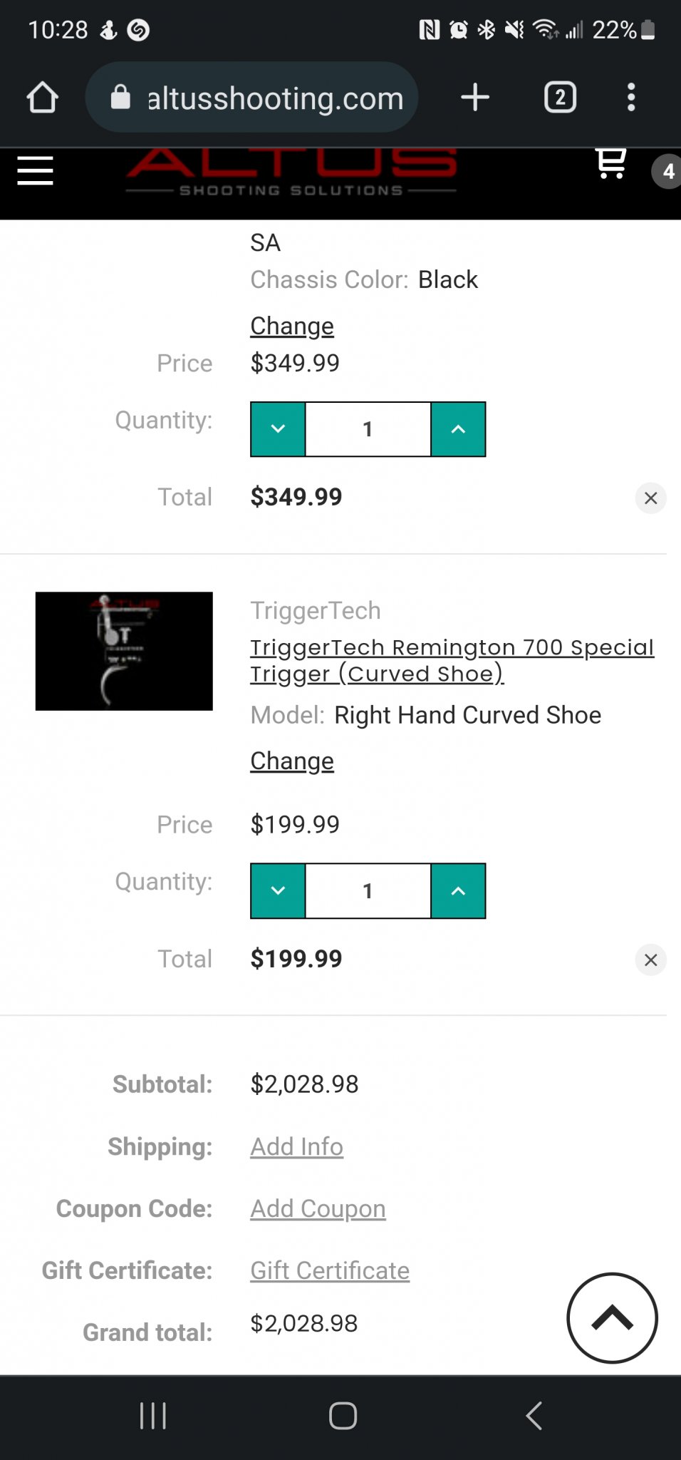

EDIT: Also just placed an order for some Vortex Precision Matched 1" rings and a bubble level off EuroOptic. Hard to say no to that 40% discount!

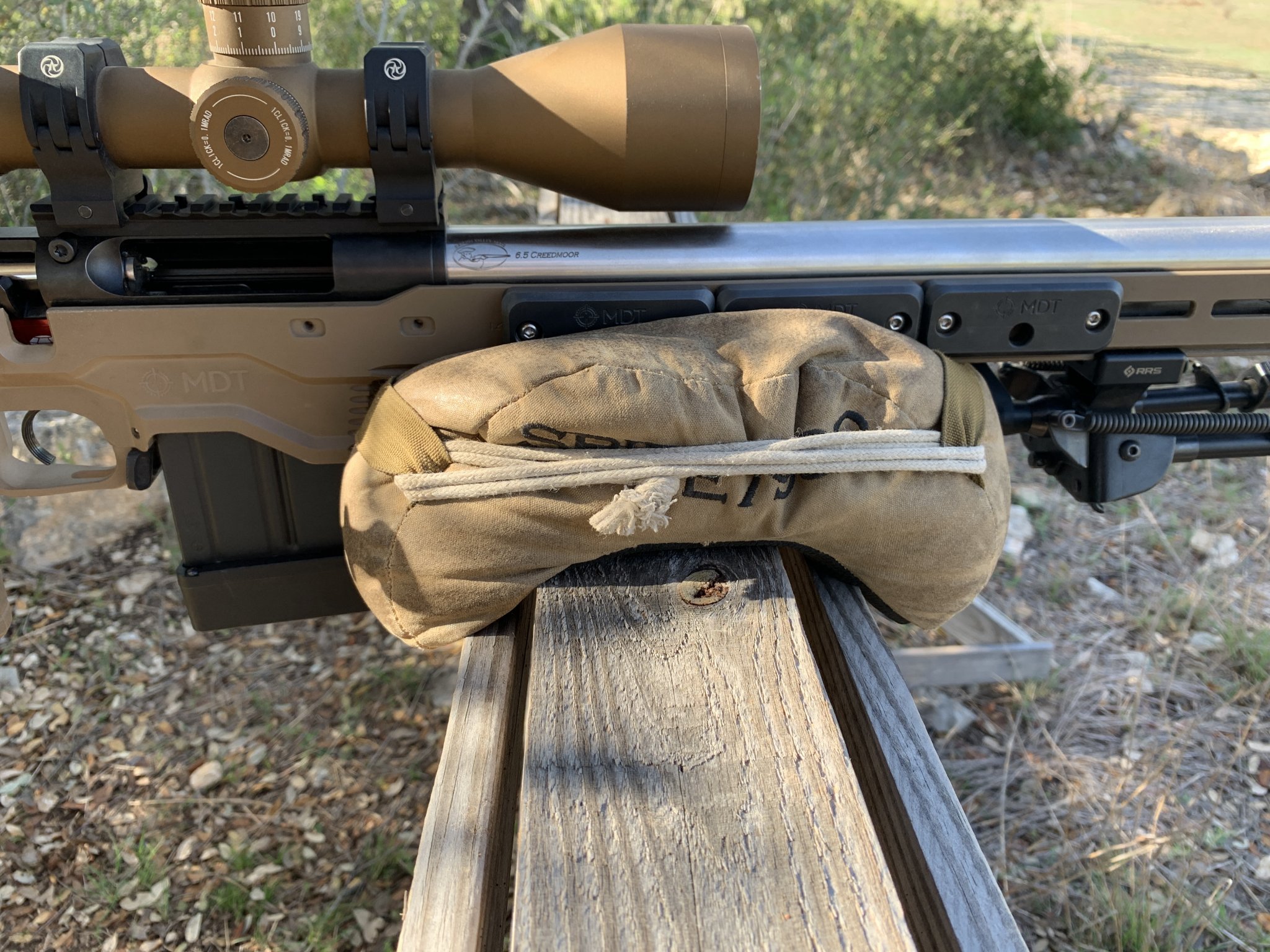

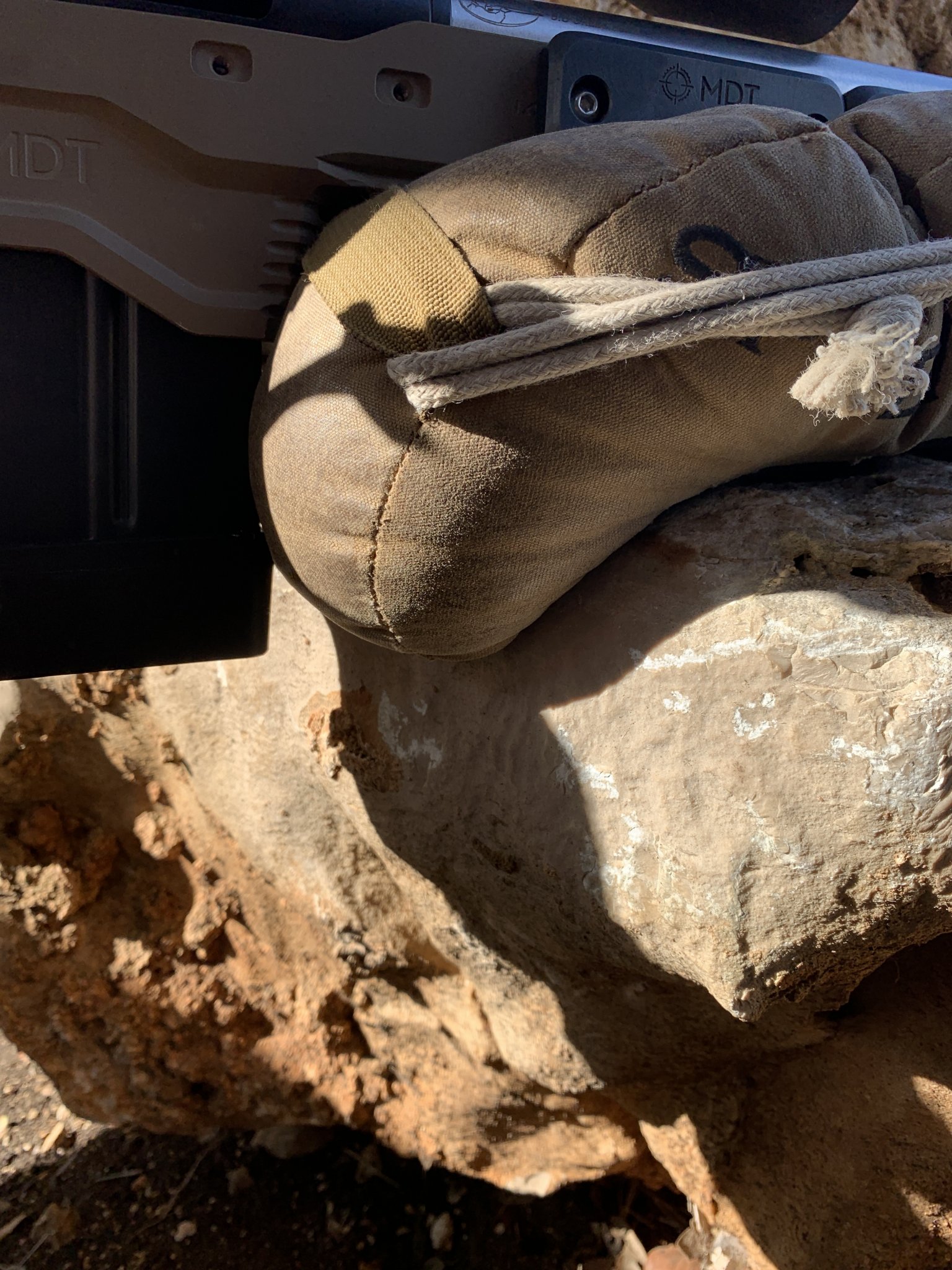

I'm back to report on my first session with the rifle! Used 50 rounds, my friend used 10. So 60 rounds total through it. Used Hornady 140 and 147gr as well as Federal 140.
First shots were to try and sight-in the optic. Initially at 25yds, it was shooting WAY high. Slowly walked it down in 10mil increments.
All-in-all, I was very pleased with the rifle. It's certainly more capable of shooting accurately at this point than I am. The biggest issue BY FAR, was finding a comfortable and stable shooting position. I bought a front and rear Caldwell shooting bag, but since I also got the Atlas bipod, I didn't need to use the front. However, the seats were a little too short for me and the rear bag was extremely unstable when the optic was aligned on the target.
I also had to have the bag so far forward, it was interfering with my grip. It was also uncomfortably digging into my chest. I'm certainly looking forward to getting outside so I can shoot from the prone position. I'm also seriously considering buying an adjustable monopod for the rear if such a thing is made. Frustrating isn't the word for what it was like trying to steady that rifle when sighting in. I would have just shot without the bag, but with the seats being too short, even that wasn't comfortable.
Reactions: higgysmalls
Something like the Wiebad Range Cube?
It’s fine but I much prefer my tater tot as I can do what the range cube does just as well with it but the range cube can’t plop down on a barricade nearly as well.
The tater tot is the same roundness as a mini only it’s wider on the flat so when laid on its side it’s tall enough to clear a standard aics mag
That and a game changer are what you’ll see most people at prs comps using. And for good reason.
Edit: range cube doesn’t sit there nicely on something like this or worse a round one.
And it’s nice that it can hang down a bit in front of the prop and lets you push into the prop without the mag bouncing off the hard prop
