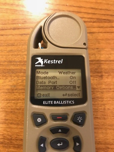

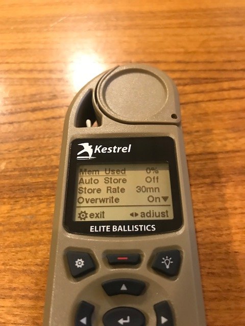

    I suspect that you have your Kestrel set to automatically log atmospheric data and probably at a very fast rate. In the menu for settings, the one that has the Mode and Bluetooth menus, there is a Menu choice called Memory Options. If you choose it, you get another menu group that includes Auto Store, Store Rate, Overwrite, and Clear Log. If you have Auto Store turned On the Kestrel logs and measures all the atmospherics and stores it to memory. The Store Rate can be set as fast as every 2 seconds, and it takes battery power every time it measures the atmospheric conditions and stores the data.
    I turn Auto Store to off on mine because I don't have any need to bring up past logs of temp or baro pressure or any of the other atmospherics.
