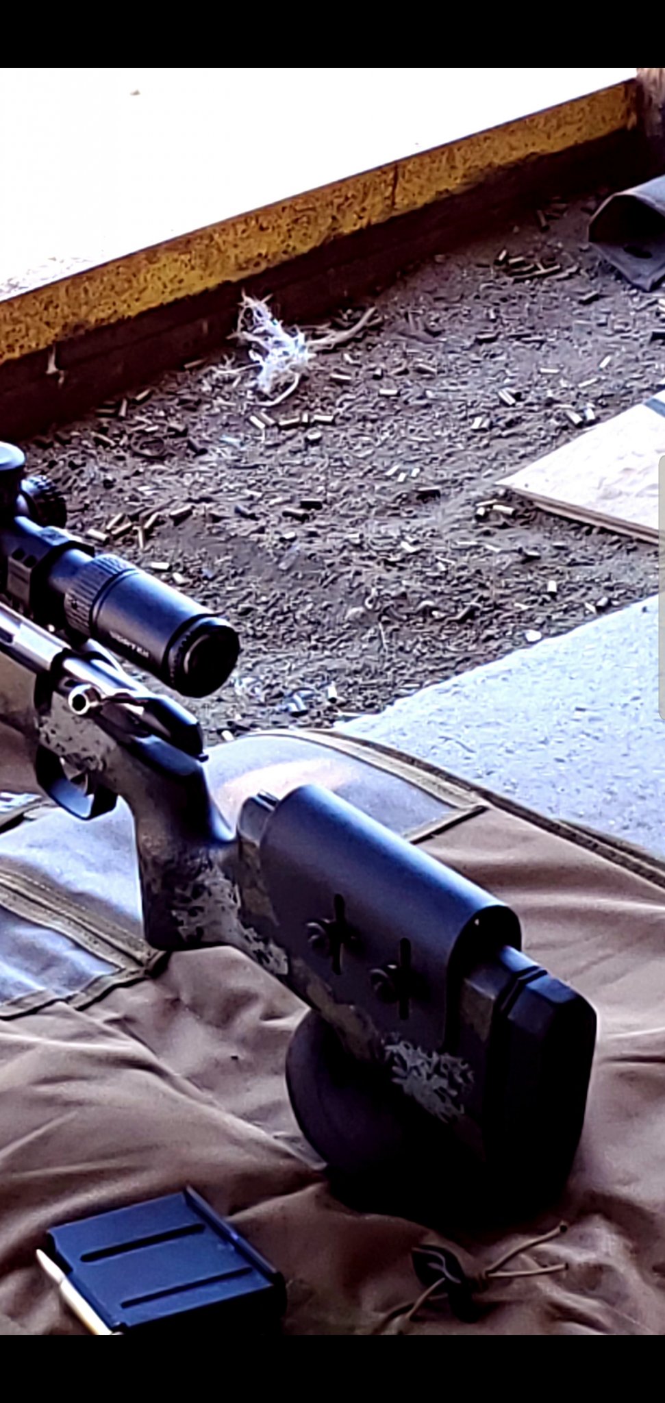

I have a cz457 precision trainer in a manners and looking for someone to install the same adjustable cheek riser system that manners put in the t4a. Thanks

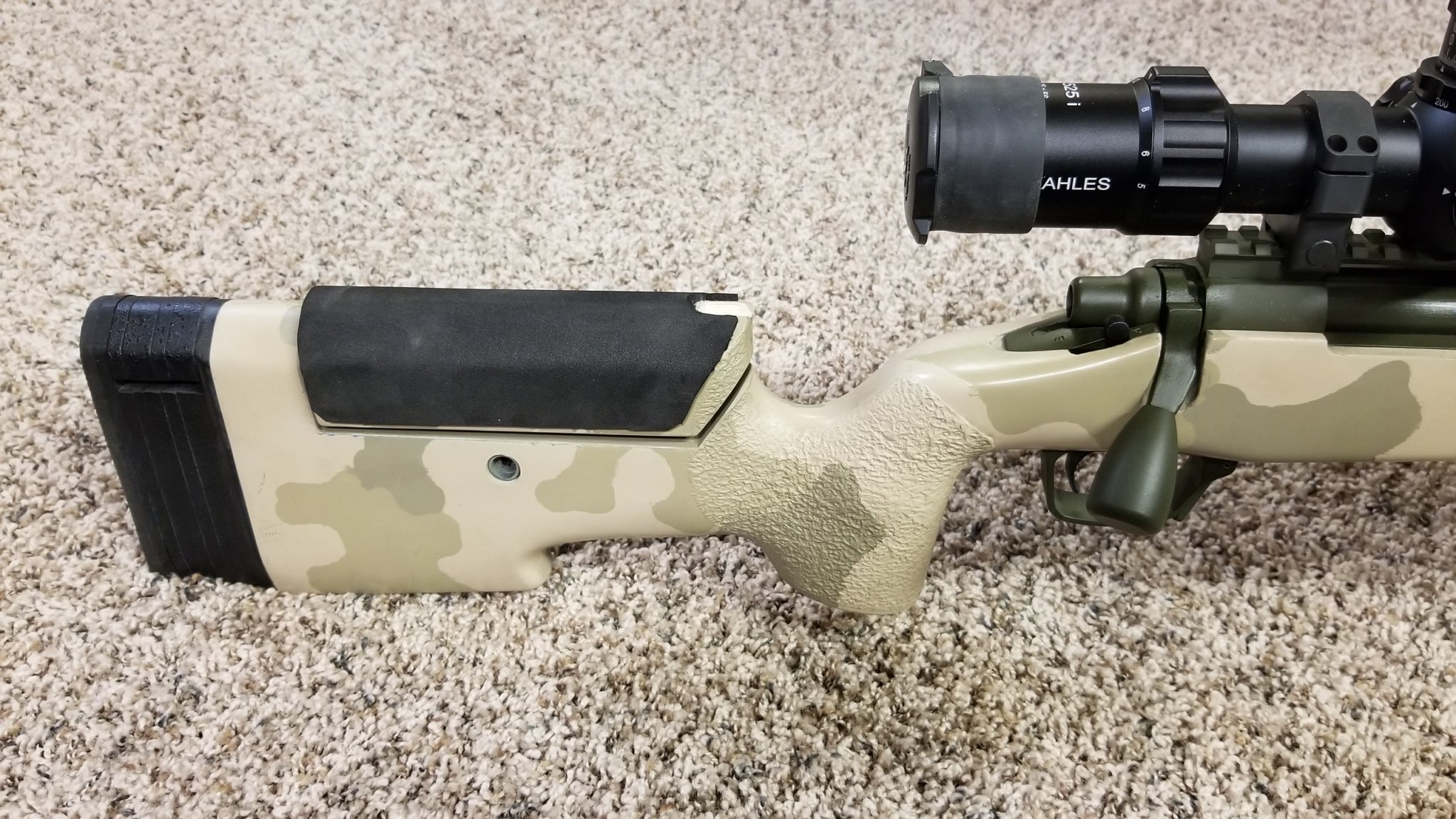

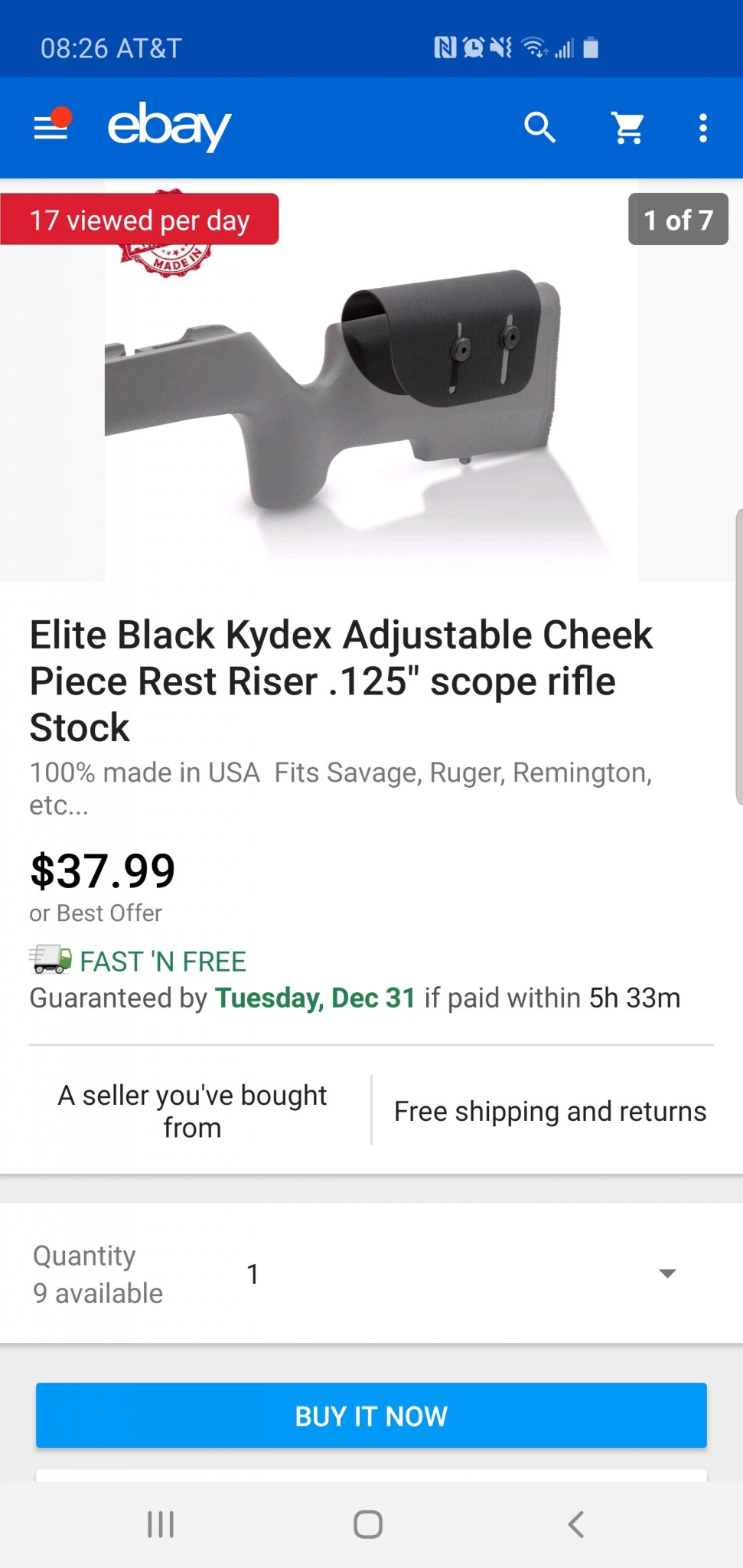

Do it yourself like I did. Nothing like the feeling of drilling holes in a MCS T4!!
.125" kydex riser
Disclaimer: I'm somewhat mechanically inclined and have been dabbling in assorted bubba gunsmiffery for about a decade.

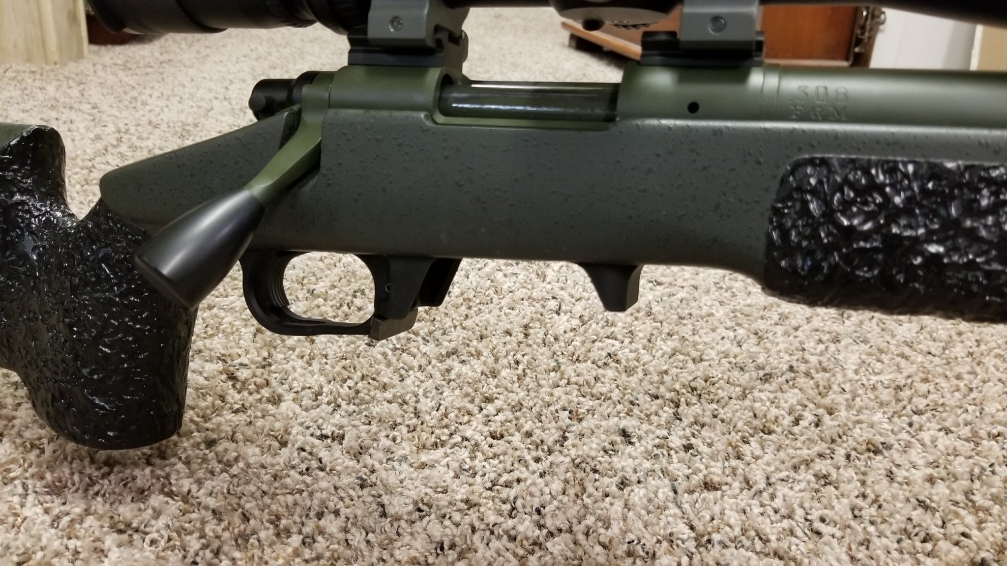

I had Joe Ducos (aka stockdoc) put the KMW Loggerhead (hardware used on the Manners T4a) in my McMillan A5 and fill in the holes from my (not even in the same league) Kydex:

I trusted him with my Tac Ops. Take that for what it's worth.
The saddles are inexpensive and easy to diy but the problem with them is that they add thickness and make you have to turn your head to shoot.
Whereas kmw hardware uses the stock itself and it has approx .5" lateral adjustment, durable materials and height retainer for easy removal/replacement.
Reactions: Terry Cross
I would second the recommendation to go with Joe Ducos and the KMW Loggerhead hardware. I had Joe do the adjustable cheek piece on my Manners T3 stock and he did a great job. I don’t like the bolt on adjustable cheek pieces. They push your eye away from the centerline of the scopeforcing you to tilt your head, they make the stock wider and the bolt on hardware and cheek piece is prone to snagging on your gear.
