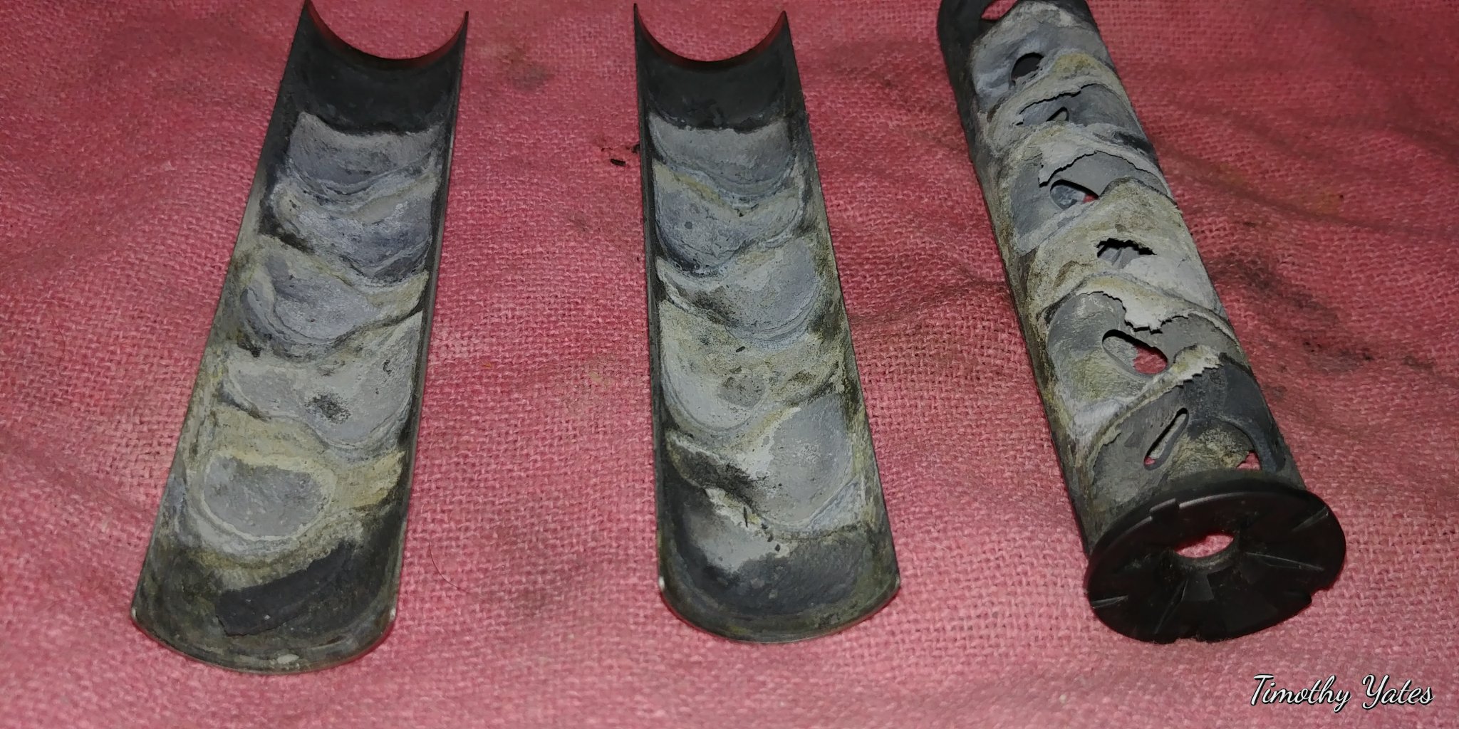

    The other day I was cleaning my Sparrow and thought, "this would make a good topic for those not familiar with or just got their sparrow. I will have a dialog above each photo.

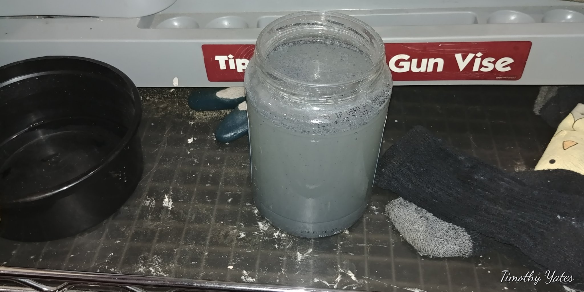

    Here is what your Sparrow will look like if you go several thousand rounds without cleaning. Do not do this, it will be extremely difficult to take apart. Some of the chambers were almost closed together.

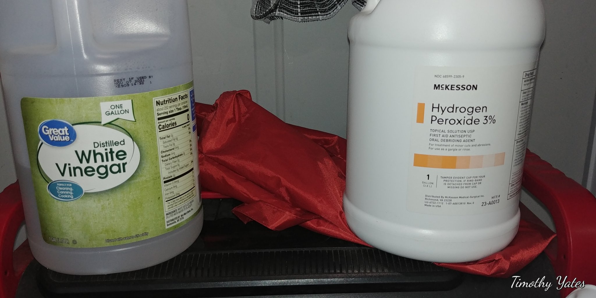

    I suffered a long time before learning about the DIP solution on a YouTube video by accident. This consist of a 50/50 mix of Hydrogen Peroxide and White Vinegar. This solution will melt your skin to the bone, nah I don't know that for sure but I hear it's pretty dangerous. Do what you want but I wear rubber or latex gloves.

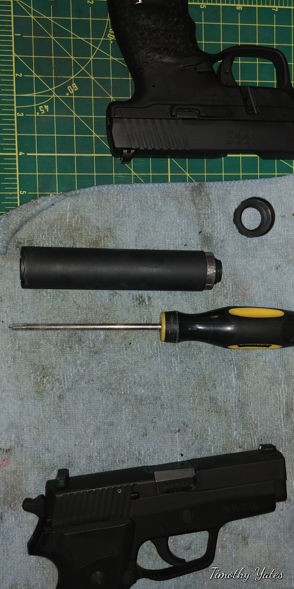

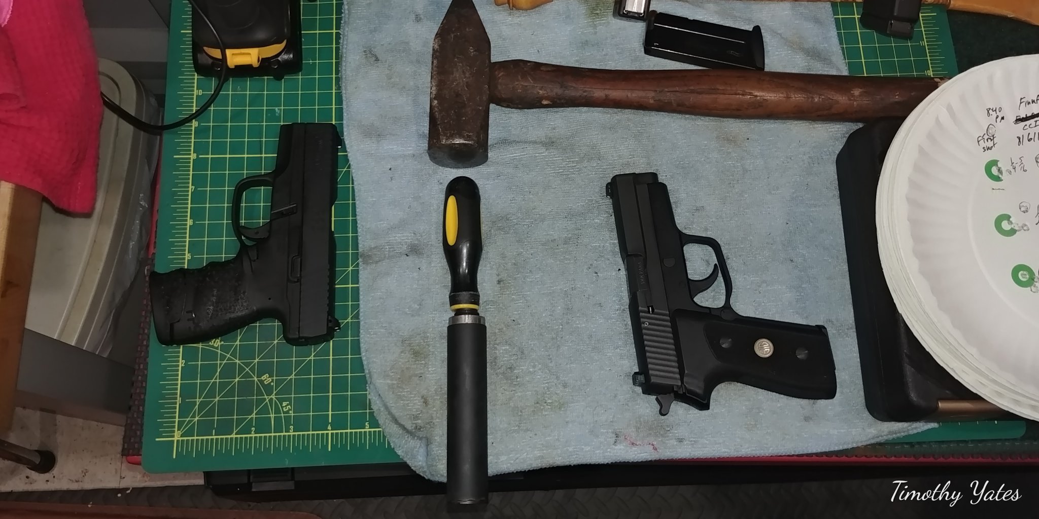

    I save my pickle and olive jars for a one time use for the solution. I put the monolith core and two shields in the solution and let sit overnight. I also remove the o-rings. Do not put anything aluminum in the solution. This is one of the reasons to never buy a suppressor with aluminum baffles or other internal parts that will need cleaning. Here is my last solution after cleaning. You can actually watch the carbon being removed. I let mine sit overnight.

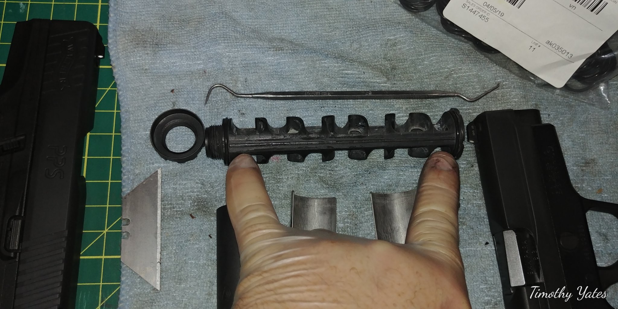

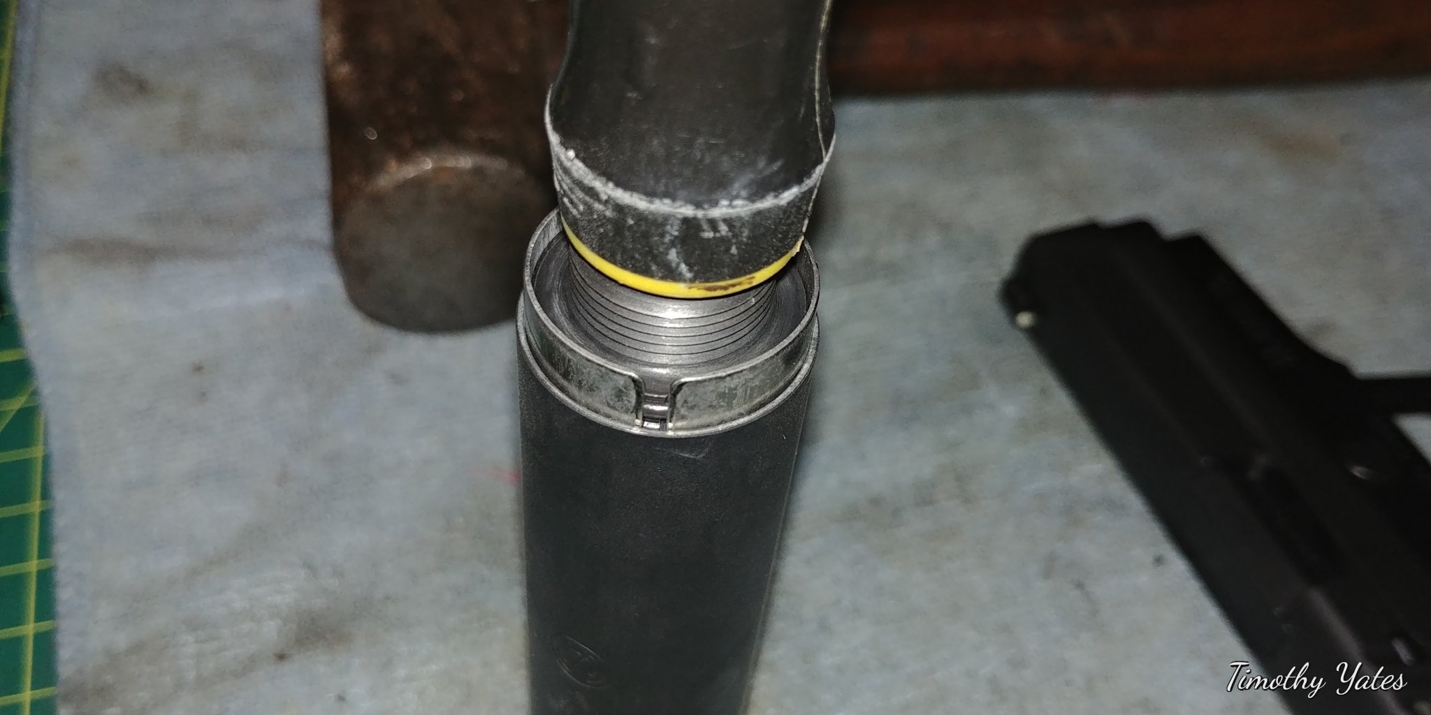

    I have found the best way to remove the core is with a small phillips screwdriver and big hammer. The screw driver keeps everything aligned while the big hammer knocks it through. You would have to be a real Fredo to screw it up. Use what you want, I'm just saying what works best for me.

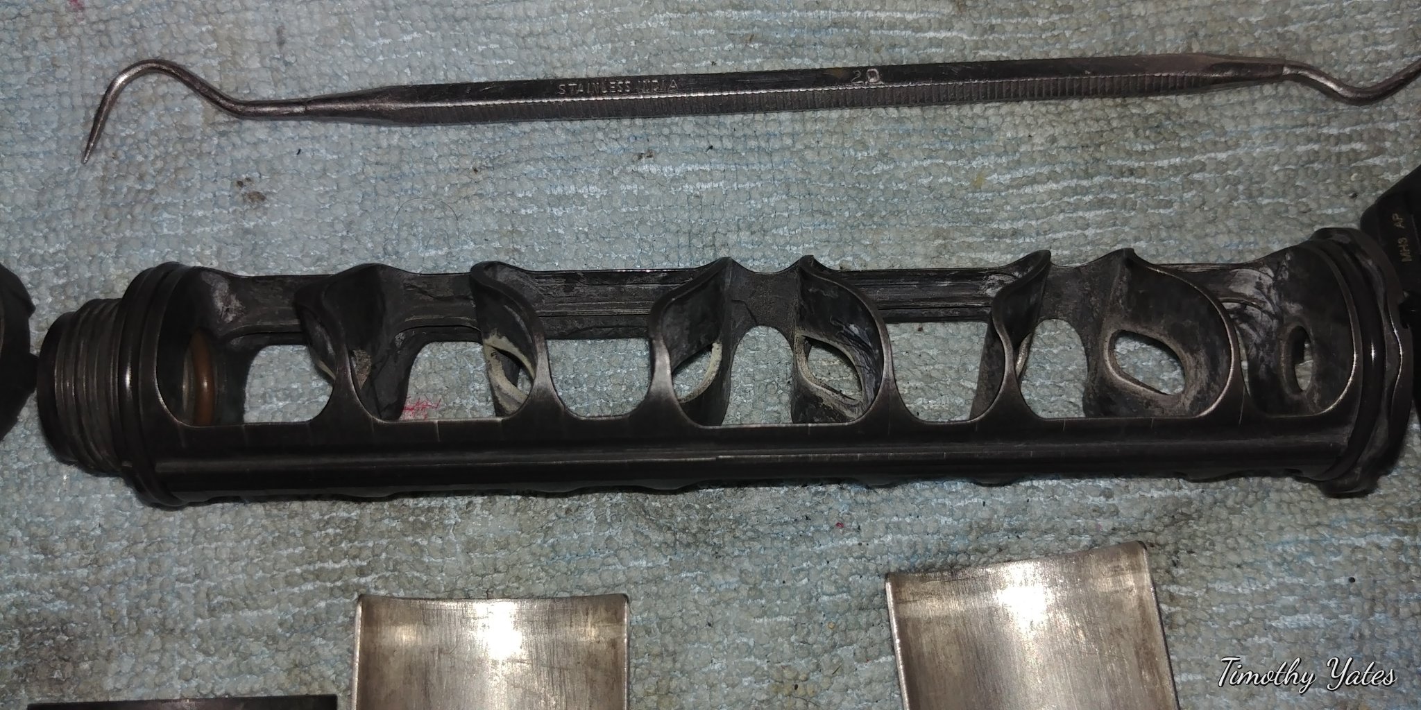

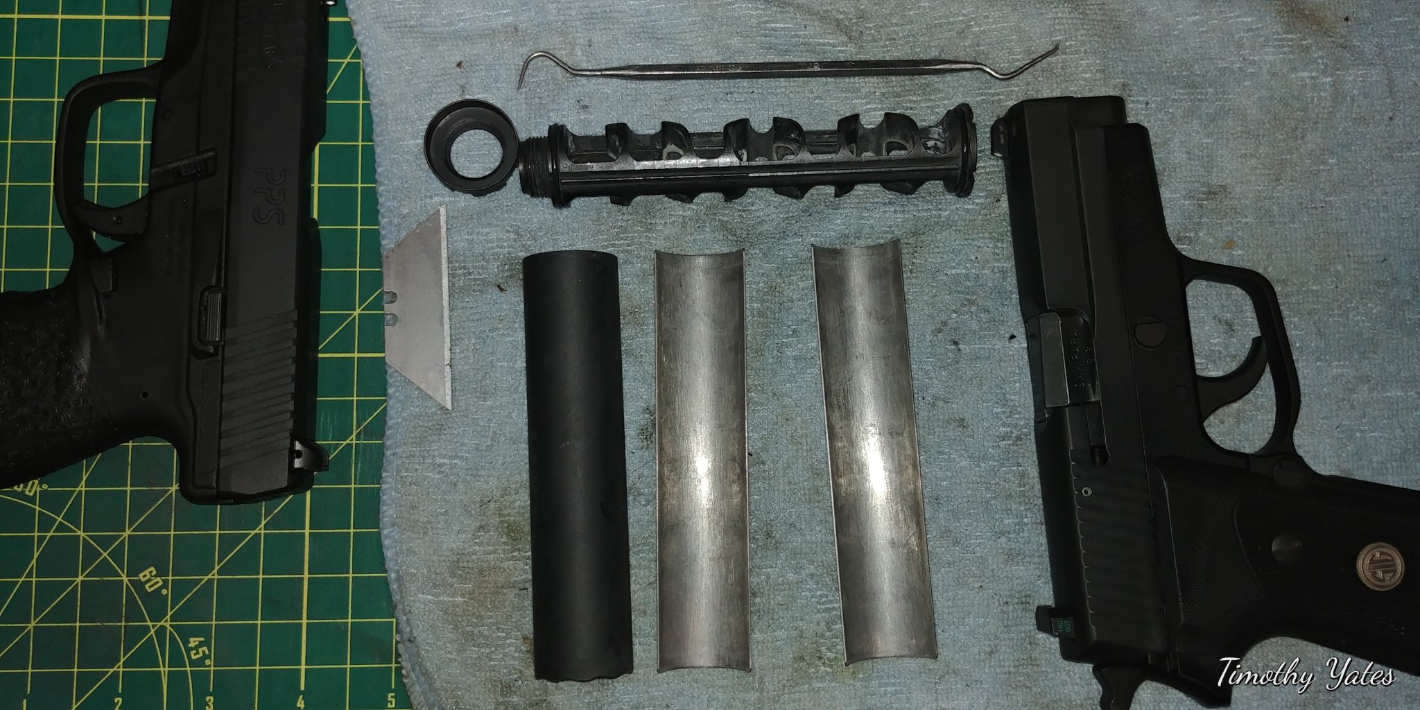

    Here is mine all cleaned up and ready for assembly. Well, as clean as I care to get it. Steel dental picks work great for removing buildup and removing and installing the 0-rings.

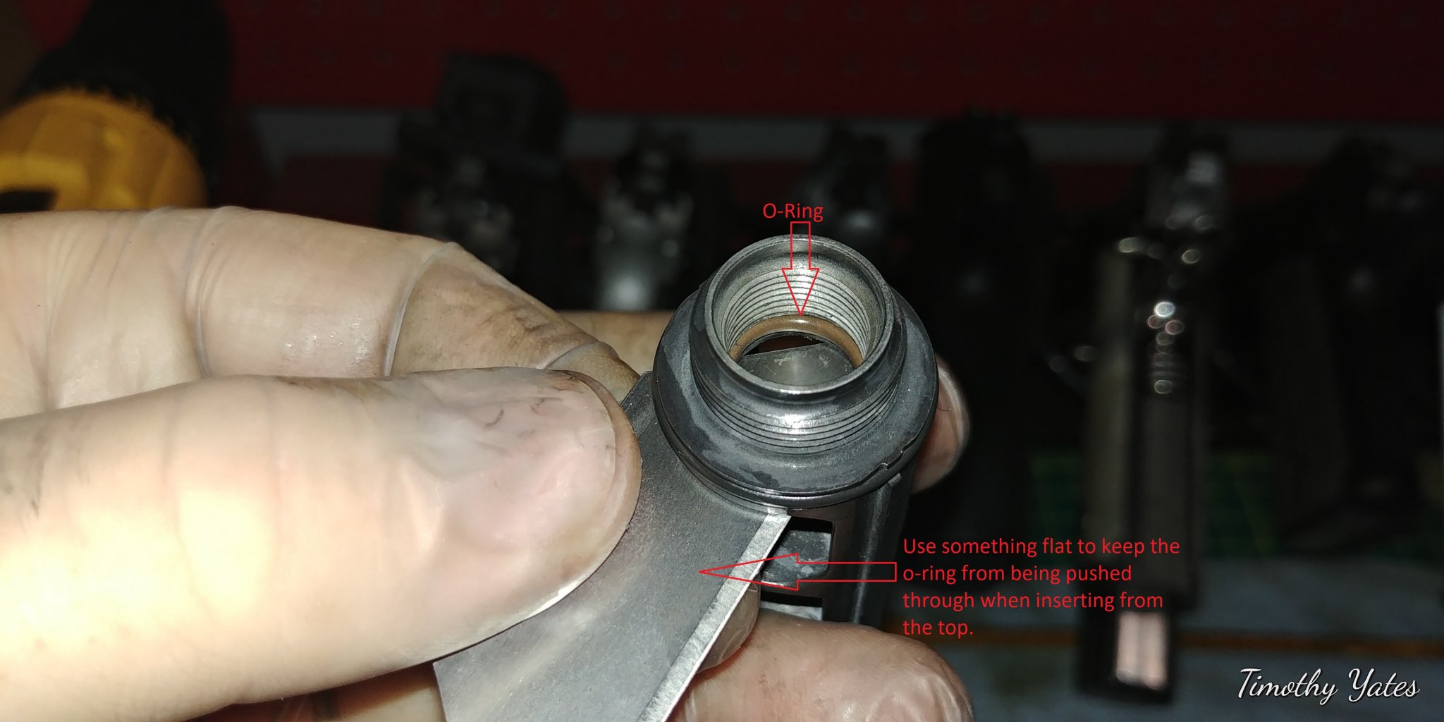

    After everything is cleaned to your satisfaction you will need to install the o-rings. I put new ones in every time. They are easy to install with the dental picks. I use a small amount of oil to help them slide. This may be the most beneficial part of this thread. Here are the o-rings I found that will work. I have used them several times without any problem. Could reuse them I'm sure but why, I have almost a lifetime of them for just a few dollars.
    These two outer ones are easy.
    The inner one is hard to get in unless you use something flat to keep the 0-ring from being pushed through. I use the razor blade this time because it was just there.
    Here is a good view of all three o-rings.

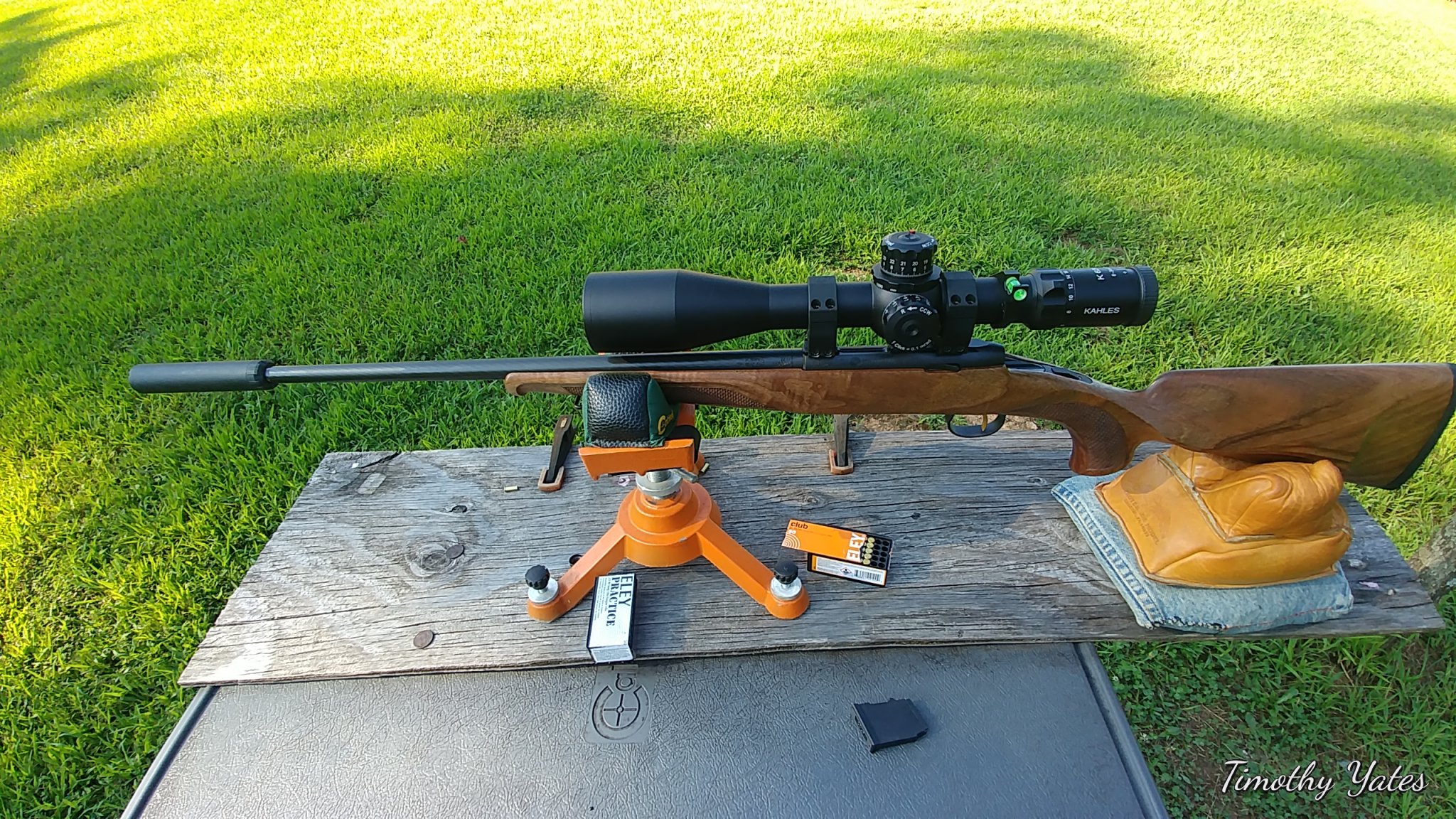

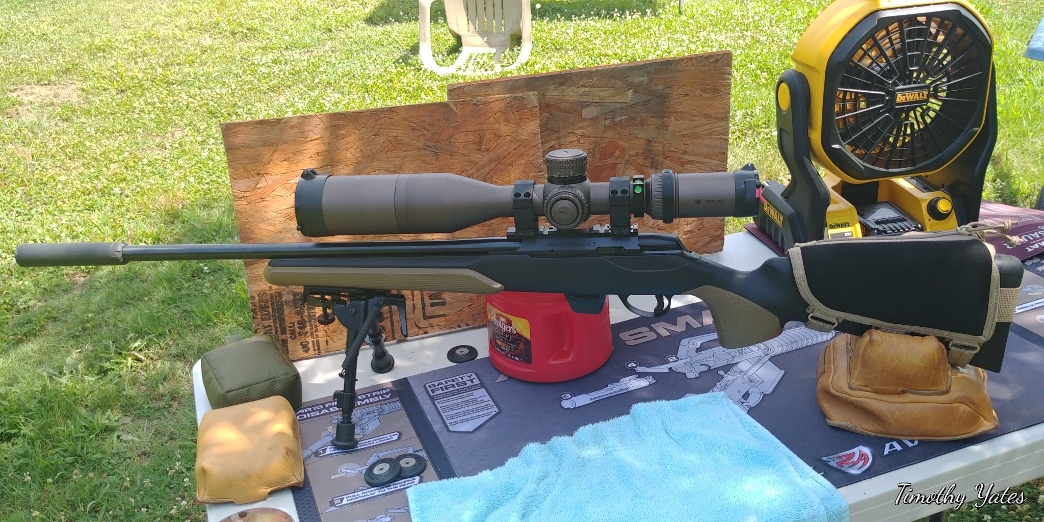

    Sparrow in use.

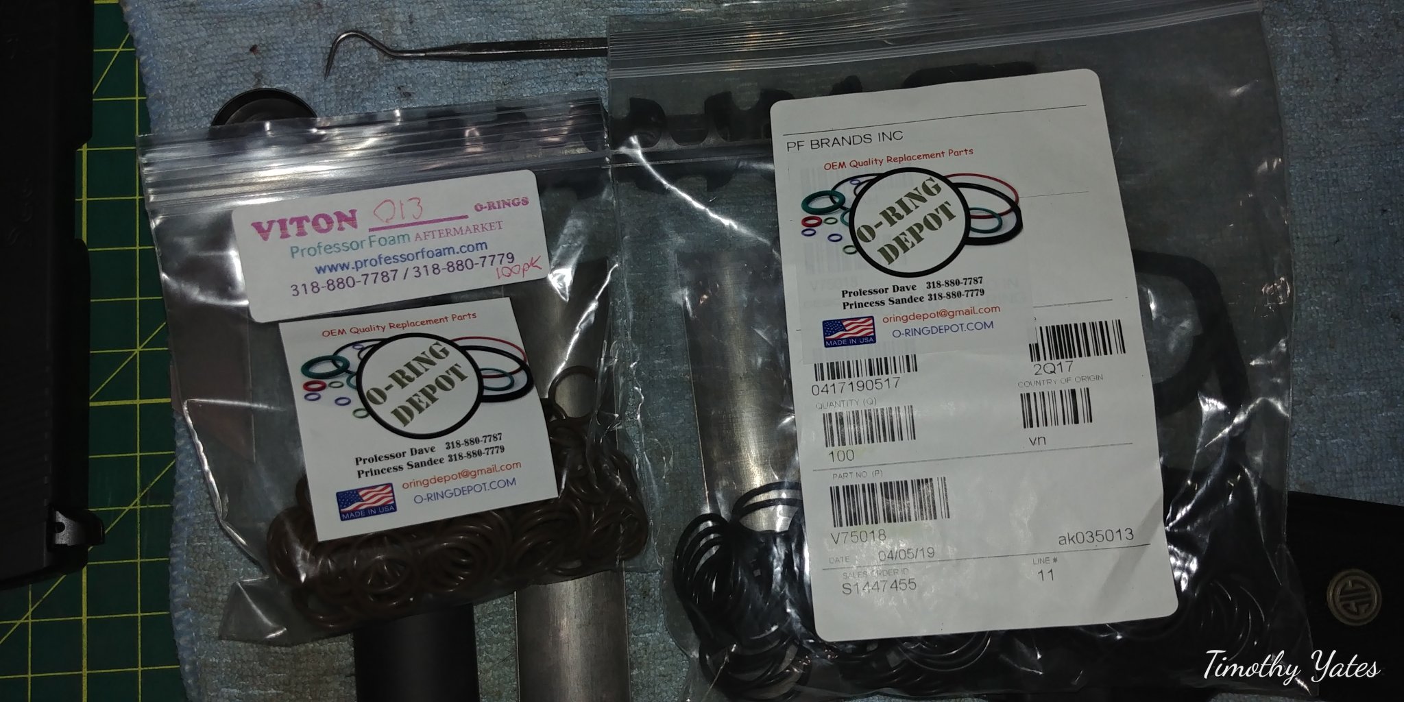

    Thanks for the write up! I never knew where that smaller o-ring was... I removed the larger too and couldn't find the smaller one. It didn't occur to me to look inside and not outside the threading areas...
    I should check my suppressor because I let it soak in that DIP solution with the o-ring inside, and wondering if the o-ring dissolved or if it's still there...
    Looks like I need 1 013 size oring and 1 018 size oring.
    https://www.brownells.com/rifle-par...-adapters/sparrow-o-ring-pack-prod101181.aspx
    Need to find a good place to buy in more bulk / with the right material - it looks like something made of Viton or something...

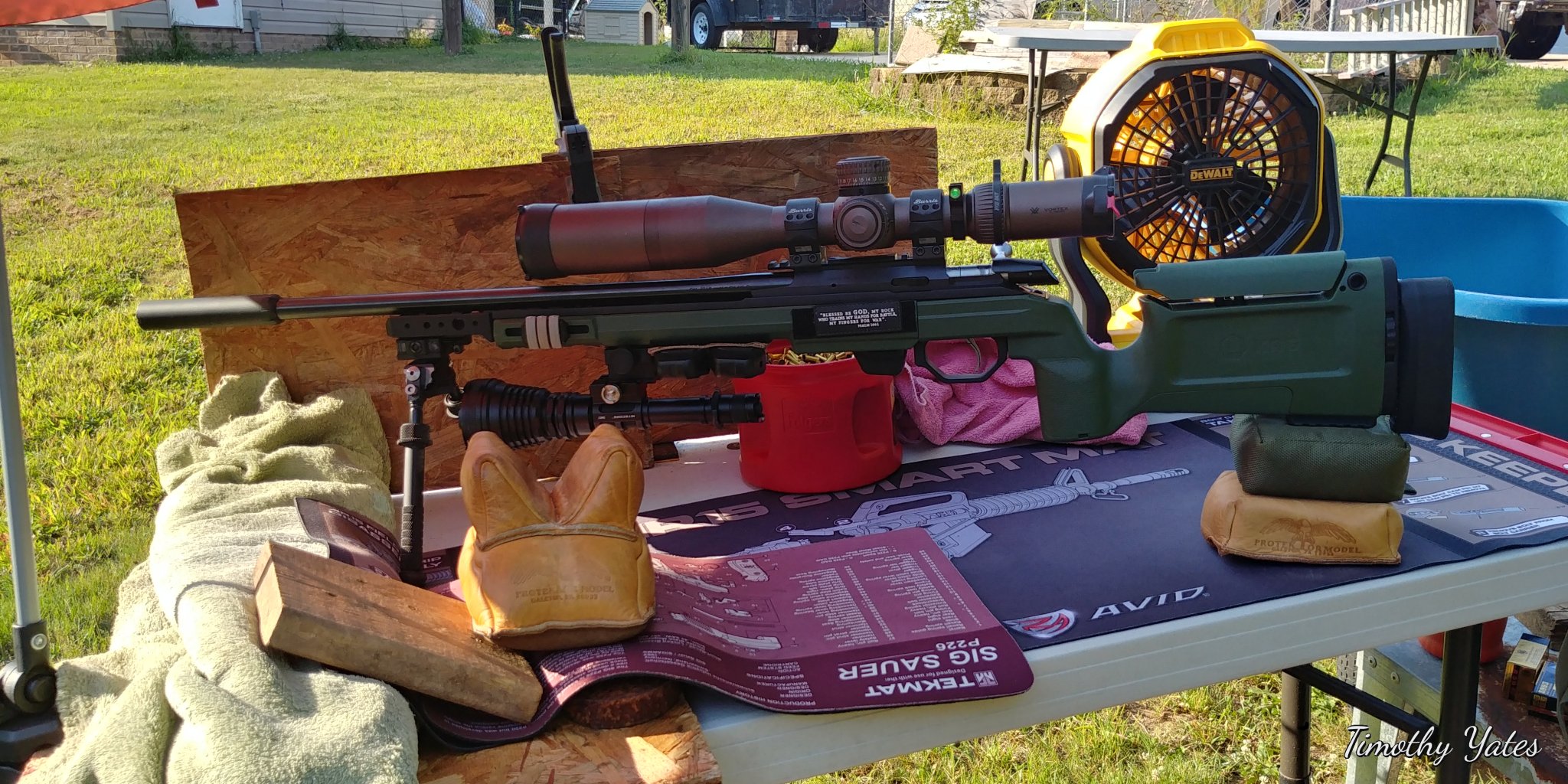

    I've had 2 of them for 4+ years and have shot over 3000 rounds through them several times w/o cleaning, and they never look even 10% that bad.
    I shoot a mix of Fed. bulk and old Remington white box target ammo through my AR22's and Ruger MKIII's on one.
    My other Sparrow I shoot mainly Fed 922A (made by RWS) on my Vudoo V22. It had about 2500 rounds through it and I took it apart a few days ago and just knocked out a few chunks of buildup with a nylon scraper and put it back together. I won't even look at it again for 5000 rounds.
