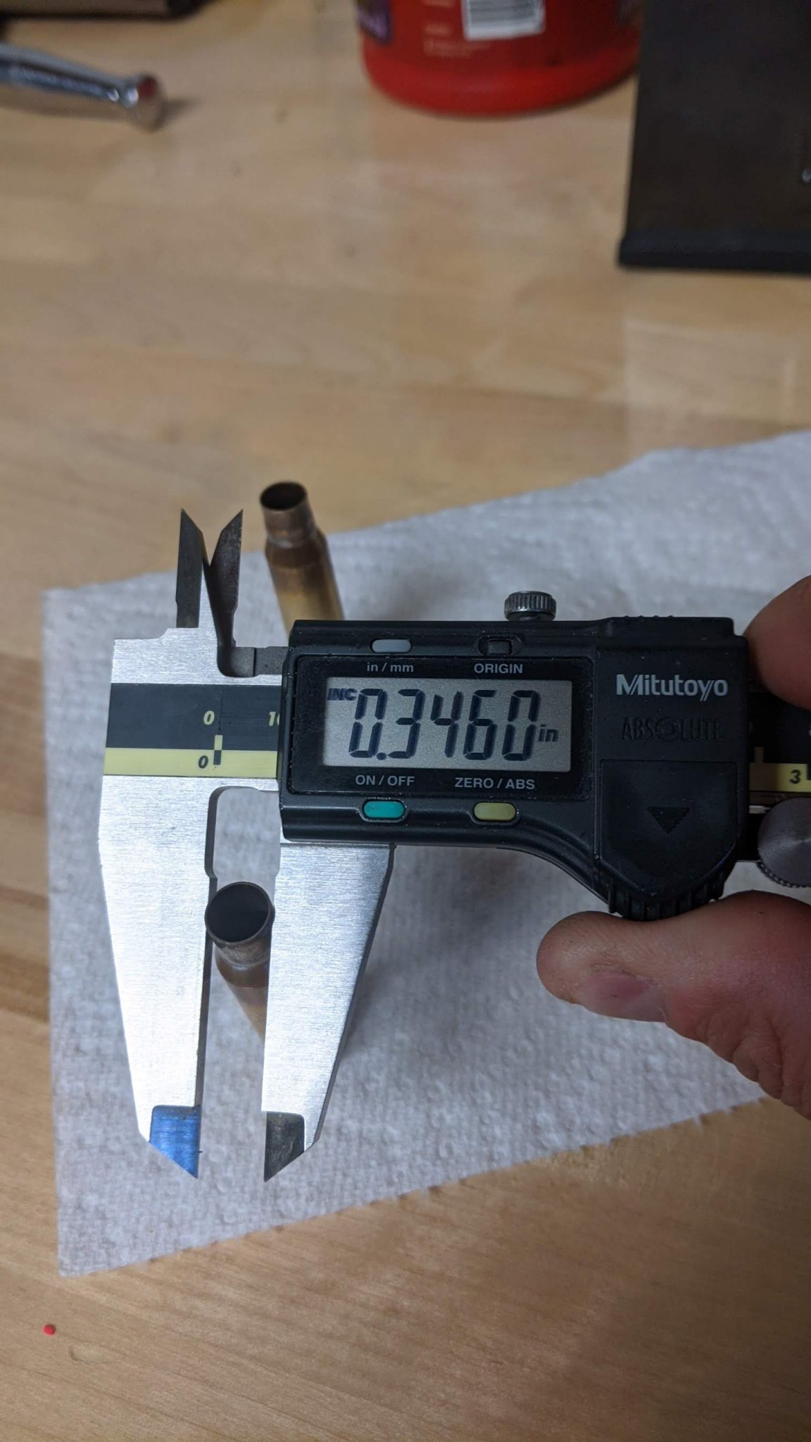

    The fired case necks measure about .346"

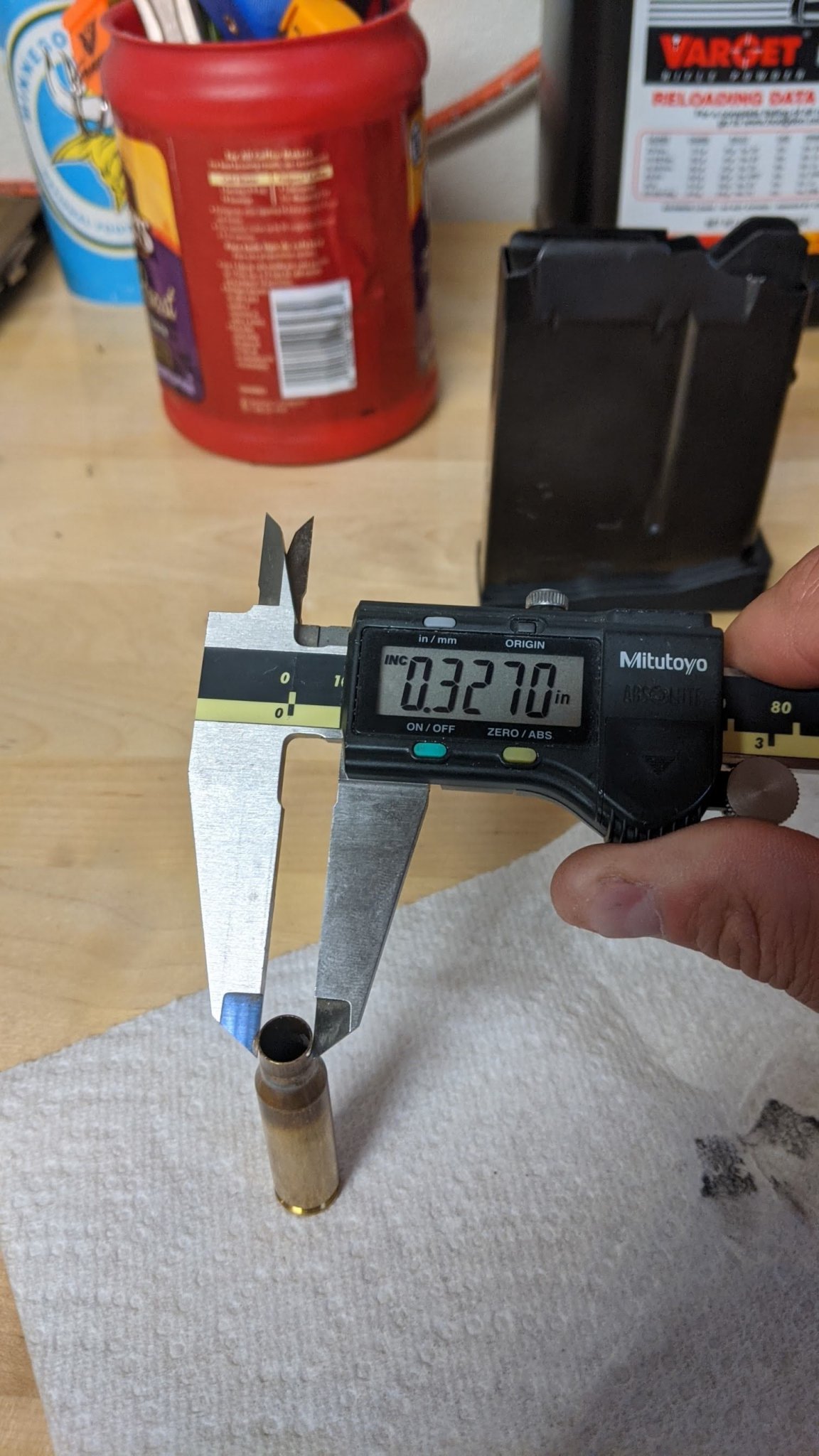

    The portion of neck that I was able to size measures at .327"

    1. Is .346" rather large for a fired 308 case? I was expecting something in the .340-.342" range.

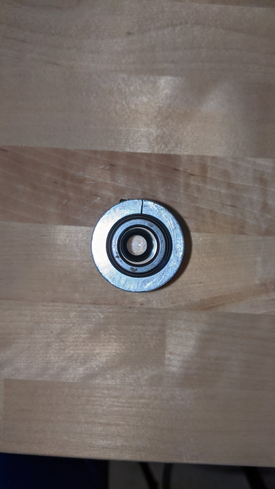

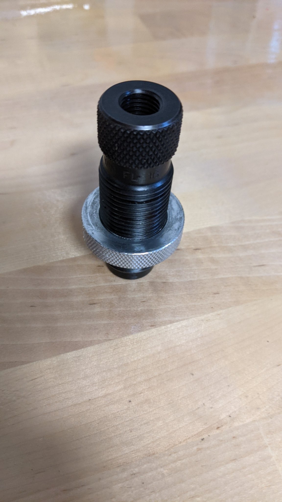

    Picture of die ,please
    Edit : In 2nd picture I see where the neck was wiped with rag.........necks shouldn't be that dirty coming out of die........clean your die and if you're not cleaning case necks before resizing....do so. The suggestion of using imperial wax is spot on . Still would like to see pic. of die.......I have a hunch of what "might " be going on , but I'll keep quite until I can see a picture.
    You need to seat a bullet and see where your necks diameter is after that. I run large rifle lapua brass in my .308 and I am using a .334 bushing for ~.002 neck tension. I have a tight chamber on a custom barrel but I am just over .342 on a fired case. In my eyes, you're definitely sizing the neck down quite a bit and your chamber may be a bit on the large side, but I don't really suspect either of those are your issue.
    The donut is going to be there if you didn't size it all the way so I wouldn't worry about that, hell, I have donuts even when I do full length size with a bushing die - just part of the deal. Take your die apart and clean it up, next I would try using some better lube, I am partial to the imperial lube and foam roller pad spray junk hasn't really gotten me anywhere but stuck. You weren't using one shot, were you?
    After seeing picture , my hunch didn't pan out . ...... was thinking expander ball might have been too high. Imma go with the suggestion that chamber in rifle is on the " large " side of spec........ along with a minimum size for the die....equals a sizing nightmare........But I'd try imperial wax ,if in your shoes and see if it helps..........bet it does

    This! I had this exact same issue with my Remington 5R. Chambers with large throats lead to brass that does not size well with neck sizing bushing.
    I learned this after talking with Redding technicians. They advised not using bushing dies to step down more than 2 or 3 thousands at a time.
    So clean the die to make sure you don’t have brass galling. If you don’t have imperial, use whatever lube on top of the hos. Lube the inside of the die. Run the case partially into the die, pull out, relube the case, go in deeper, pull out, relube, go in all the way. After 2-3 cases your die will be gtg.
