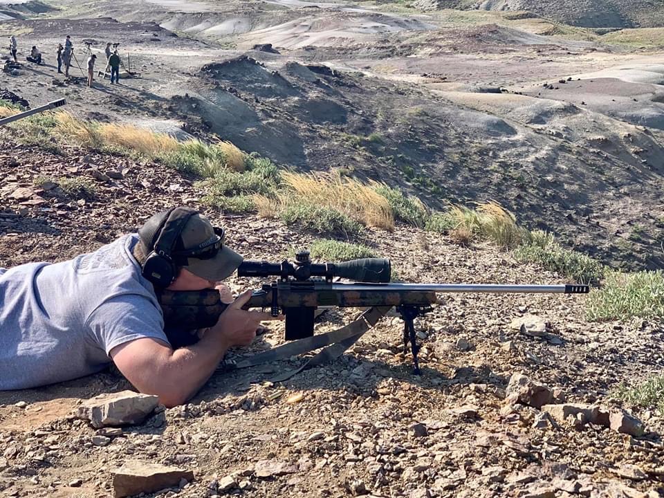

Thanks Scott , Nick , Tad, the Tillard 55 Ranch and everyone else that had a part in the making of the 2020 Nightforce ELR Steel Challenge! To me it's the best matches in the country as far as testing a shooter's wind reading abilities, the rife's capability to perform in dust/dirt and having that rifle tuned, through great reloading practices, to shoot larger capacity cartridges (compared to typical precision rifle (PRS/NRL) matches) over a 75-150 round match. All stages are prone, so for a shooter it's all in the wind calls and fundamentals behind the rifle. With an average target engagement of 1180y and furthest shot of 2091y, if you fail to do something right it shows quickly!
Going into this match I hadn't shot a national level 2 day match since the NF ELR match in 2016, 4 dang years! I have had 2 beautiful daughters and started a business during that span and my time has been focused there rather than driving around the country to rifle matches. I procrastinated getting my 25 SAUM tuned up for this match and ended up switching to ADG brass 2 days before leaving for the match and never had a chance to shoot that load further than 630y. However I still had very high confidence in my load and rifle to perform.
My cartridge choice: The 25 SAUM launching the Blackjack Bullets 131g ACE @ 3280 FPS performed fantastically. 26" Hawkhill custom marksman contour 1:7.5” twist barrel. Surgeon 591 short action, Manners T6a elite, Hawkins bottom metal, Rings and Brake. Kahles k624i scope. This combo came in at 14.1 pounds. Shooting a 14# rifle, the very light recoil is a huge advantage for me to stay in the glass and spot hits/misses and know what I need to do for the next shot as well as not wearing me out physically.
