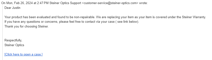

Steiner determined that they need to replace the entire optic. I never would have guessed that it was non-repairable, as it was only about 1/16" of play left to right. Oh well, I'm happy with a new replacement.

Okay I'll wrap this up for anyone in the future looking for Steiner customer service reports. They sent me an email letting me know that my optic was non-repairable and I'd be getting a replacement. I assumed this meant that I'd get a box with a new P4xi in it to directly replace the completely bare P4xi that I sent in. That's not what I received.
After the email, I received another email a few days later with a tracking notification. They next day air'd me a complete and unopened P4xi as if it were taken directly from a store shelf. The paperwork, the throw lever with both size nubs, new battery - all the fixin's. This wasn't expected and completely appreciated as the throw lever that was installed on the P4xi @Burdy let me borrow had the short nub and I really liked that (my original P4xi only had the long nub with it).
