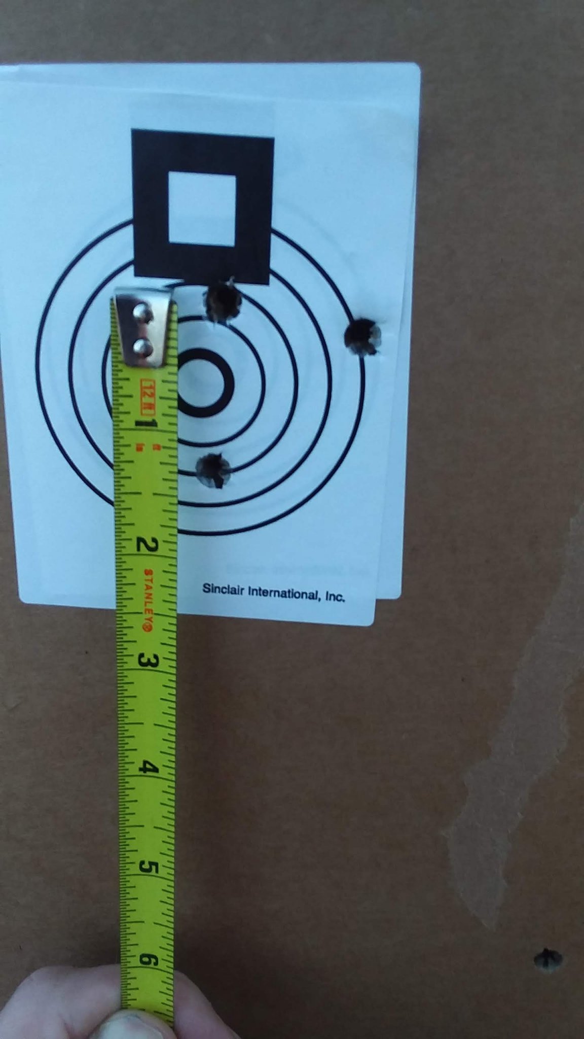

First I shot a little at 100 to see where my point of impact was.
So far so good,

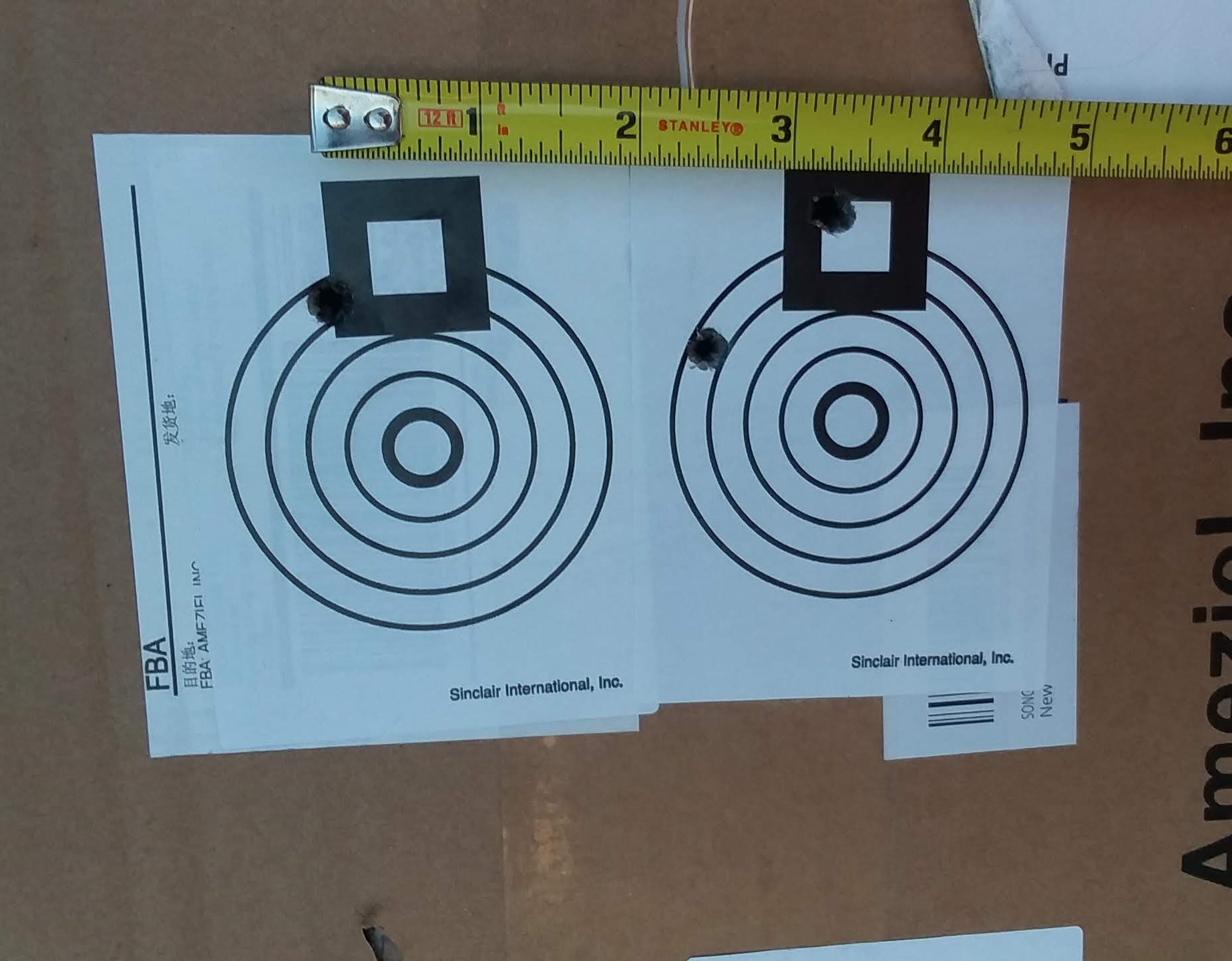

Next stepped out to 304. shot few 3 shot groups, this was average size.
Now im getting a little worried, as this was the average group size. I was getting.

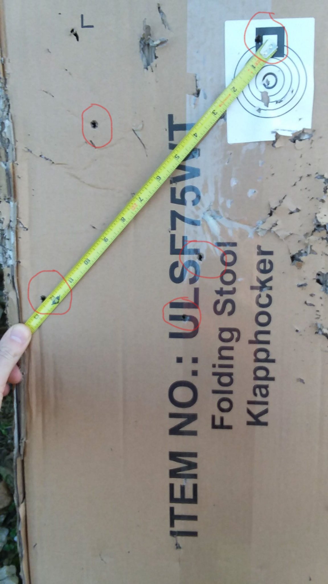

So next I go out to 526, Before I shot paper, I shot at 8" steel and never could hit so switched to cardboard to find where I was hitting.
shot some 5 shot groups. , this was typical,
I this box had some bullet fragments shatter where I sat it over my steel target.
If you full view the pic you can see where I circled in red the holes.
At this point I was really starting to worry that it wasn't the ammo, it was me or the gun. I've never had any ammo in this gun shoot so poorly. So I ran back into the house got my go to ammo FGMM 168smk. dialed back to 304,
looks typical for me and my gun.

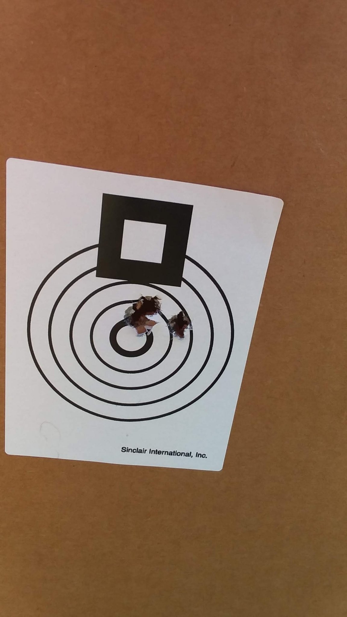

go back to 526, but with 168smk.
this time I'm aiming at the square on the top left
So my gun really doesn't like the 155eld. to bad. OH well.
