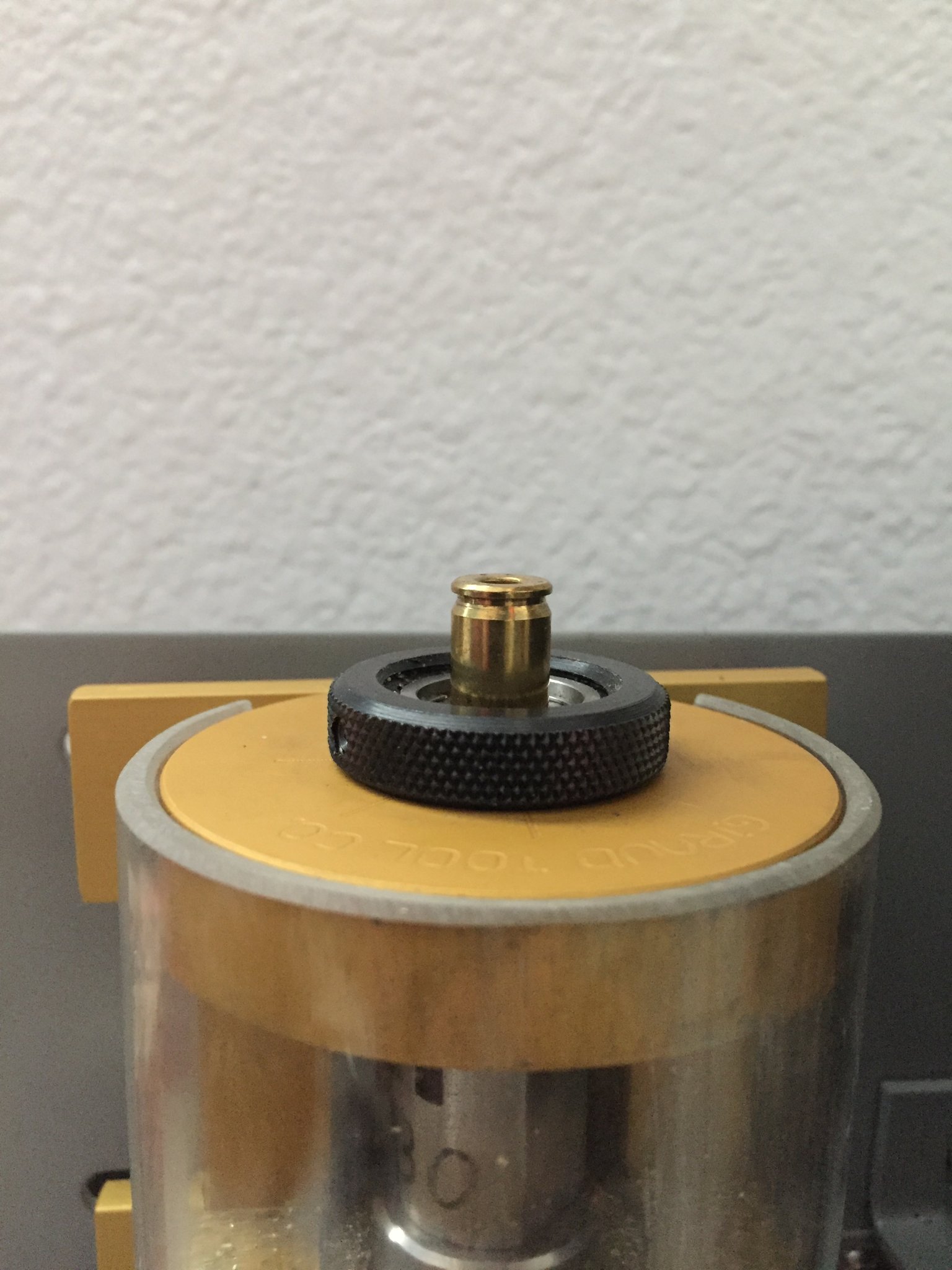

A
300 BLK is really short, and inserts almost fully into the Frankford Arsenal trimmer (nothing sticking out to hang on to). Wondering if the "pocket" into which you insert the case is shallow enough to trim a short cartridge case like 300 BLK.
A 6br is very short as well and I don’t have any issue trimming it on the Giraud, I’m sure the BLK would work just as well.
I mean it’s not long but it works great
