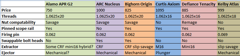

So, my thought about the individual actions.
Alamo APR G2
Pros
  • I like the intro price more than all the others but I only have 5 days to decide on it to do so, pricing ends Jan 15th.
  • Full DLC
Cons
  • There isnt a whole heck of a lot out there on it. Looks like a weird extractor and ejector but the limited pics arent high res enough to actually tell much, what I can tell looks proprietary with no other parts availability
  • No bolt head swaps.
ARC Nucleus
Pros
  • Basically looks like they tried to (and possibly did) make a better mouse trap
  • Non pinned base looks like I can make use of my current action wrench easily
  • Savage barrel compatibility
  • Swappable bolt heads
  • Semi CRF and extractor looks great
Cons
  • The whole bump on close thing
  • the firing pin spring just seems like a fiasco from the outside looking in
  • Everything looks proprietary, nothing on it will match up with parts for anything else from what I can tell.
  • Second most expensive
Bighorn Origin
Pros
  • Looks to be the most widely adaptable
  • Has swappable bolt heads
  • Savage barrel compatible
  • CRF, mechanical ejector
  • 2nd cheapest, tied for 1st after the 15th
  • Tool-less firing pin removal
  • (NOT CAST lol)
Cons
  • Can bind if bolt ran off center
  • Not sure I like the savage extractor system but people dont complain about it on a bighorn unlike savages so maybe not really a con
Curtis Axiom
Pros
  • Supposedly runs slicker than goose shit and cant be bound. Keystone liked that
  • I like the shiny action
  • m16 extractor
Cons
  • No barrel nut compatibility, has to be cut specifically for the axiom so I cant do it myself in the future
  • Just not as frequently seen, makes me question why not, what dont I know about it
  • No swappable bolt head
  • I remember people complaining about mags putting pressure on the bolt and not cycling. Thats how my rem700 is but hey, maybe some of the others arent like that?
  • Plunger ejector but not a huge issue that Ive seen too many complains about.
  • Most expensive
Defiance Tenacity
Pros
  • Remington threads, I can move my 6xc barrel onto it and then make my old rifle a carbon fiber 243ai hot rod hunting rifle. Speed has been calling me. Sharing barrels with what I already have isnt a bad thing
  • For some reason defiance just appeals to me. Maybe because its closest to what I already have
Cons
  • I like the polished look a whole lot but the tenacity thread shows pictures of them looking like cast potmetal and not the polishedlook I love aside from an example of one who claims that he has the only one like that in existence.
Kelbys Atlas
Pros
  • Trigger hanger, seems nifty
  • Kelbys has just always screamed accuracy to me so I wouldnt mind getting in on that lol
  • On sale for 895 for a bit, that 100 bucks saving can get a rear entry wrench
Cons
  • No savage/remage barrel compatibility
  • Same savage style slip extractor like the bighorns...
  • Larger firing pin but still not quite a large pin
Sooo thats where Im at. What would yall do?

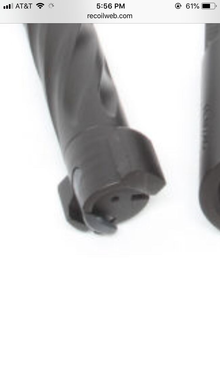

@spife7980 why do you state that the Nucleus is a semi-CRF? (I'm just wondering what the differences would be)

The only thing I can think of that's proprietary on it would be the bolt knob (The origin is similar too.) However, I really like the weird bolt knob. Other than that, it's a 700 footprint with a 700 trigger setup, and takes Savage small shank barrels, I don't really need anything other than that.
You’re right. It’s still a crf. It’s really just a call back to the nucleus threads where it wasn’t fully captured as soon as it rode up, kind of an obscure reference but I just kind of made it a note in my head. Haven’t really heard anything about the other crfs having the same thing discussed so just a mental note of what I’ve read.
